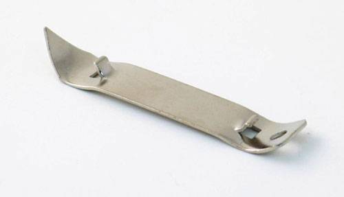

No, like I said "drip rail trim". Flat end only, like opening a bottle. Tab under the lower edge, wide flat end up. GENTLY lift a bit at a time as you work your way down the trim piece. You need the correct tool, or make one, to do the window trim to get the clips to release.
I modified a carpet knife to work okay, but if you've never done it before I'd suggest finding the correct tool.

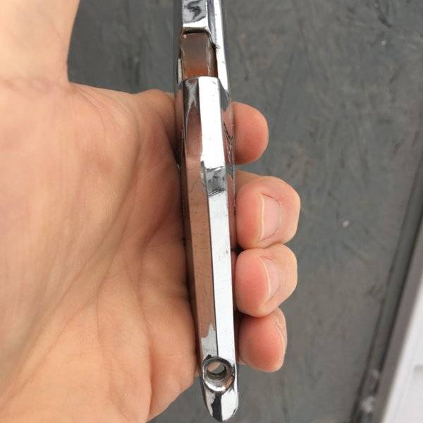

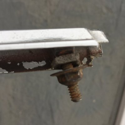

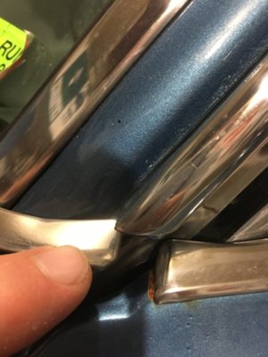

Peak trim removal requires careful force. Makes me wince every time as it isn’t available through reproduction. Hard to find good used ones. It runs along the fender, door, quarter panel. It’s anodized aluminum, so it has a bit of flex/give to it. I’ll try to find a picture of one removed, as there is a clip that snaps on the pinch weld and the mold snaps to that. Also an anchor bolt at the end. You need to access that through the door after the panel is removed.

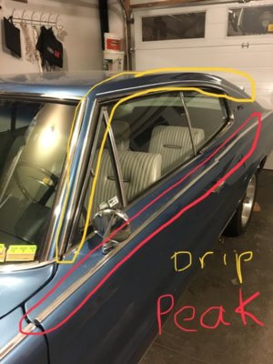

Hey all, thanks for all the helpful information, firstly I'm not really experienced at all, all the work I've done on my day to day driver has been done with the help of YouTube and the Haynes repair manual. Secondly I do have a few people I can talk to for help which is good and I did pick up a repair manual for the 67, pretty sure it's a reprint and not sure if if it says how to remove trim in it. Thirdly I know I'm going to reveal the depth of my ignorence but I'm not clear on the terminology, what exactly are the drip rails and what is peak trim?

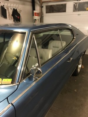

Driprail: runs over the side windows on the outside of the car. Looking down the length is shaped like a “c”. These are stainless steel.
Peak mold: goes along the fender, door, quarter panel. Note that the fender is the front side piece, quarter panel is rear sides of the car. These are anodized aluminum. Except for the fender spears, which are chromed pot metal. Be extra careful with those. Best way to remove is to take off front tire, remove splash shields, spray Rust Check on any bolts. Let soak for a while.

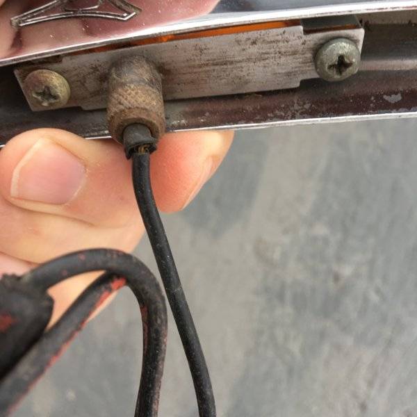

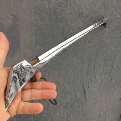

Fender spears: one year only part. you can find some reproduction ones. Used are hard to find. Originals often have broken front screw holes, have residual paint from a “mask and paint” repaint, wires and connections often broken, loose or rusty. Underneath is a speedinut, stock also had a rubber gasket of sorts. Lenses often sun faded.
Cleaning etc. is a whole other topic, but don’t use ANY abrasive on chrome. Peak mold has a similar bolt on the ends of each piece, but clips in between.

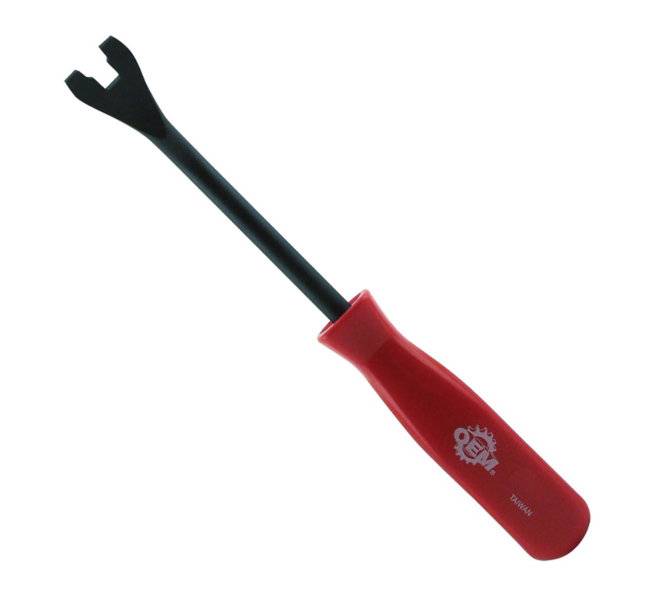

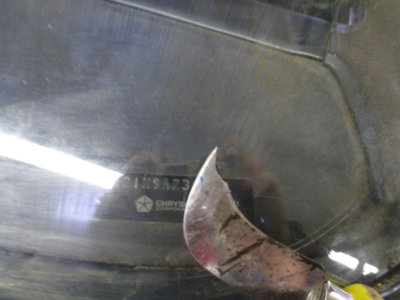

here is the style of glass trim tool we use at the shop. most parts stores should have them.
pop off the corner trim pieces then move to the strips
one thing is on the windshield and rear glass the lower trim will be full of dirt and crap.
Top and sides will come up pretty easy.
the bottom will need washed out and blown out with air so you can get a decent bite on the clips.
Starting on one end slide the hook under the trim and work it along until you feel the clip.
give the handle a light twist and the trim should pop up.
then move on to the next clip.
Release each clip. do not try to pull or push the trim off it will kink because of the curved shape.
