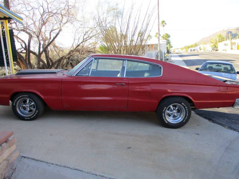

So I lucked out, the car got here safe and sound it turns out that the only trim still on the car is around the tail lights, windshield and driver and passenger windows. Now it looks like the clips that hold the drip rails on rear third of the car are still attached. Also I've tried going through the service manual and parts catalogue and can't seem to find a list or anything on all of the exterior trim; I was hoping to find a list so I could go through all the trim that came with the car so I can organize it and see what pieces I need to get. If any one can tell me a page number for the service manual, parts catalogue, or if someone could show me some pictures that shows all the trim that should be there I would greatly appreciate it.

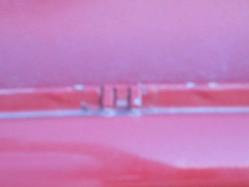

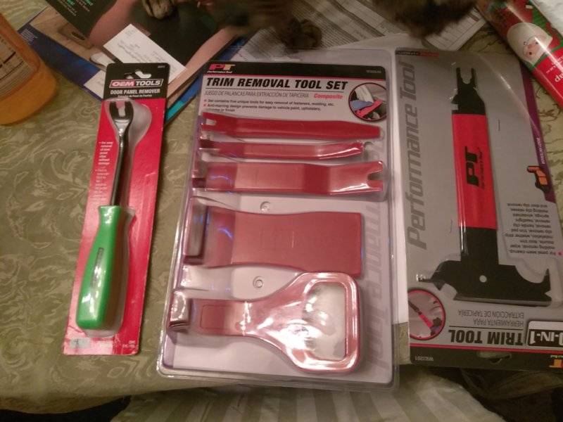

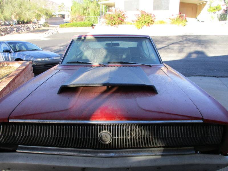

Also here's some pics of the car and the tools I picked up to remove the trim, and the the clips that are still attached to it.

I hope I don't sound obstinate, but this is the first time restoring a car for me and I want to make sure I do it right. As for Onlyone, my reasoning for taking all the trim off was that since I'm taking the paint off down to bare metal I don't want to ruin the trim with the sander, and by taking it down to bare metal I can see if there is any damage that needs to be fixed. Also pretty much all the trim is going to need to get polished or re chromed so I might as well take it off now. For the front windshield I'm going to have to take the trim off because I'm going to have to take the dash out so I can get the switches and everything checked. Again thanks for everyone's help and advice.
