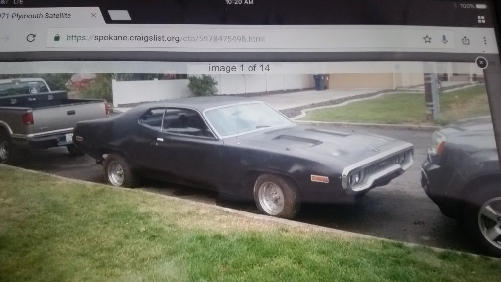

Hello, I just joined this site and thought I should introduce myself. My name is Dakota and I just recently purchased a '71 Satellite. I'm having an issue with the starter. I replaced the broken ignition switch with a new one and the car starts with the key now. However when I hooked up the battery I notice that the starter bendix gear engages the flex plate and causes the battery to go dead. Any ideas on what the problem may be is appreciated.
Someone also added a painless wiring solenoid on the wheel well that I would like to remove. Not sure why this was added, so any info on that is appreciated.
Here's a picture of it
Welcome nice looking satty .your in the welcome wagon so your probably not going to get your ? Answered go to general discussion or elc or motor or

Welcome. Always had a soft-spot for fuselage-body satellites. Best of luck on the starter. I agree with above. Remove aftermarket stuff and replace with original. Will be easier to diagnose then even if it's still not working correctly.
