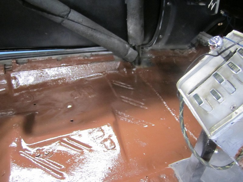

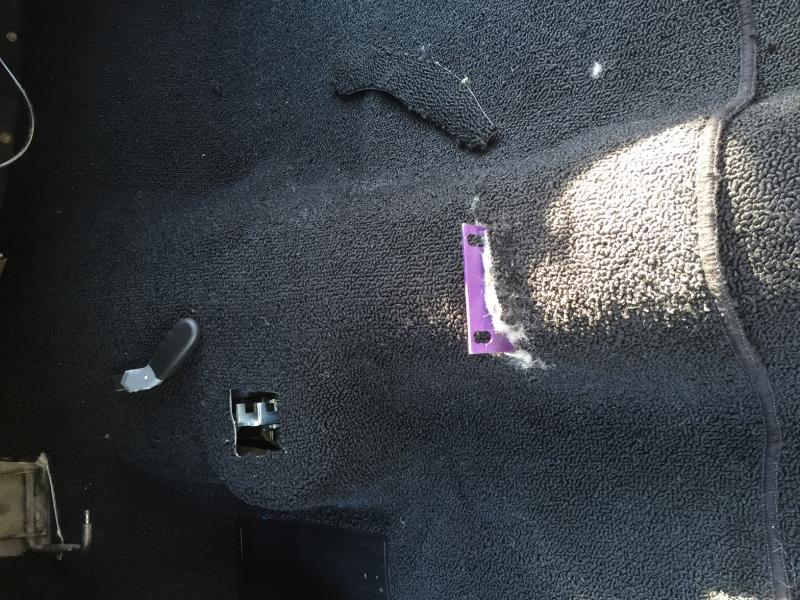

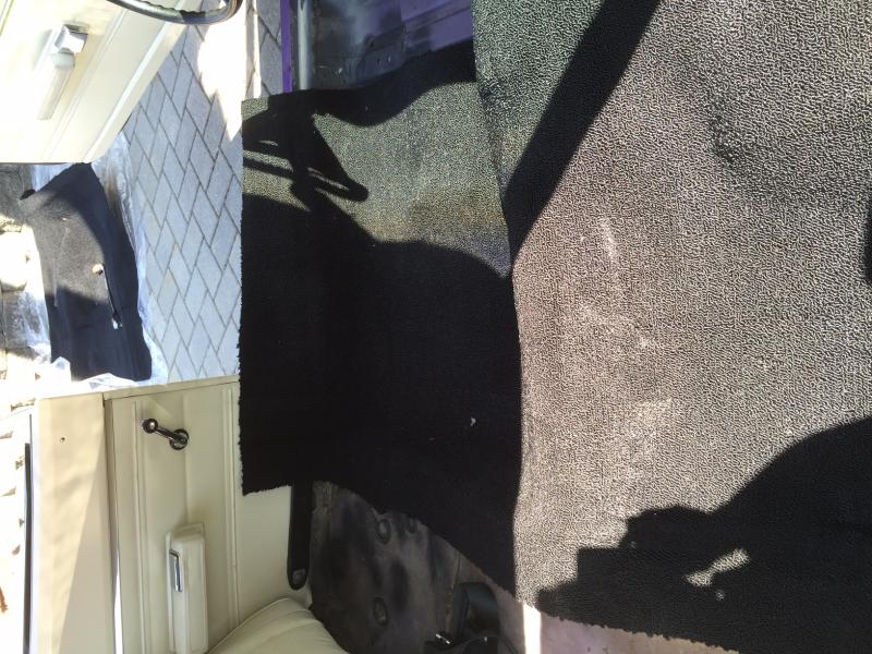

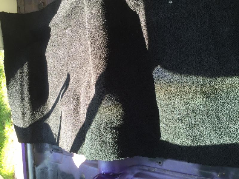

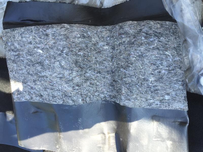

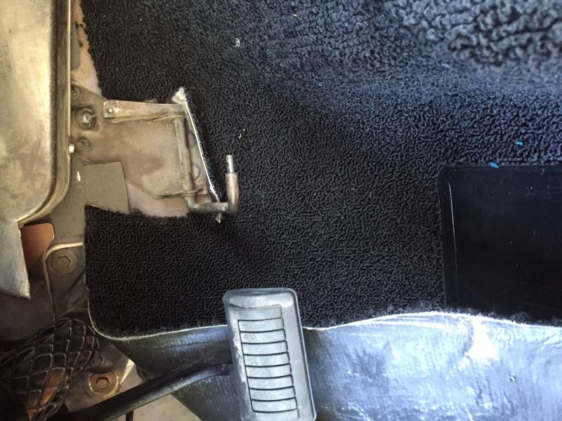

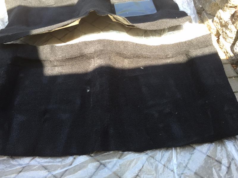

Hi guys- Here's some pics of my carpet install today. I used an ACC carpet with the mass backing. It is a very thick rubber backing bonded to the carpet and then it is form fitted to the floor pan. The quality was excellent. The backing was solid on the carpet and the fit was almost perfect to the floor pan. It was folded in the box and I was a little nervous about the form fit being ruined. I unfolded both sections and left them out in the driveway while I started removing the bucket seats, back seat bottom and shifter handle (seatbelts were already out). By that time, the carpets actually reformed into the shape of the floor pans. I started with the back section. As you can see in the pic, they leave a lot of extra on the edges that has to be trimmed. I used a double edged carpet knife, much better than a utility knife (no point to gouge the paint in the floor). I trimmed three times to get a nice fit up against the sill plates. The front was a lot harder. The extra carpet from under the dash, up against the firewall made it hard to get the carpet molded to the 4 speed hump in place. I had to slit sections, move the carpet up and to the side till i finally got the hump in place, then i slit it for the buddy seat bracket. Trimming under the dash was then not too bad. I used some of the felt insulation from the old carpet under the rear seat, as the carpet doesn't go more than 4" under. I figure it couldn't hurt. I got to reinstall the rear seat but didn't have time for the bucket seats, buddy seat, shifter bezel/boot, gas pedal and seat belts. Any suggestions on how to make the holes in the carpet for the seats to bolt thru? A drill will get twisted up in the carpet fibers.

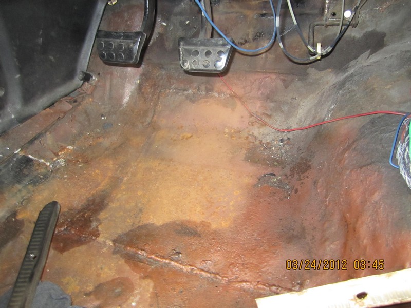

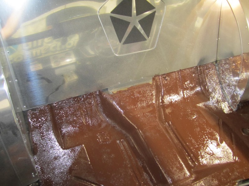

Before I did the install, I cleaned up and vacuumed the floor pan. There was some minor surface rust when I pulled up the old carpet so I used a fine wire brush to remove it and then used some Rustoleum rust reformer primer as a prevention from any continued rusting. I also ran speaker wires to the trunk for a planned hidden stereo upgrade down the road.
All in all, I'm real happy. I think the heavy rubber mass backing will give me good sound and heat insulation plus it will prevent any water getting to the floor pan thru the carpet. If it does, it is easy enough to pull up the carpet as opposed to a dynomat type insulation which is glued to the floorpan. I'll post pics of the finished product when everything else is installed.

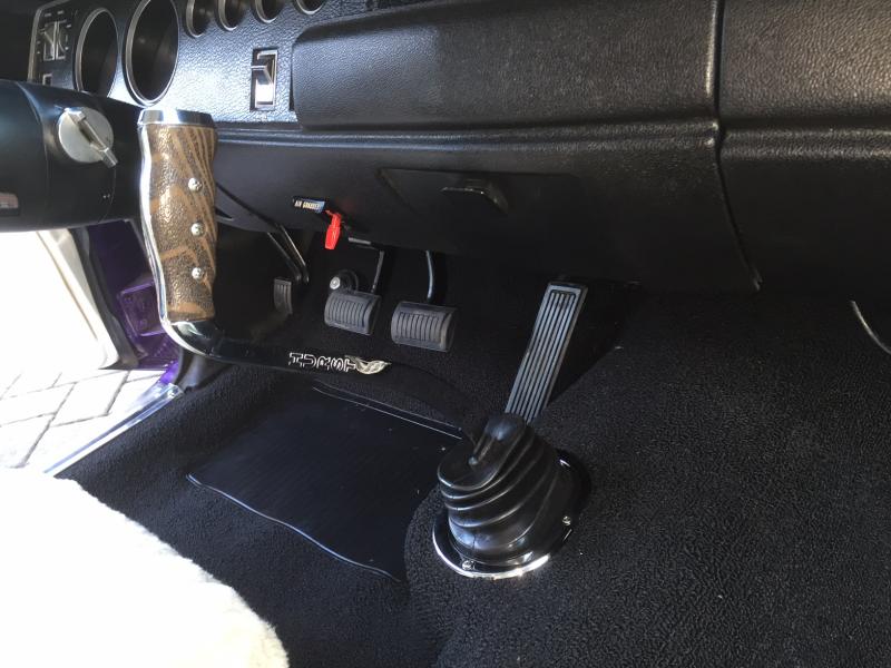

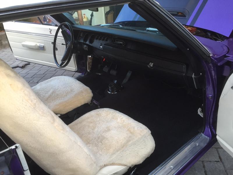

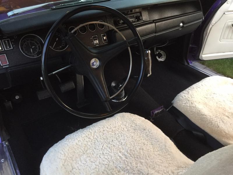

Finished installing the carpet and interior yesterday, except for the buddy seat which is getting a new cover installed as soon as it gets here. I love the look of the buckets with the shifter. very clean. I'm glad I didn't keep the console in there. Here's a few more pics.
PS- Those sheepskin seatcovers are great. No sweating on the vinyl in 90degree plus days !!!!!
Boy that job looks familiar!! Yours looks GREAT! I have that 3rd pedal,,,,,,but it just helps hold the carpet down.

To make the seat belt holes you could heat up a metal rod and melt it through the carpet. The heat will seal any loose material.
NJRR, Your seats do look good in there with the shifter, i think i would miss the console, i like the room to set a bottle, can or coffee on it, but of course, it always ends up spilling a little on the console! LoL
Ron- I'm putting in a buddy seat (you can see the brackets sticking up through the carpet). I like having an armrest and the console was just too low. Also, I only bring a bottle of water in the car with me. I have a cup/bottle holder that wedges in between the bucket and buddy seat. Easy to pull out for shows.
Carpet and car look great! It looks like your carpet fits better around the 4 speed hump than mine does - this is a hard place to fit due to the big bulge and sharp angles of the 4 speed hump.
I like slepr1's idea to use a hot metal rod for the seat bely holes. I cut mine from the back, but I think they are a pain to cut well with just a utility knife. I have to try that idea next time...
For mounting holes I just cut two slits in an "X" shape.
That gives you some room to adjust if you're not dead on.

It took a little patience getting it to fit around the hump properly. It's not perfect on the passenger side, but not noticeable at all. When the seats and seat belts went in, just about any slack got taken out. I think the extra mass backing on the ACC carpet helped holding the shape. It also does
help with heat and sound. I had the car out on Sunday, 90 degrees out and it was pretty cool in there. OK, granted I was doing 65 with the windows down !!! I guess that's why it wasn't that quiet !!! :headbang:
