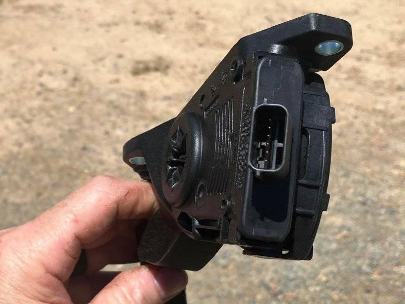

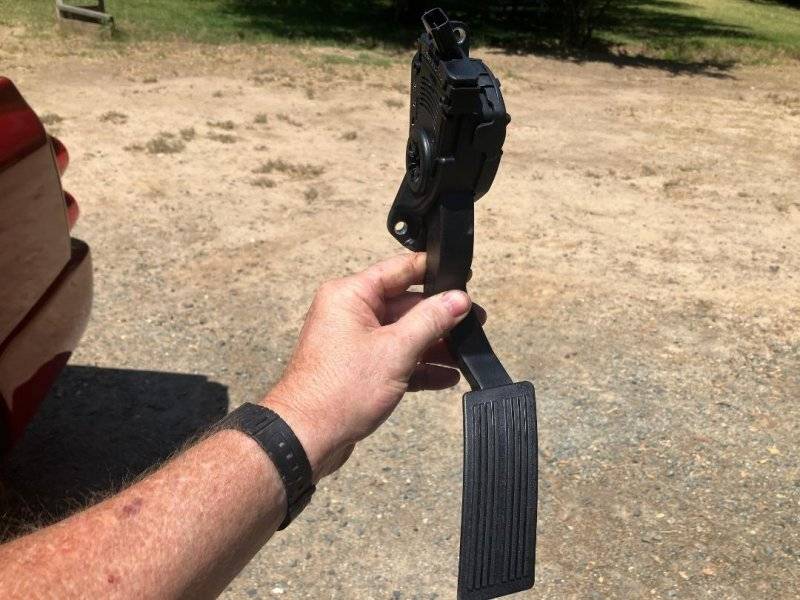

I researched this....it looked like a gas pedal issue. Get this....the gas pedal on this 2007 truck looks like this:

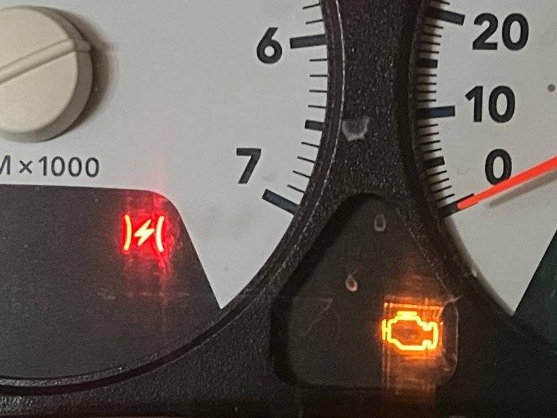

I'd get this icon on the dash:
Sometimes along with this:
By the way....that is NOT a "check engine" light, it is called a Malfunction indicator lamp.
When the red lightning bolt comes up, the gas pedal often goes dead. The engine will start and run but not move off of idle. Since April, the red bolt has come up a few times but when I shut it down and restarted it, it was normal again. I put off repairs until the problem got worse.

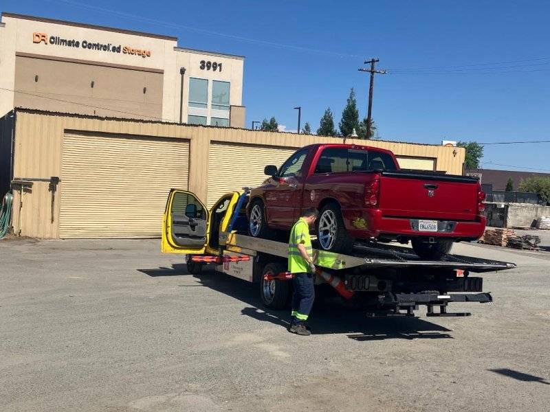

Two weeks ago, it did and I had to be towed home in this truck, the first time ever in over 411,000 miles.

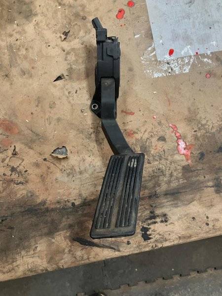

At home I swapped in another gas pedal from a junker. It would idle but would not move so I ordered a new one....

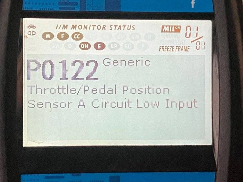

I swapped it in yesterday and it seemed fine. I went out to run errands and it failed again...same lights on the dash, same code: P-0122.

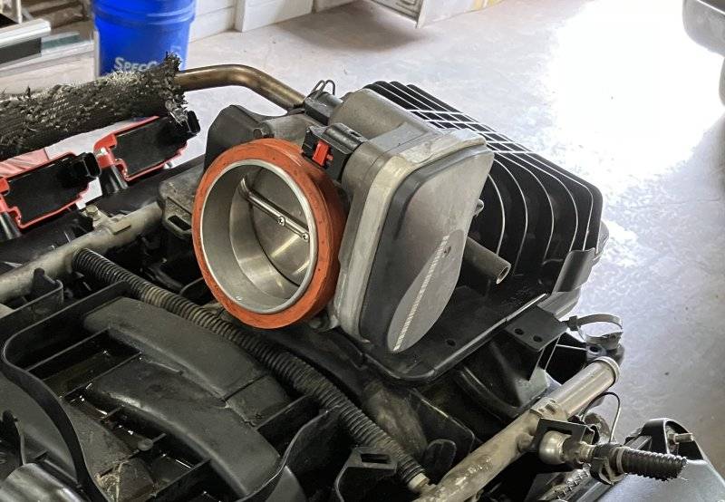

I had it towed to a local shop that I trust. I thought that maybe the throttle body itself was maybe bad so this morning, I brought them a spare:
I got a call a few minutes ago....they found the problem and fixed it.
GREAT.....so it was the throttle body?
No, it was not.
It turns out that the computer needed a REflash to mate/recognize the gas pedal.
What the heck, man ?? Reflash for a damned gas pedal? In the time I've owned this truck, I've replaced two transmission shift solenoids, and EGR valve, all the fuel injectors, 2 oxygen sensors and every one of those had some electrical connector so why would the gas pedal need a reflash ?

The man explained it.....The gas pedal sends variable voltage to the throttle body to read. They have to be able to read each other to function properly. He thought it was luck that it started and ran as long as it did without them being "synchronized" or able to read each other in time.
No, it was not.
