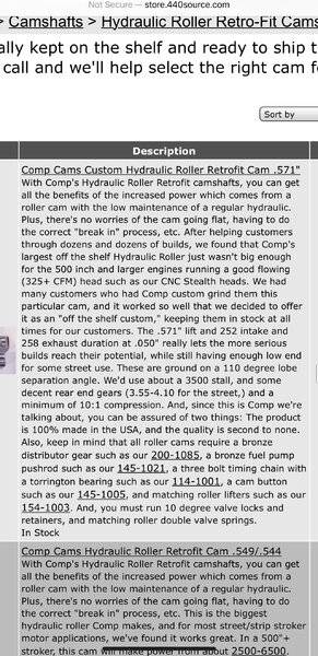

Here is what 440 source says about the existing cam in a stroker, the hydraulic roller lifter version
http://store.440source.com/Hydraulic-Roller-Retro-Fit-Camshafts/products/155/
Personally, I would want to see what the current cam is degreed in at. Maybe someone checked it and it was good?maybe not. Also a good idea to Run a Torrington bearing chain set with the roller cam.
