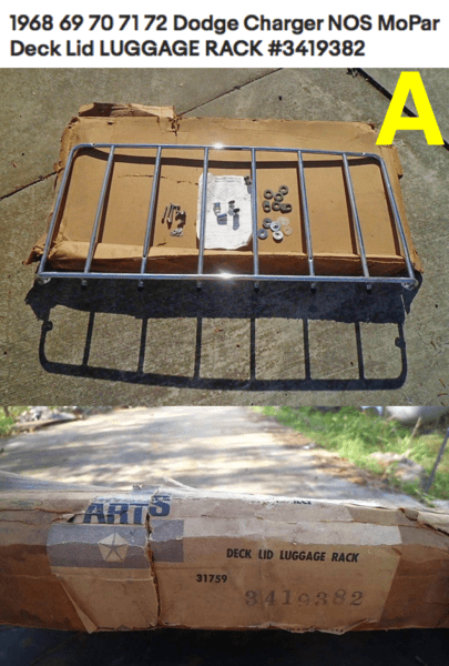

A - From an ad on eBay; showing the box with the Mopar Part Number.

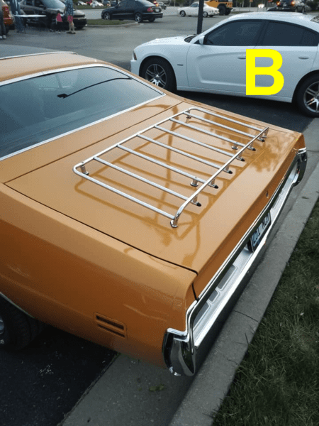

B - Looks like A.

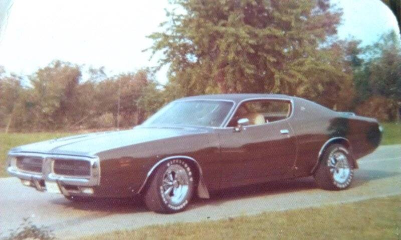

C - Is this a Mopar luggage rack?

C is an original E body rack... Charger racks are pretty rare...

Years ago, I helped my friend restore a 71 Road Runner with the factory luggage rack. He elected to not put it back on the car, as we replaced the trunk lid. (it had been broken into, and the area around the key lock was butchered.) Anyway, I remembered it has the black bullet tips like in photo B. He gave the rack to another buddy who was restoring a 70 Charger with a rack, and needed a few of the tips.

So are you saying that Pictures A and B are for a B-body?
I can't say with 100% certainty from the pictures but they are close... The flat tags at a angle is correct but that design was used on allot of other cars... The common rack that is wrong but somewhat close is the 70-73 Corvette rack... I got new tips for my rack from a Corvette rest house back before Mopar parts vendors were selling them...
