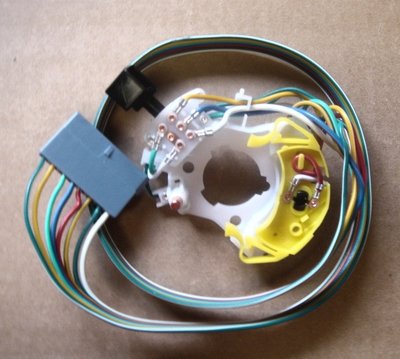

I have no brake lights on my 71 Charger. I have power on both sides of the brake like switch, and all connections appear to be fine. I'm pretty sure its the switch in the column, which I understand is common. I really don't want change it, as all the replacement ones (see pic) look like junk made in China. All my other lights work, just no brake lights. Can't I just bypass the column and run a fused wire from the switch to the brown and green wires to the tail lights? Or run a full time hot wire to them and use a single wire to throw a ground.

Replacement is not too difficult. You probably will have to remove the plastic connector to snake the harness up/ down through the column jacket. Just tie/tape a pulling wire to the old harness before removal and use that wire to guide/pull the new harness back in. Don't force anything-you don't want to scar up any wire insulation!

Basically, the column switch separates the front and rear turn signal circuits. Half the column switch controls the front lights and dash indicators. The other half of the column switch controls the rear signals/brake lights. When the left signal is on, the left front, left dash, and left rear lights flash, the left brake signal is disconnected, while the right brake is connected. The opposite occurs when the right signal is selected. Technically, the rear bulbs have a bright 'signal' element (brake/signal) and a dimmer 'park/running' light element. The column switch separates the circuits so that the dash indicators and front signal lights do not come on when the brakes are applied while permitting the rear bulbs to flash or light solid independently from each other as needed.
Thanks and all the help and feedback on this. I've taken the steering wheel off all the wires and connections look good. I tested the terminals with a test light and don't seem to have power to the brown/green wires but I don't completely understand the circuitry. At this point I might as well replace it as the turn signal action isn't so good and looks original. I only see it on Ebay and looks pretty cheap. I guess it a pretty simple device so hopefully it will be decent.
You will notice that the wires at the switch are terminated with a tiny eyelet, crimped on. The eyelet is held down with a tiny brass rivet. This rivet is the contact for the steel spring wires on the moving switch plate. What typically happens, is that the brake light will draw excess current, enough for the rivet to get hot and melt some of the plastic around it. When the brakes are released, the plastic cools, but not before it has wicked around the rivet head, or across the top of the rivet head. Sometimes you can 'fix' things by carefully scraping some of the plastic away, allowing the circuit to work again.
