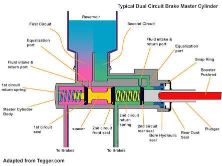

The o' rings from the piston inside the master cylinder are old, cracked or worn out specialy if the master cylinder was too much time without use, they just can't hold the pressure from the pedal, even new they fail, no air in the lines no old parts except for that particular rubber ring
You can see it here as "seals"
