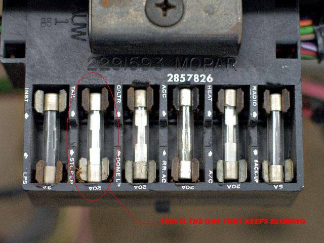

Power from fuse block? Easy to test and if that's it easy to fix

Don't remember the wire color off the fuse block but it's marked on the block if you can read it. u should have power to both sides of the fuse, power on one side only, it's the fuse, power on neither side and the easiest way to do it is run a jumper wire
found this on the internet, it looks exactly like my box in the roadrunner, should be the one on the far left

The power originates from the light switch, terminal "R', black wire, to the panel dimmer switch. From the panel dimmer switch, the tan wire goes to one side of the fuse. There is no power at that fuse until the light switch is "on". From the fuse, orange wires feeds the various instrument lamps including the radio light, column shift or console shift indicator, ash tray and clock light.
