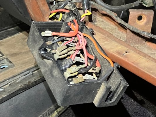

I had an odd experience when I was working on my instument panel for Grendel. All my interior green LEDs were working beautifully, then after I was working on getting the LED working for my glovebox light, none of the dash lights would light up anymore when headlights were on. The dome and console lights were still working, but nothing on the dash. I was thinking my headlight switch spontaneously decided to crap out, but I checked the fuses and the new instrument panel fuse I'd installed earlier had indeed burned out. I must've shorted out the housing for the glovebox light while removing & reinstalling it. It's quite easy to short it out because of the way it inserts into the metal glovebox frame. Not sure if this helps...
I started with what will probably be the hardest to diagnose and fix. About 5 1/2 years ago before I got the car running, I changed a few things in the wiring harness though I did use factory parts.
It had a fuse panel with 6 terminals, I put in one with 7. Unfortunately, access to these B body fuse panel sucks.
You open the glove box door and remove a slide cover.
That isn’t so bad but the 7th fuse is now obscured by the edge of the glove box liner.
With my head inside, I could see but since I have a regular sized head, cameras and mirrors are the best I can do.
The fuse in the terminal labeled “Instrument Lamps” gets no power. The fuse itself looks fine.
I’m tempted to relocate this panel to underneath the glove box…
Maybe forward and above the console?
This does not have to be done now though. I have to avoid the trap of The Snowball Effect where one task turns into three months of down time addressing numerous other things.
My Coronet didn't even come with the box part of the glove box, which makes it easier to get to the fuses but it still sucks. When I added a few things I just jumped straight to a secondary fuse box, not correct but makes life easier and the one I use will light up the fuse position when a fuse blows. I'm still on the fence about eventually running everything thru it.
Is the rest of your dash, meaning radio and ashtray intact? Mine wasn't so I was able to check the back of the stock fuse box easily enough.
No power was coming into the 7th terminal…
So just for fun, I hotwired the terminal.
Whoa!
Now I’ll see where the power input is supposed to come from.
“instrument feed” is circuit E1-18T, a tan wire that comes in from the panel dimmer.
Did I find the cause?
I thought that I have the 7th terminal wired backwards but on closer inspection, it is right.
For the most part, it is as it was built. I extended the wiring to the instrument panel so I can have the cluster out while having better access to removing or accessing the wire connector since those brass pins are so fragile.
It keeps being weird.
I tried different headlight switches and another dimmer…
The headlight switches all work. One spade is supposed to tie into the panel dimmer, the center terminal.
It is dead no matter what. If I power up that center terminal, the panel lights up.
I feel like a guy on an island looking for gold, essentially using “layman common sense” instead of trained diagnostic skills.
