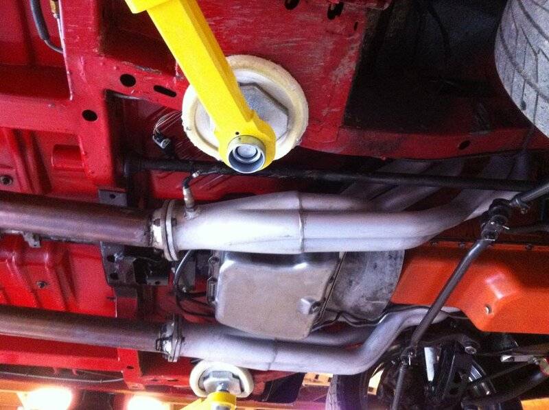

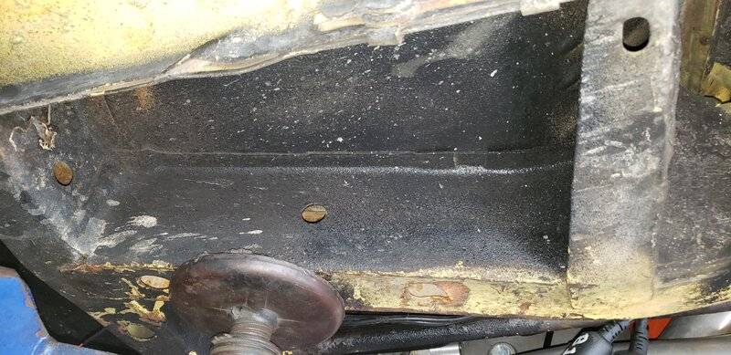

I think I know where the rear ones are, and I took pictures. I'd like someone who KNOWS what they look like to confirm that I have them, or am I looking in the wrong place?
Rear: Are these torque boxes?

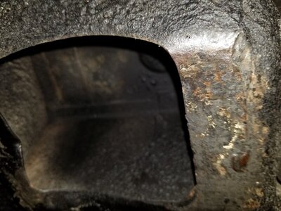

Also, did V-code and Hemi cars have front torque boxes-like where the ones USCT sells go?
Is this a factory front torque box?

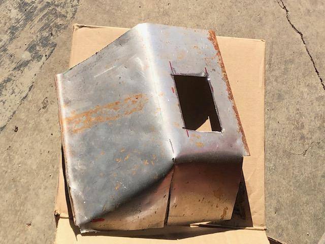

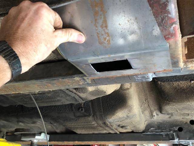

I made my own:

Yep, that car doesn’t have torque boxes. If it were mine that would cause me to dig into the authenticity a bit further.. v code 4 speed should absolutely have torque boxes.
The red car got a shorter front torque box. The "Jigsaw" car front boxes went back to the torsion bar crossmember. I think that thr red car design is closest to the original style.

This is the best I can do for rear torque boxes. None of my 67's have front torque boxes. I think you find the front torque boxes on HP convertibles. 20200629_191909.jpg
