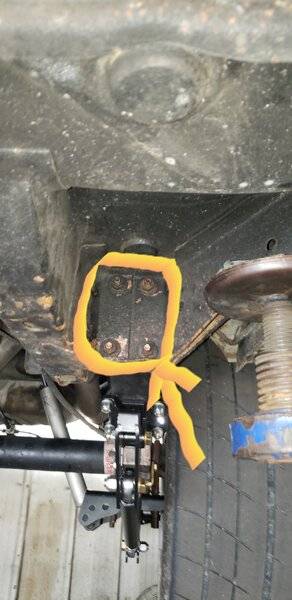

Ok, so these are the spring plates for my car:
and here is where I'm thinking they go?
I'm curious why they taper towards the bottom vs being more square?

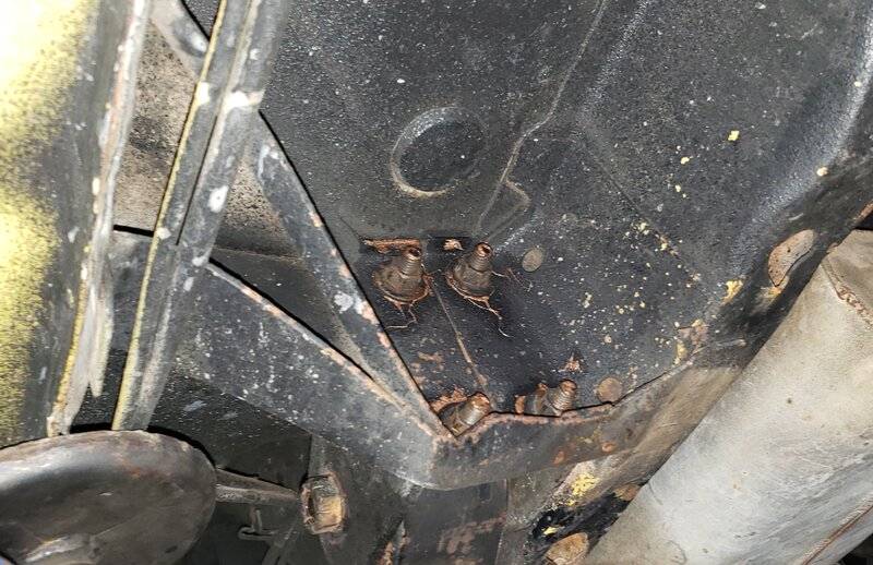

Here's the other side. Both sides seem to have another layer of metal under the nuts if you look closely.View attachment 969131
ThanksI am not sure about this as I am not that good with 1970 RR's but from a build sheet decode it looks like a "S15 Hemi/ Police Suspension HD" could be ordered but maybe you did not have to have that. IDK Just throwing it out there.
