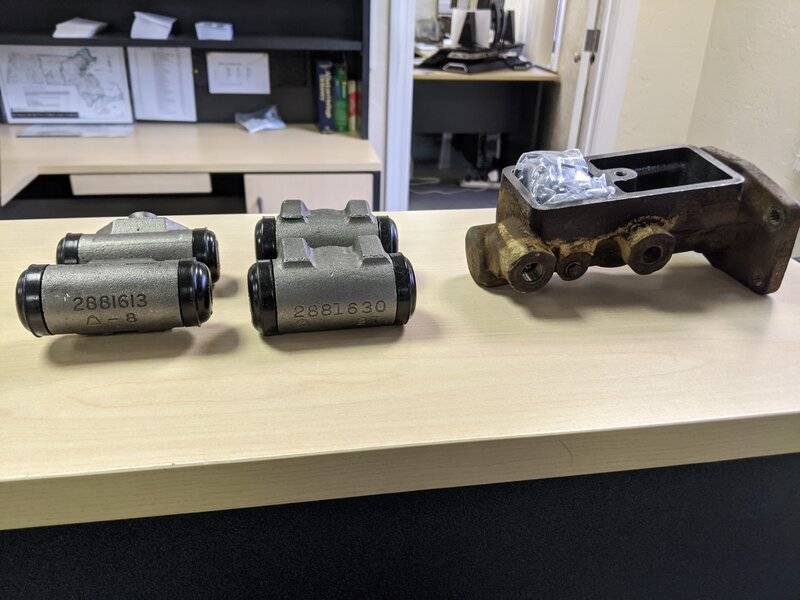

I know you know your stuff but those cylinders are only salvageable if they don't leak after you rebuild them.... After your done and the system is bleed and your satisfied the pedal is hard, make sure you keep checking it days and weeks later. If any doubt pull the drums and peel back the boots and look for leakage. The fluid doesn't have to be pouring down the backing plate for the cylinders to be badGot the rear wheel cylinders out, apart and cleaned up. They're salvageable.
Also once the drums are adjusted if the car pulls, recheck as you could have a piston hanging up in the bore
