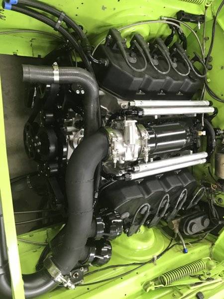

No room for turbos under the hood??

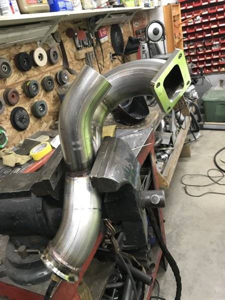

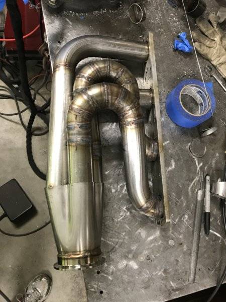

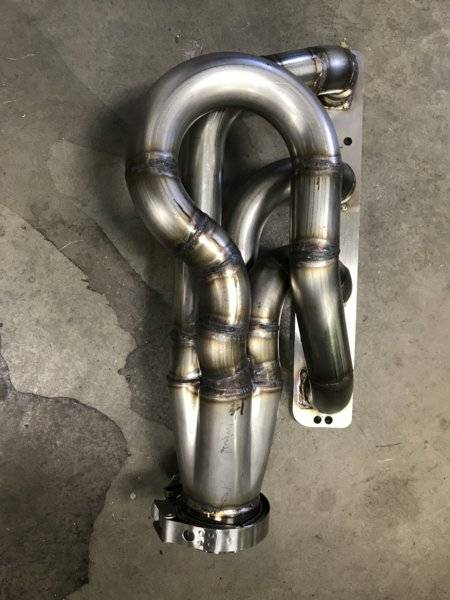

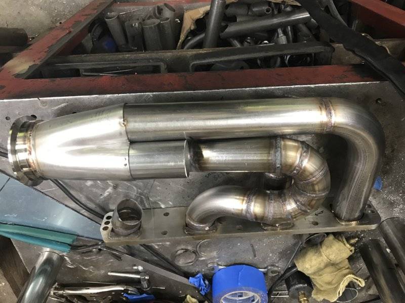

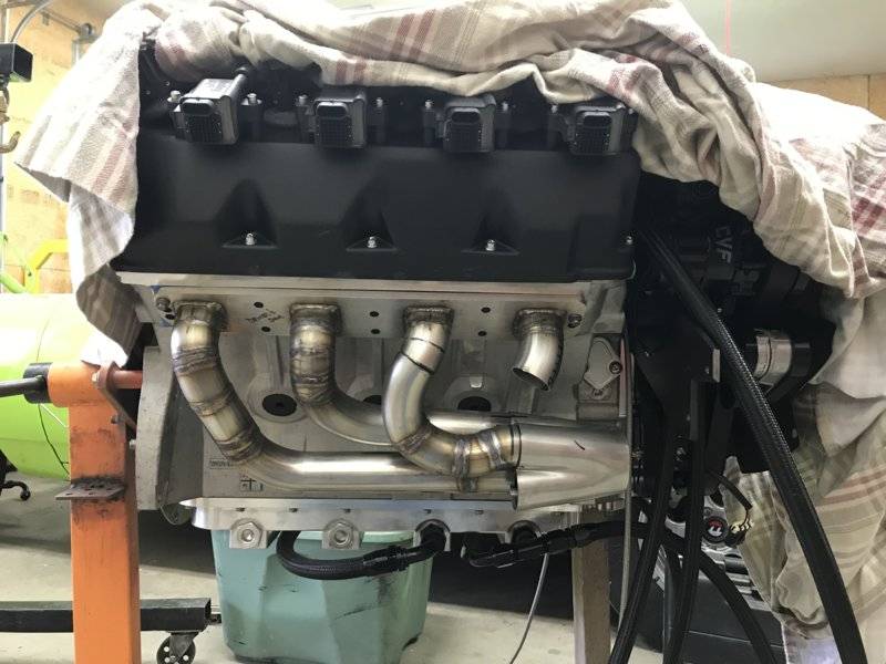

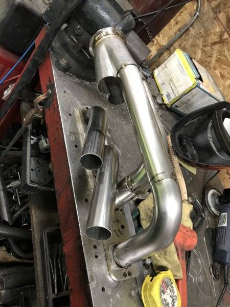

Starting header construction. They won’t be pretty
Pffff...they'll be better than this I'm guessing.

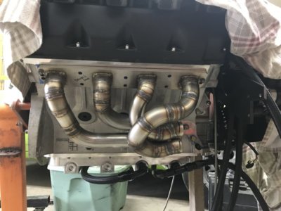

Yeah I’m sure they’ll be better than that, lol. I got this side done, but the number 2 pipe is hanging out about a 1/4” too much. This is my first stainless set and I’m amazed at how much this stuff moves with heat. Once I get then engine back in the car, I’ll check fit and change that tube before the collector gets added.

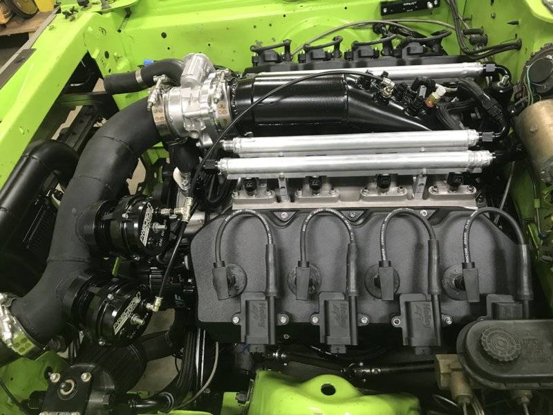

This is a Gen2 426 based engine. The Edelbrock head was developed with the larger cubic inch hemis in mind. They don’t require any real porting and I just cleaned up the ports. That’s all outlined in my Superbird thread. The K-member is the one I made for the Superbird as well. It’s a RMS Alterktion but wider so the forward exhaust has more room. The aftermarket front suspensions really kill turning radius on these long wheelbase cars.

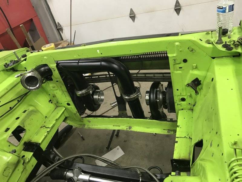

Cold side done and painted... turbo blankets on. Engine is ready to go in for the last time.
Turbos are mufflers! Lol
That must be true since I've been running my turbo diesel for over 15 years with a straight pipe and no one has ever said a word to me about it....even after looking underneath pretty hard during inspection. Other than that, it's stock. Man, what a build you have going on!! :thumbsup::thumbsup:
Did you make the head flange or buy one? I need to make new headers this winter.......

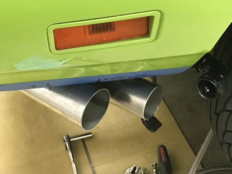

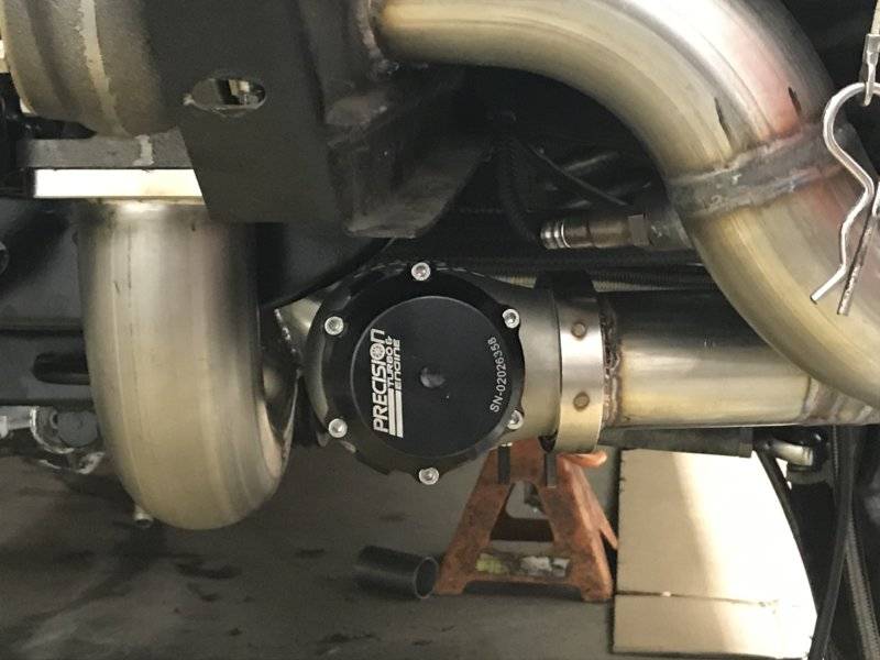

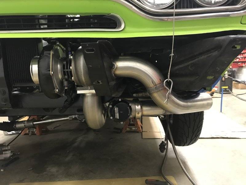

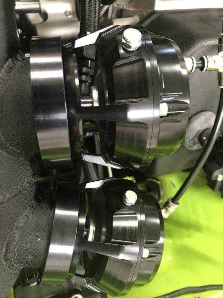

Headers are done. Got one waste gate mounted. I’m not in love with the exhaust but all other options involved cutting up the car.
