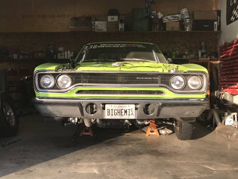

You HATE the headers??? Can you make a set for me to hate also??.....PLEASE!!
Lol, I don’t hate the headers. They turned out ok. I think I could really do better. The part I wasn’t really keen on is the exhaust location underneath the fender. There just wasn’t any better locations to choose from.

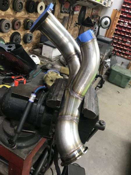

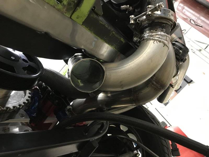

I finished the passenger side waste gate. I also decided I didn’t like the cold side at all and wasn’t having much luck with figuring out a condenser mount setup with those tubes in the way. I ripped it out and sawed it up. Going under and up so I can mount the condenser where it should go. It will also let me run air filters. I’m almost done with the fab. Then I can start wiring the car.

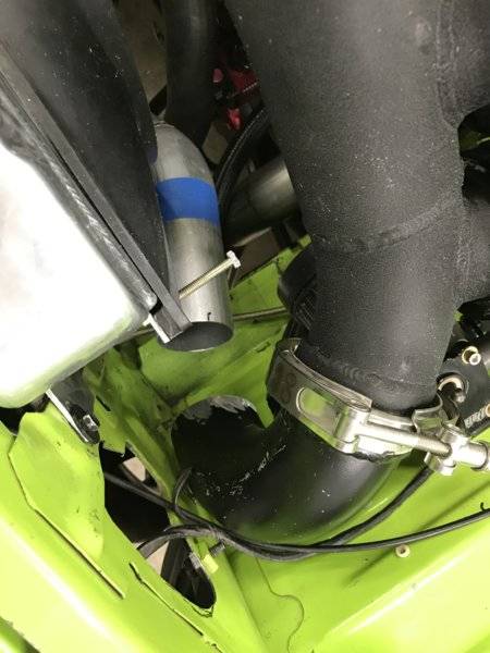

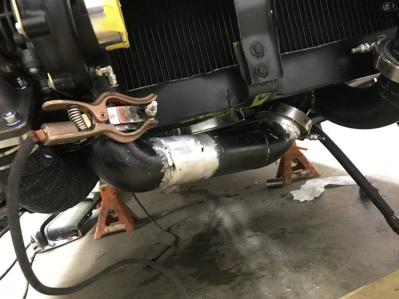

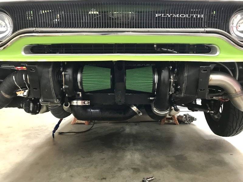

Cold side all done, runs around lower radiator hose.
Wrapped all the hot side pipes

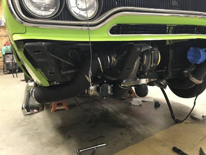

Air filters showed up today and actually fit. Fitted the bumper back on as I had to clearance the bottom flange for a few things. They’ll be a black air dam under the bumper that will hide the tubing.

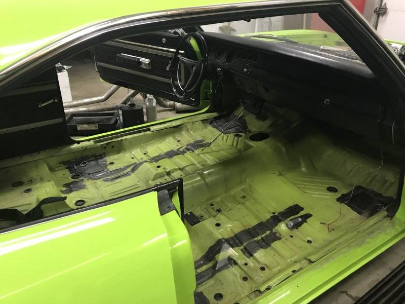

Cage out. Ready for a new 8.50 cage.

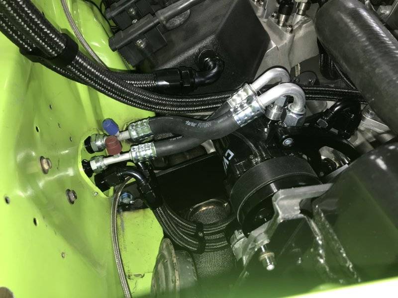

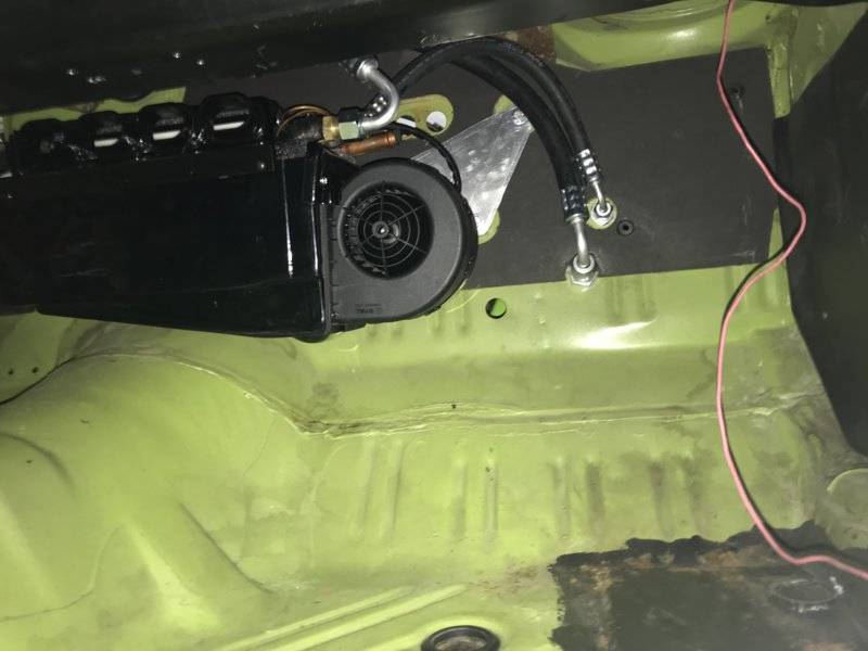

Got the AC/heater box mounted and lines ran.

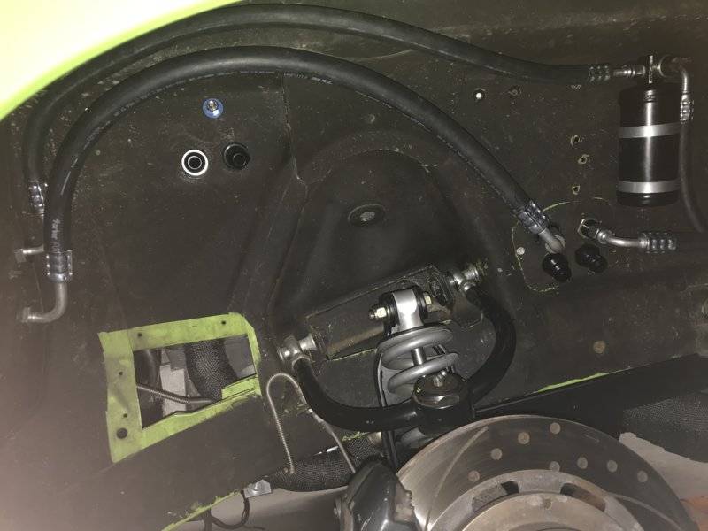

Ran the lines under the fenders
And hooked up the AC pump
