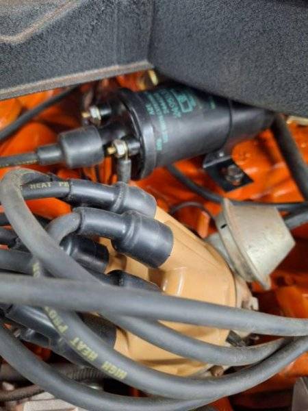

Me again fellas. 1971 Roadrunner, 383, all original. So, originally you all helped me figure out that I had a bad ballast resistor. Car worked well for a little while, then pulling it into the shop and it dies. Appeared to be the same issue, it acts like it wants to start when turning the key, but won't run when key is released. So figured it had to be the ballast resistor again, put in a cheap one, seemed to have worked. Yet the resistor that was removed was an original style open back and could clearly see that it wasn't burnt thru, so not sure if that's what happens to them or what? But anyways, it worked for a VERY short time and did it again, this time, no change of the ballast will get it to start. I've tested the ohms of all the resistors, the two that supposedly burnt out and a few new ones that I have that are new. They all come back anywhere between .5 and 1.8 ohms. Any idea what my issue could be here. The only piece that wasn't original was the Accel chrome coil. So swapped that out with an original and even tested with another stock style new coil, notta. Now everything is 100% stock, everything's been replaced with original or the closest I could find. Very frustrating as how am I ever supposed to trust this car driving down the road?...lol I'm a whee on the illiterate side when it comes to electronics, but for you pros, if you have some specs I can check, I do have a meter, don't really know how to use it, but I have one...lol Oh and my bulkhead connectors are all good, most have been replaced.
Did you check for voltage at the positive terminal on the coil? Need to know the voltage with the key on and while cranking. You have a simple system and if it was in front of me it would be diagnosed in minutes.

The ignition switch is also new. As per testing the coil voltage, I live by myself, so I'll have to get a buddy to come over and turn the key while I test it. But I'll post those results once I have them. As per point gap, I can't recall, but it was whatever was original, I'm thinking .016 or .017 if I remember correctly.

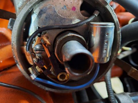

Check your voltages like they suggested so you know where you are voltage wise. I'm with RemCharger and would change the condenser in the distributor. A bad condenser will keep it from running and are hard to isolate sometimes.
