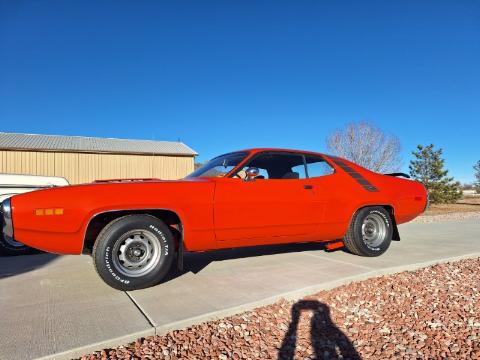

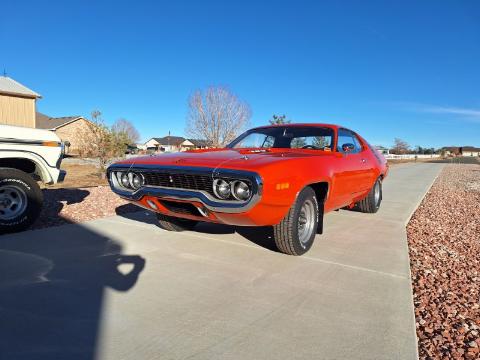

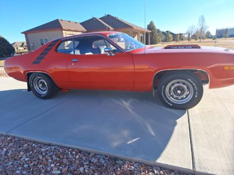

Thank you fellas, as much as I wasn't gonna let anybody tell me it was my bulkhead as 3 of the 4 harnesses are new. The new engine harness had a wire not crimped into it's connector anymore and was hanging loose. She fired right up...lol Bee1971, you called it buddy. Thank you all for the help as always...:thumbsup:

Nice clean original engine department by the way , Looks damn nice
Beautiful

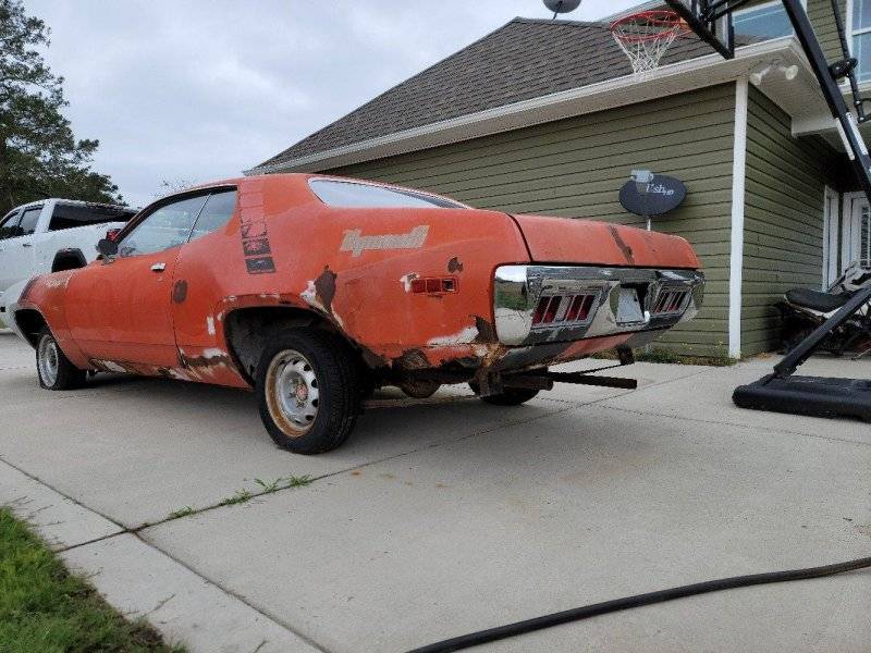

Thanks again fellas, car's are always much more fun when they work...lol Thanks Bee, she was a turd when I got er, but about 8 months of hard work and other than a non-working tach, she runs like new. Didn't even pull the motor out, restored her where she sits, never has been rebuilt as of yet.
