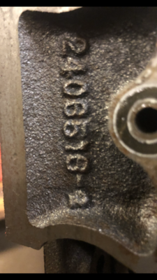

Hello. I’m brand new to this site. I have an engine question. 25 years ago I purchased a brand new still in the crate 413. Block 2205697 head is 2406516-2. The engine has mechanical tappets. Bore size is 4.19. A very reputable performance engine shop has verified that this is indeed brand new never started. They are in the process of doing a complete tear down, cleaning, installing hardened valve seats, etc. I’m going to have it put on a dyno as well. The engine is red from the factory with no stamp on the block yet. Any ideas on what year, and application for car that this may have been used for?
Here is a pic of the head casting. Looks like a poor cast job. Looks like a dash 2 better in person

Here is Uncle Tony talking about RV and Truck engines. From 413 to 440. By the way the 516 heads are typical of the era. Someone will correct me if I'm wrong but I think they are closed chamber heads.
Yes they are closed chamber heads

Info I found says 2205697 block is 59-65 413, and 64 426 (street wedge obviously, not hemi or maxwedge).
Head casting 2406516, my info shows 64-67 361/383.
What are the casting dates on the heads and block?
