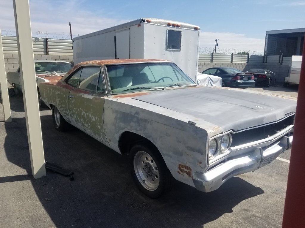

I figured I would share my current project. I have owned this car since 1992. Plan right now is to put a new motor in it and get it running to have some fun. It is ugly but has some good parts. The car is my 1968 Plymouth Sport Satellite. Original 318 auto car. Currently has a blown up 383 that spun a rod bearing 10 years ago and hasn't run since. Here is the rundown on the other good parts. 3.9 to 1 read axle with sure grip, 3000 rpm stall converter, headers with flowmaster mufflers 2.5 inch pipe, weld drag light wheels, Holley street dominator intake of manifold.
New motor is a .060 383 with forged ll.5 to 1 nos direct connection pistons balanced assembly and a mopar .509 292 purple shaft cam with 906 heads .
The bad is it is rough but hopefully will be fun.
I like it as is, looks rough but straight. Is it originally an A4 silver car?
I thought it's sweet, I might sand it and shoot some primer on it?
It is originally F 1 Mist Green I believe. It does have the Roadkill look going for it.
Great color. My A4 had that greenish tint which is why I ask. If the underside is solid, build the drivetrain and drive it as is imho.
I am not up to speed on my color codes but mist green is the color. Only rust issue is a little hole in the trunk other than that solid
Scuff it and clear it it looks bad *** the way it is !
Looks like a fun project. Love the patina too! By the way, I lived in Taft in the mid 80's.

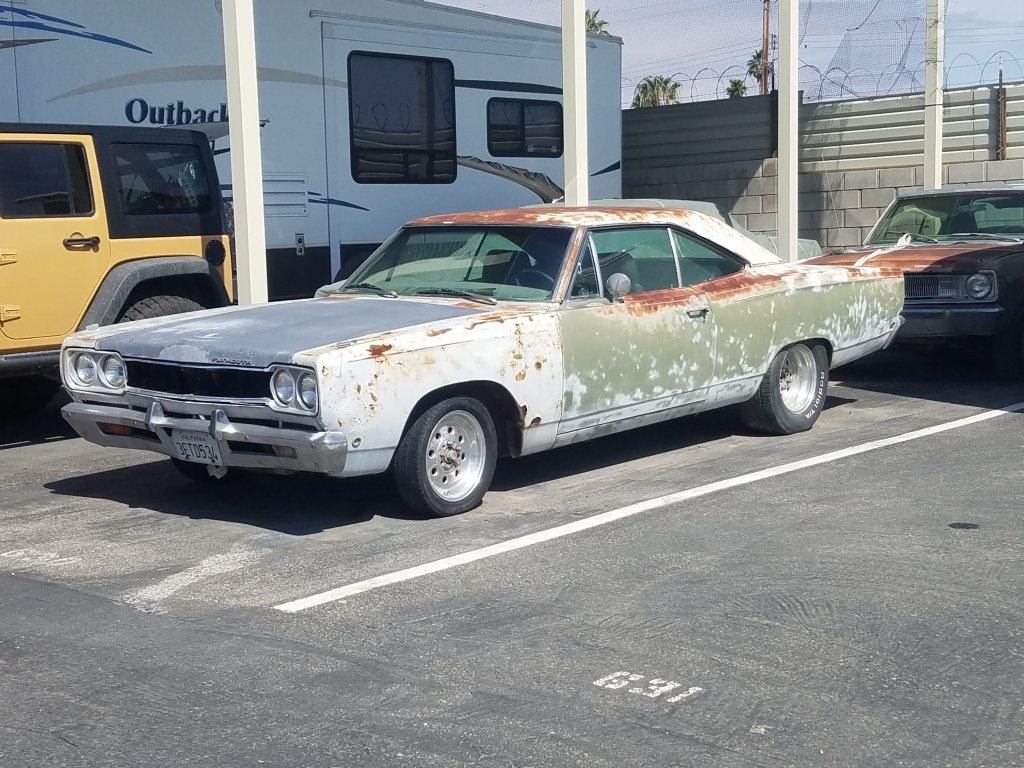

i will probably run this engine for a bit and see how it does. I have 2 options after that. I can go through the broken 383 in the car and build a little more street friendly motor or i also have 1969 440 short block under my bench that shouldn't be to expensive to build. If you look closely in the first picture, there is a 1967 Dodge Dart sitting behind the plymouth. 383 might be fun as a bracket car engine in that.

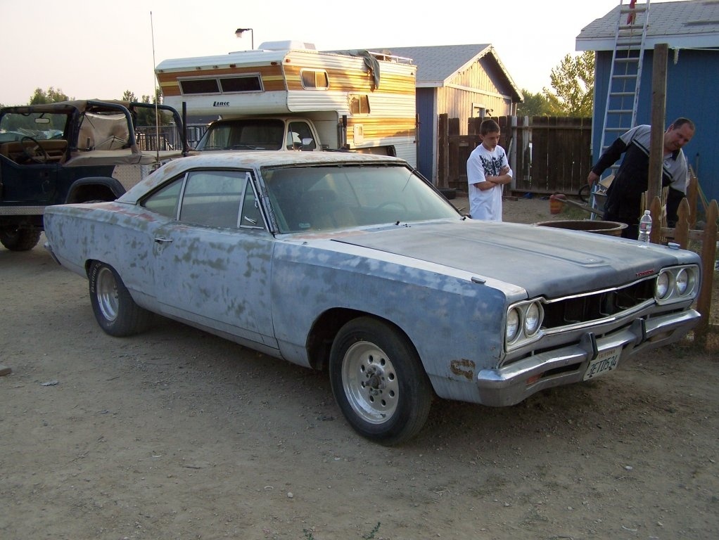

Here is a pic of the car when I was buying it back
