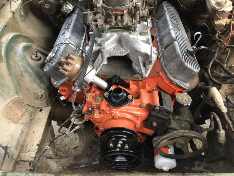

Here is a pic with a few more parts bolted up.
