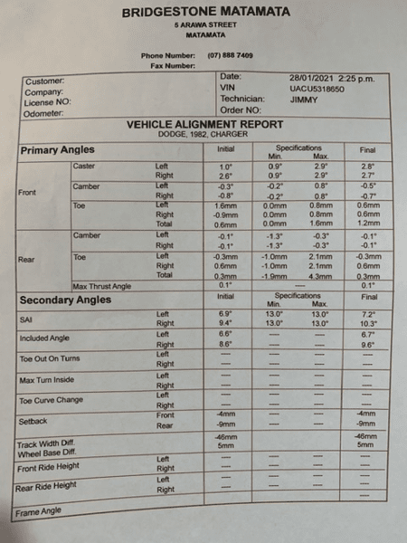

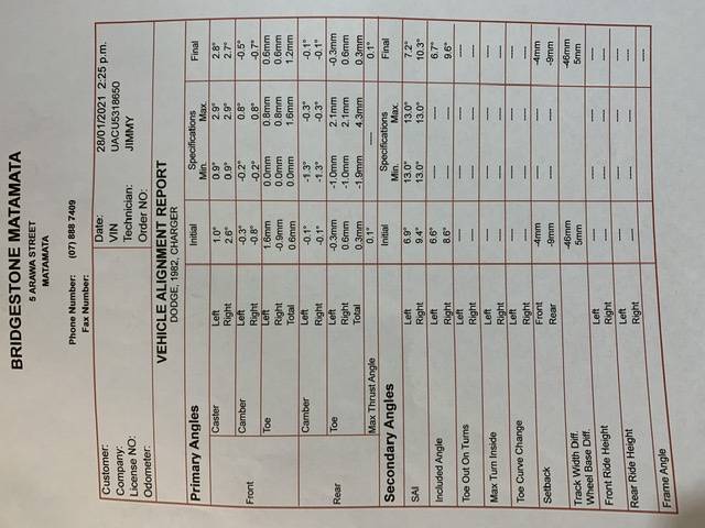

Attached is the wheel alignment report

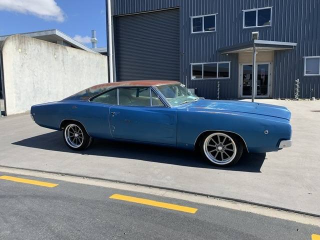

Pictures of the car? I'd like to see how those low profile rear tires look.
Those metric readings are going to upset a lot of people here. :lol:

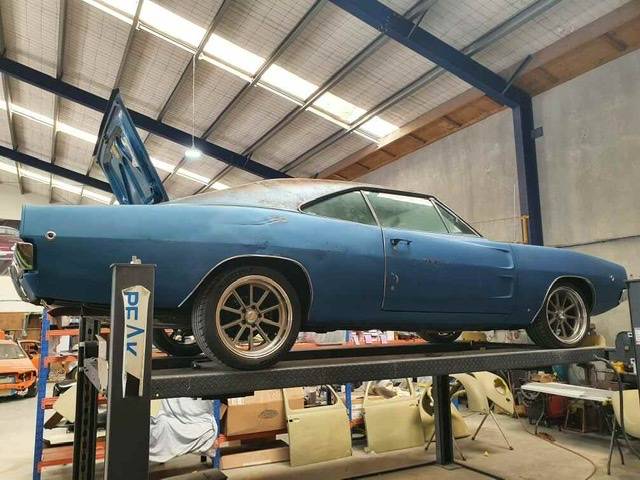

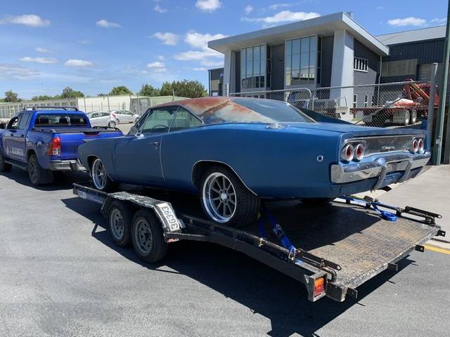

Here’s a few photos but probably aren’t that great for what you are looking at. Will take some more specifically of the rear wheels later this week.
76D1A514-0A3C-4158-8744-0CE64485853E.jpeg 6D411F83-9052-47CC-8D67-BB117B7C9784.jpeg BAC7DCF1-87FF-4A92-ABD1-BA2123723165.jpeg

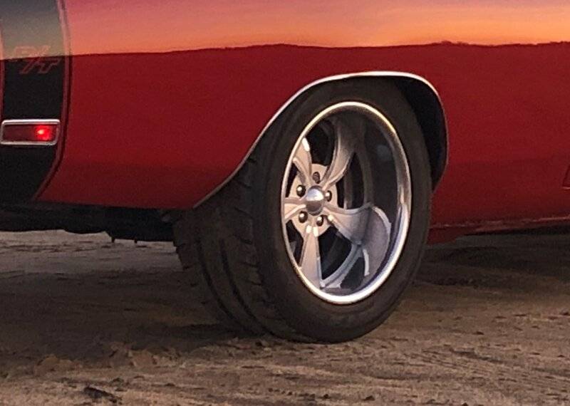

Thank you. I have a pair of 285 35 18s that I bought a couple of years ago. I have 295 45s on now and wanted a shorter sidewall. I wasn't sure if the 35 series would look too short for me. Yours look great!
