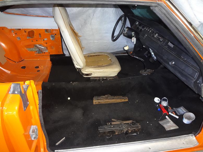

Ordered some non-molded carpet and have it fitting good, 4-speed hump needs tweeking.

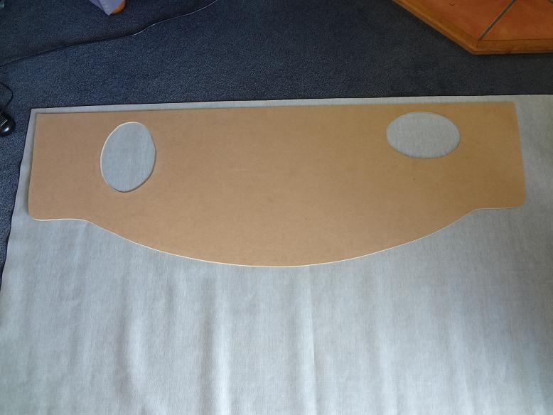

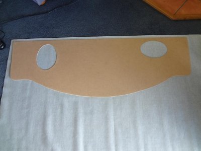

Cut speaker holes in rear parcel shelf, it is ready to be covered in black vinyl.

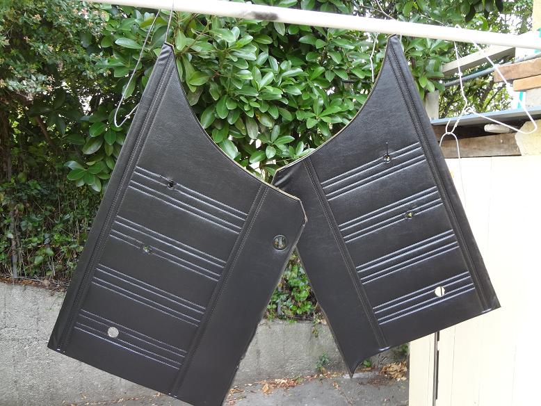

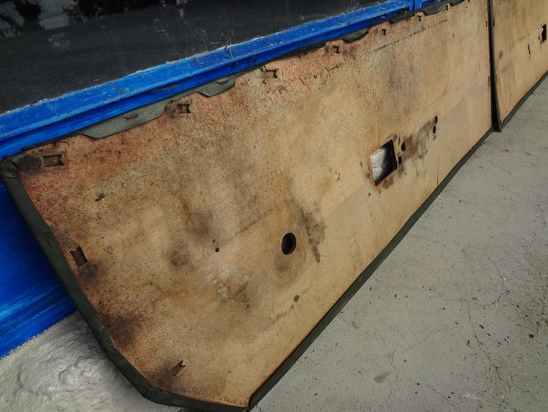

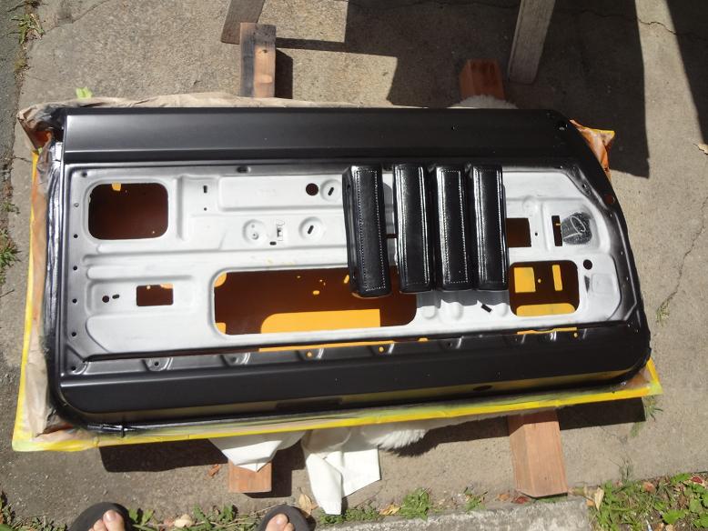

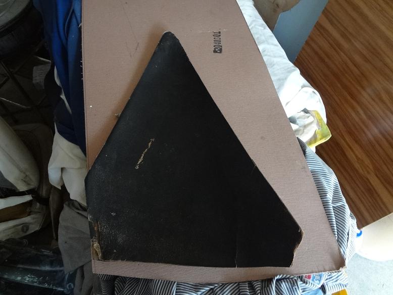

Have straightened door cards by re-soaking them in water and them placing weights on them while they dry out. Also had to make some patches out of 1mm alloy to repair clip holes. Have now painted them and the rear cards , black.
Inside of doors have been painted black, they are now ready to go on car.

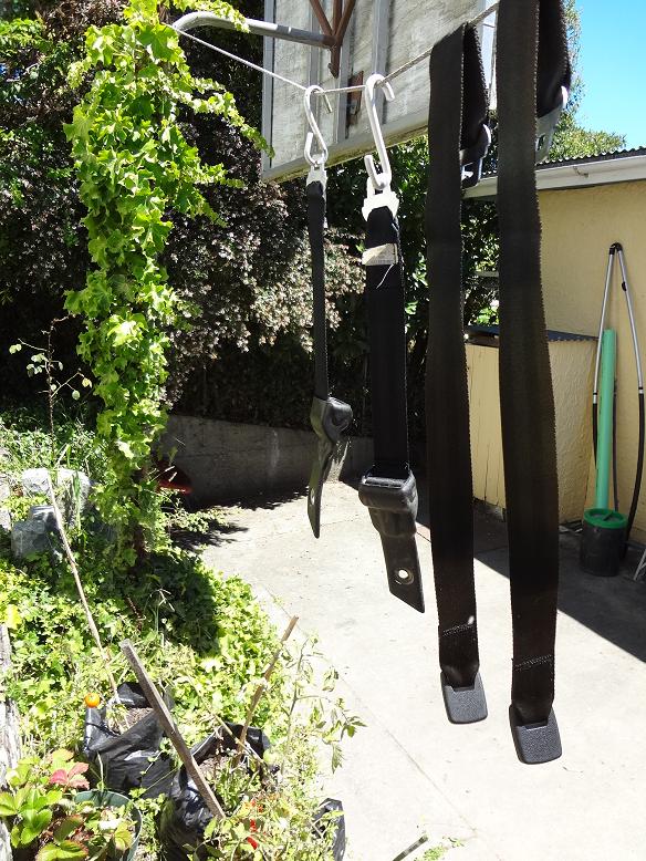

Washed seatbelts, have been able to find some original retractor belts, thanks Hawk.

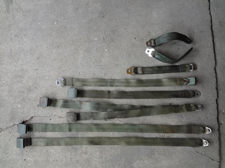

Missing seat belts arrived along with my new seat covers, big thankyou to Hawk.

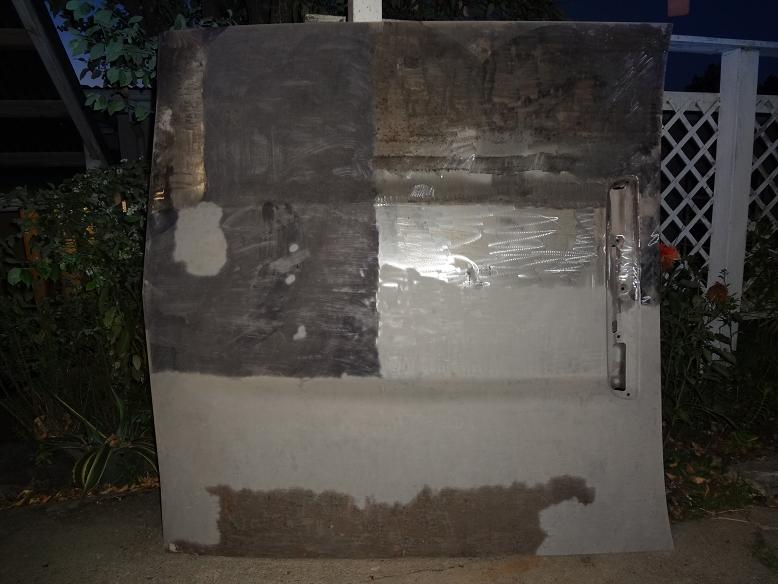

Been media blasting the hood,

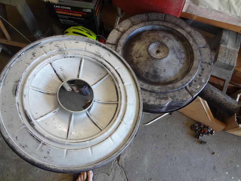

Cleaning and painting parts,

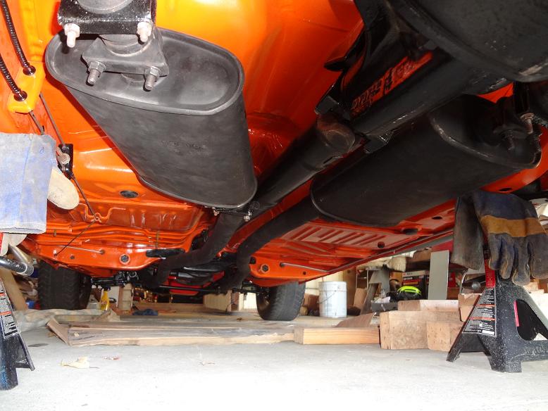

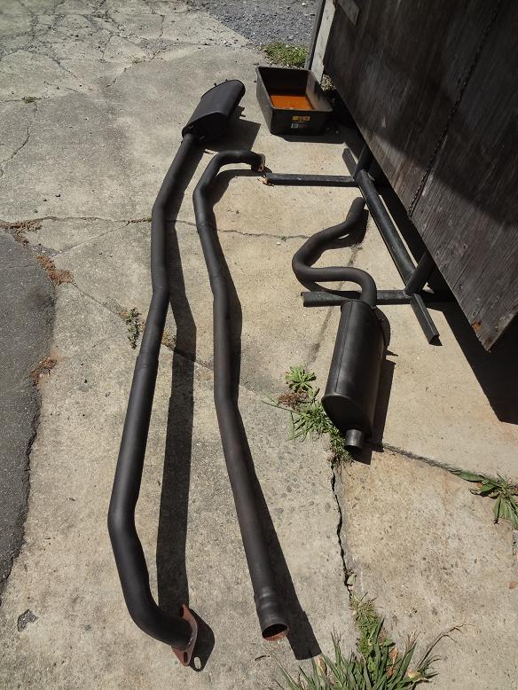

Exhaust system done.

Hey, I recognize those seat belts!

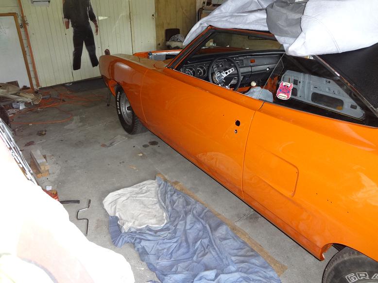

Got the doors and 1 guard on.

X-2!!! OH Yea! Beautiful, sun glasses available for shows sign needed :)

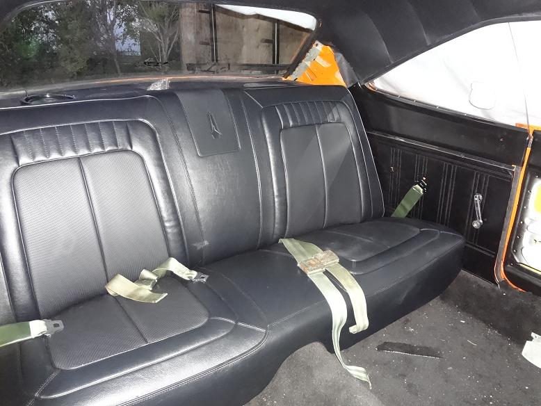

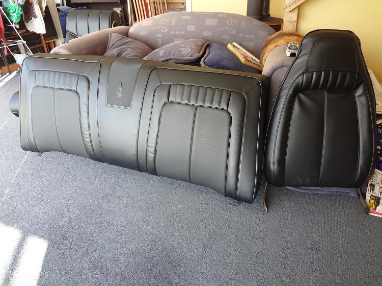

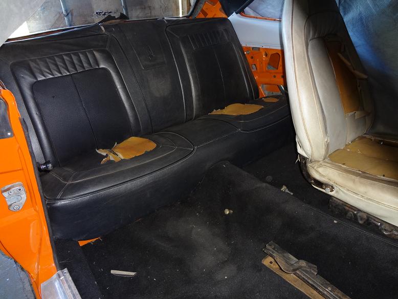

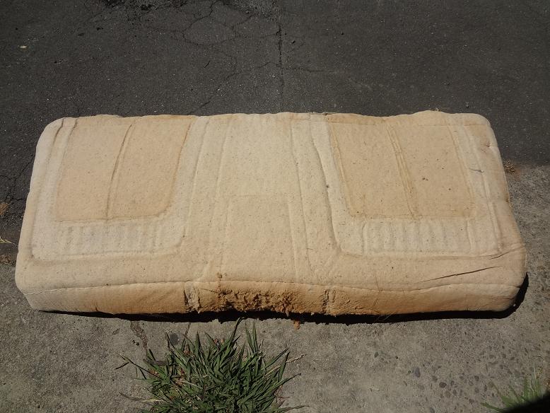

Today I talked my partner into helping my re-cover the rear seats. We did well they look great.
You'll have to post some pics Tony. The rest is looking really good.
seats
Sorry for the no photo post.

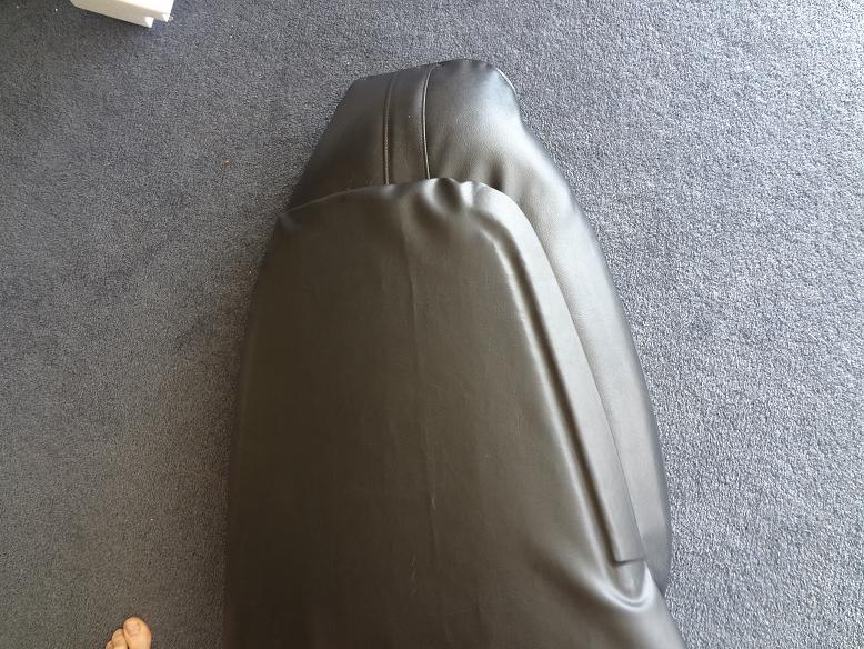

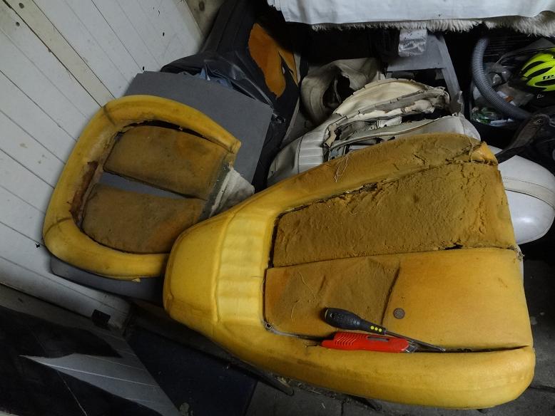

One of my partners friends was real keen to get in on the seat recovering action , so she helped me do a front seat Back. We did great, cover a little loose near headrest but hard to see why. My plastic covers were real bad, took a wire brush to them to remover the powdery top layer. We have made a start to cover them with vinyl.

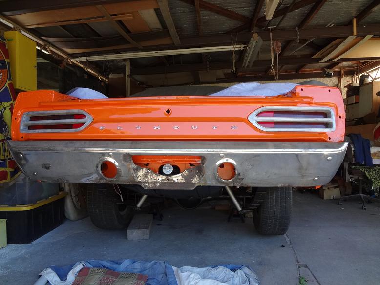

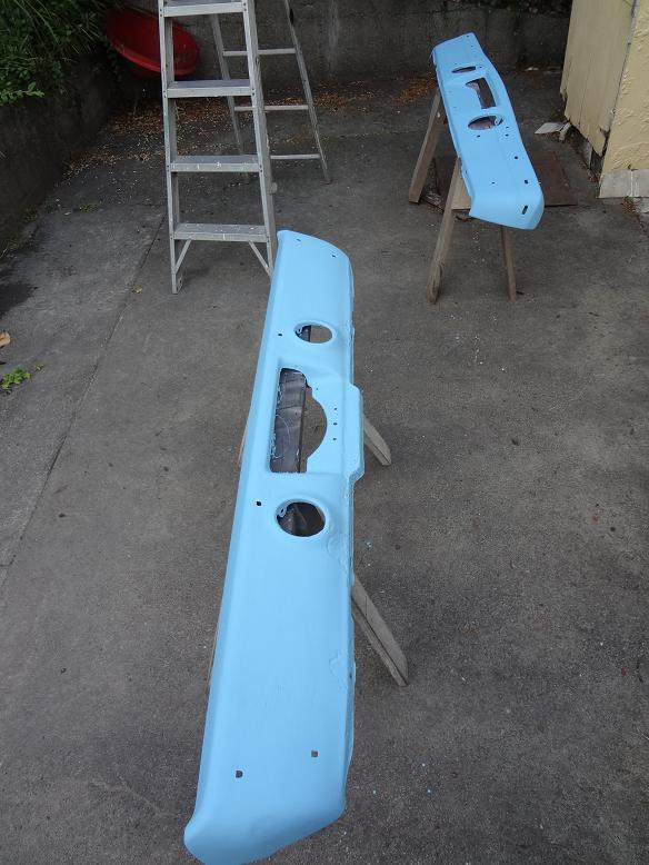

Bumpers need replacing, for now I have had them acid dipped and galvinised. Have etch primed and them heavy coats of spray putty. Will apply filler then prime and paint, either VC, matt black or a combo. Will buy new chrome later-on.
Rear of cabin coming together.

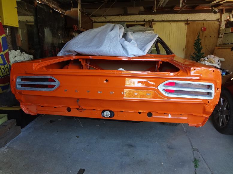

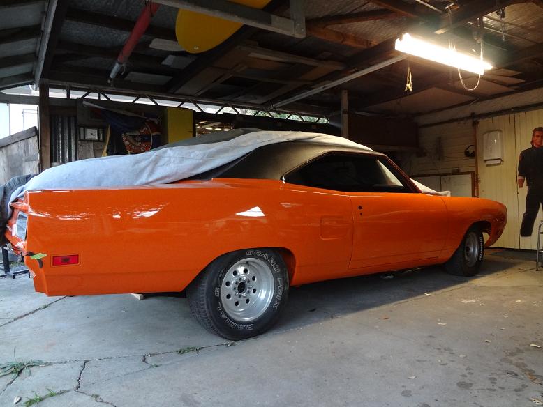

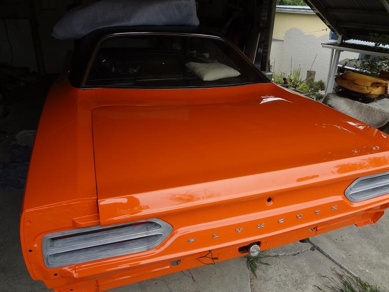

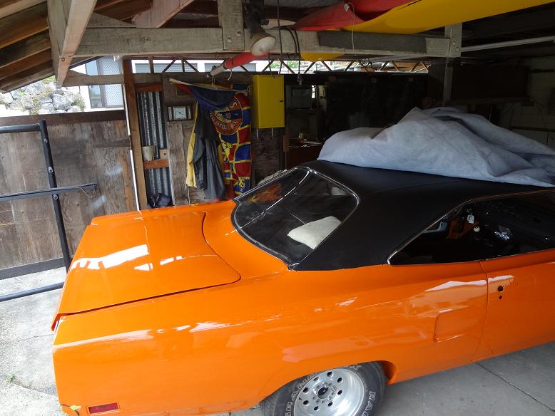

Got the drivers guard on , all lined up good. Trunk lid on also but it is sitting real close on the driver side. Wondering if I have got the arms/stays on the correct sides ?

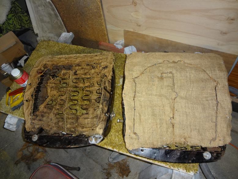

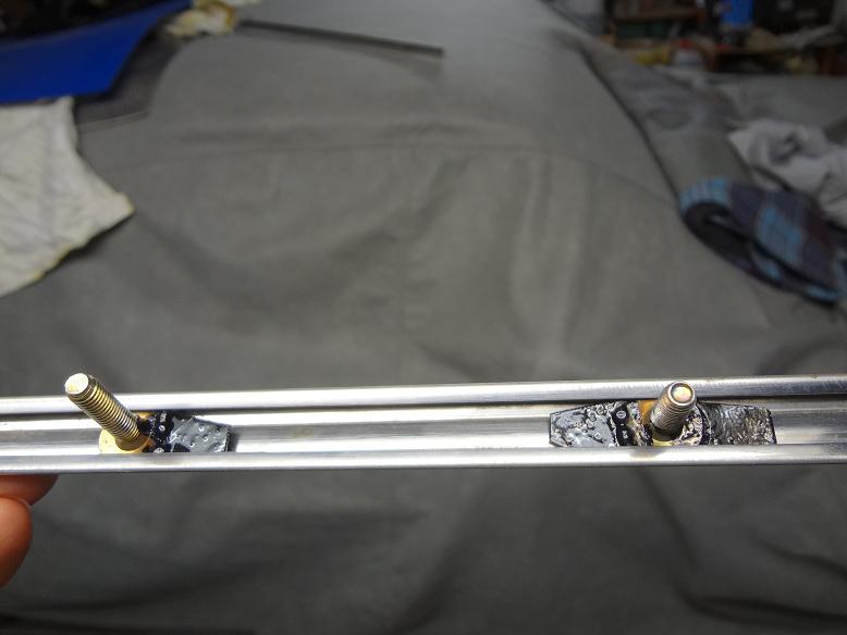

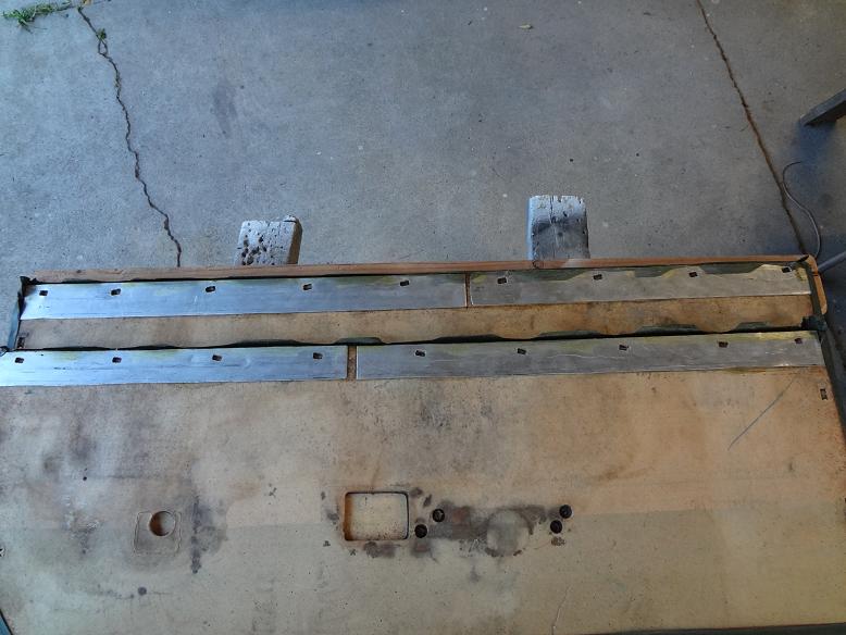

Seat bases repaired.

I think a little fine tuning with the deck lid and it will be ok.... The arms inside, you could try to adjust them into where its the way you want...
