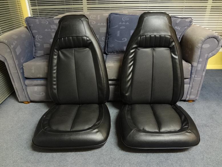

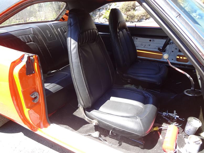

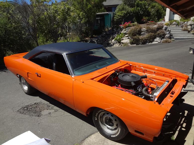

Have been spending more time on the car than I have at work.

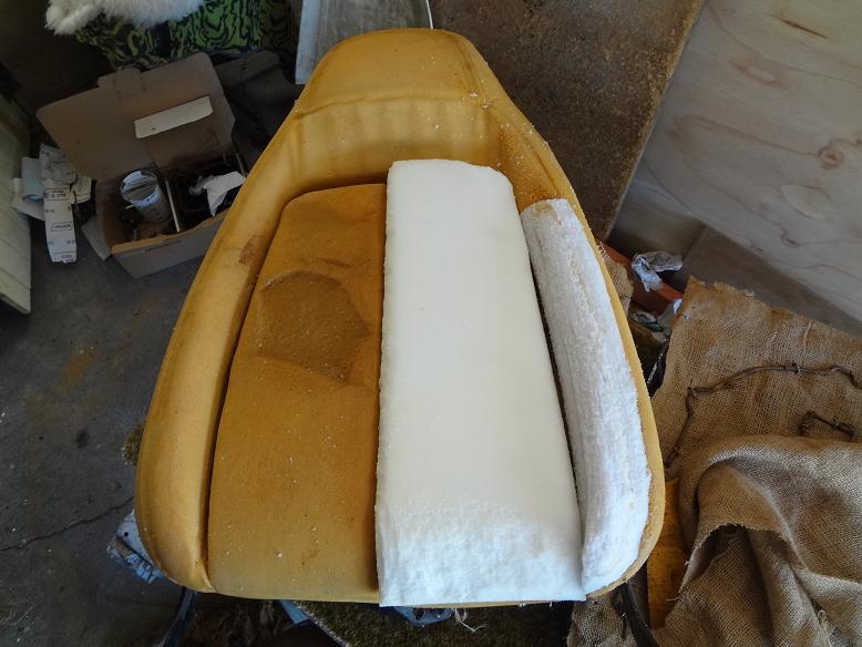

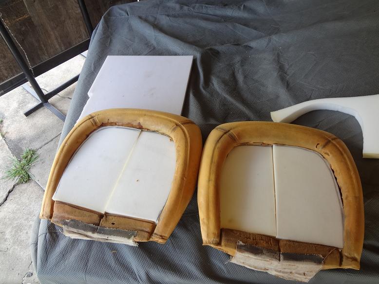

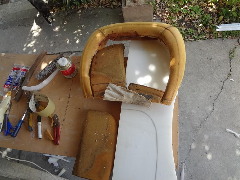

Repaired and covered seats.
Panels on, new door handles.

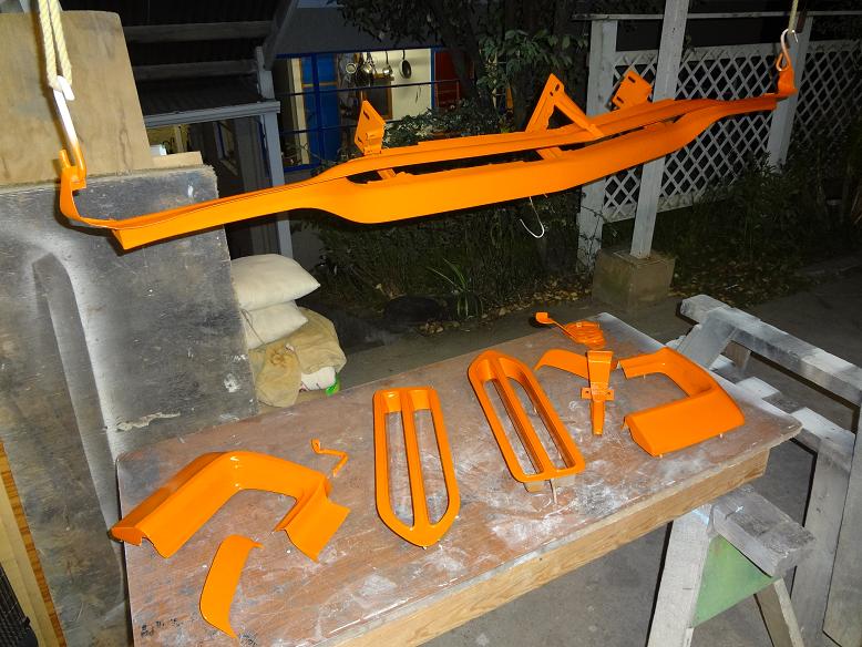

Painted last couple of bits on thurs.

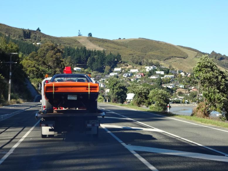

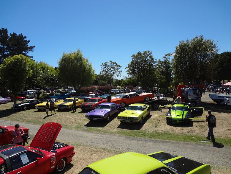

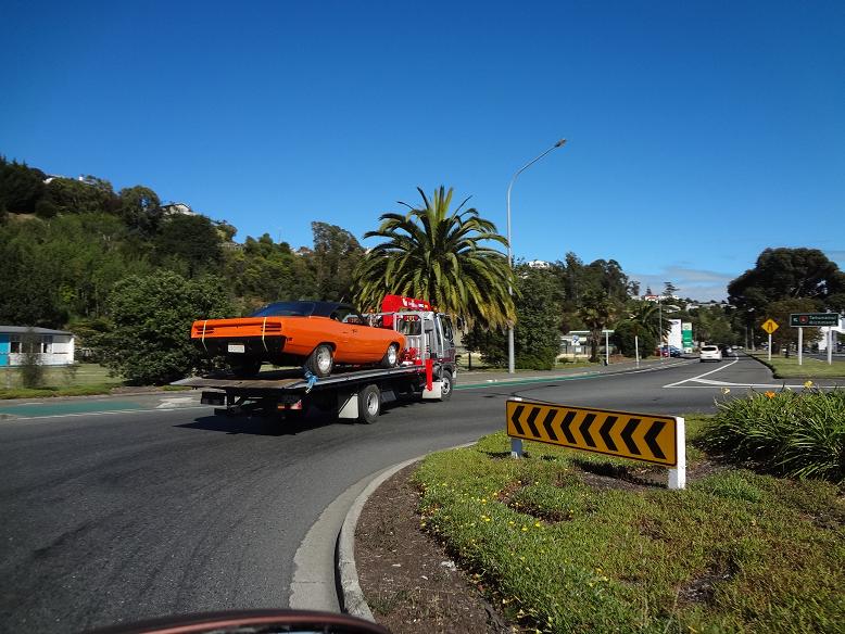

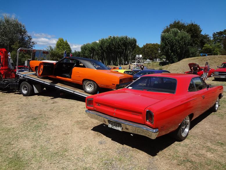

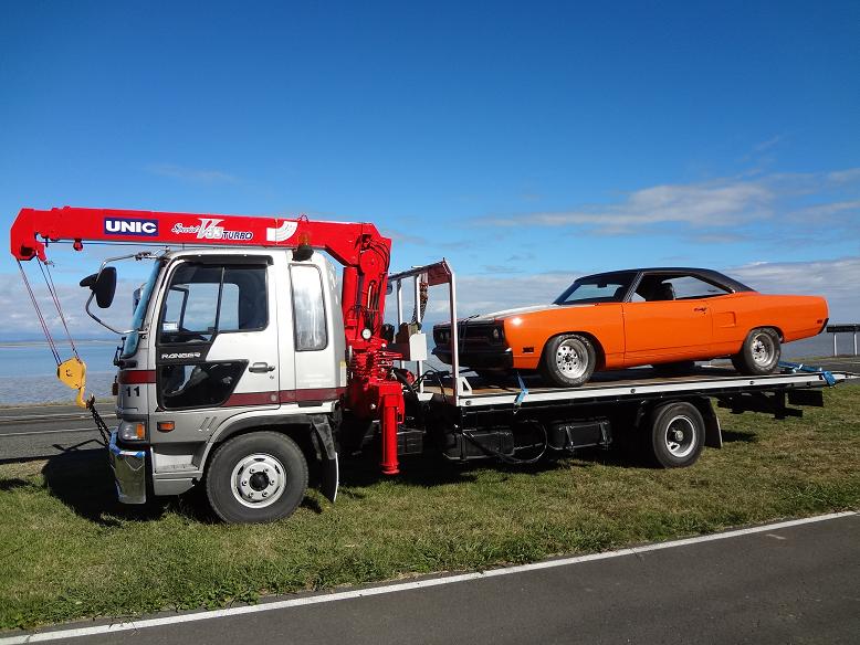

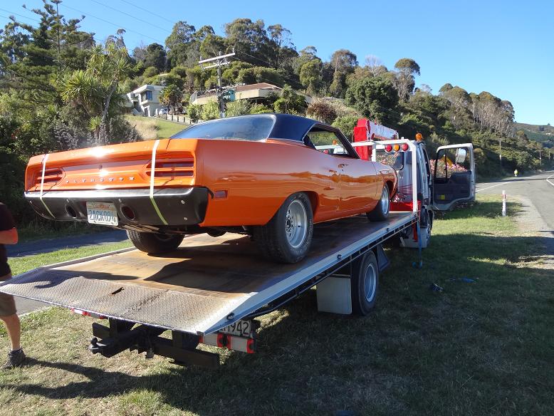

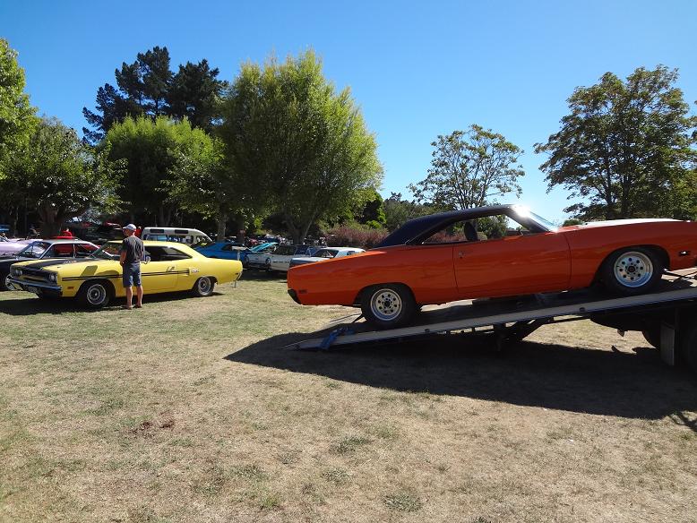

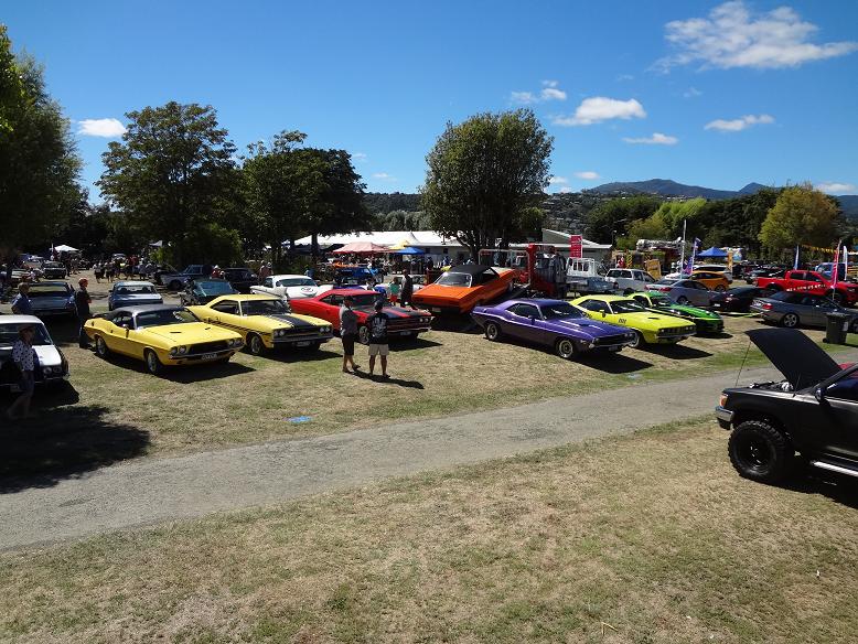

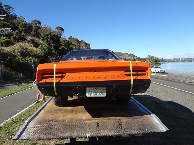

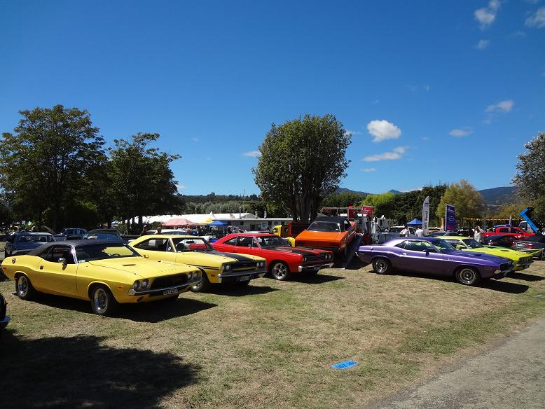

Put some 1pm to 11pm days in . All paid off today when I transported my 70 RR to its first show . My home town of 45,000 has 1 show over summer. Took my 73 Challenger on Saturday, ran into the guy whom I brought my RR from and he offered to come out with his truck and take the RR in on Sunday. Was way better than a trailer. Was a great turn out of American mopars and we were able to park together. We decided to leave it on the truck bed of effect and it paid off when I WON the trophy for best Restoration project.
Lot of the bits on my car look secure but a only held in place with half number of required fastners..
Will take a couple of dats off and then final push to get it legal on the road.

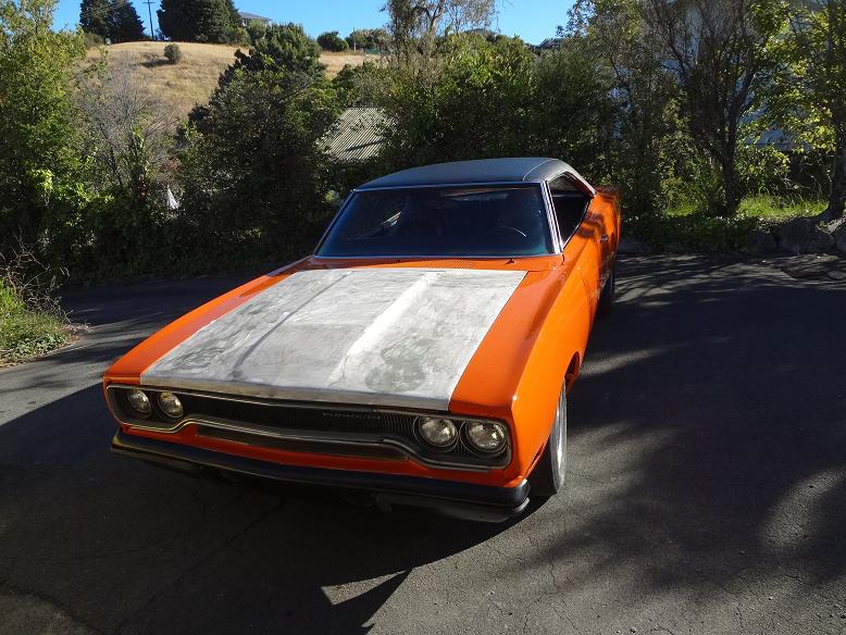

Bumpers will stay black until I can import a new pair. Hood shin has been media blasted, epoxyed , 1st fill and guide coated.

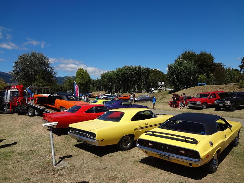

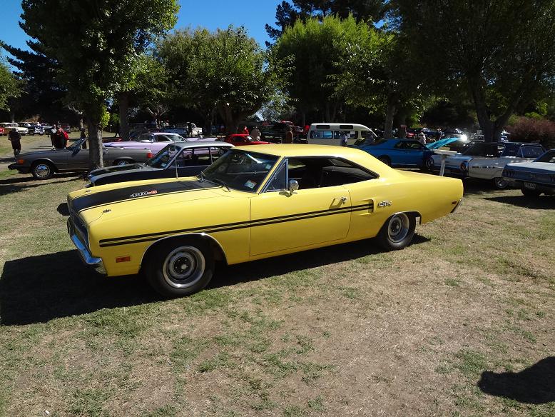

Car line up - my 73 challenger/ 70 Gtx from town over the hill ( 440 sixpack,dana 60, airgrabber, 4 speed pistol grip) / friends dads 68 RR and his 70 challenger / 73 cuda ( I brought my RR off him when he brought a restored 70 RR) / another friends ACR Viper (also owns a 70 r/t challenger)

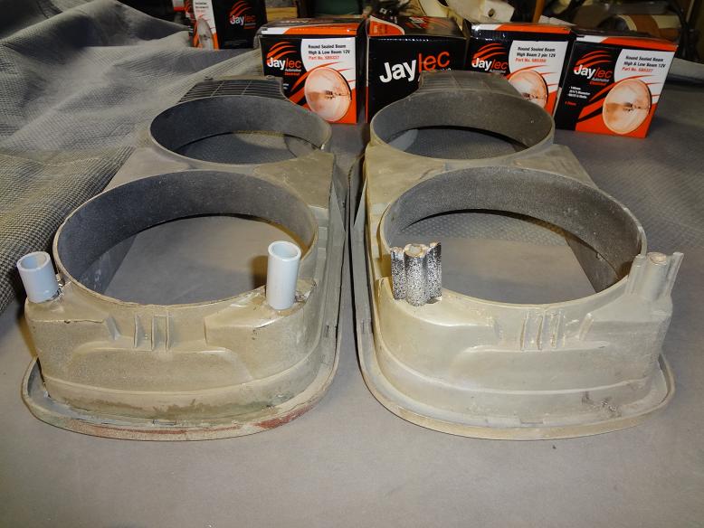

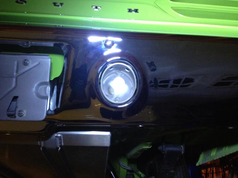

Made some repairs to front light buckets.

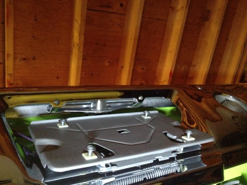

Rear light bracket does not match bumper holes ?

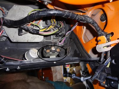

Circled it gets real hot when car is running. What is this and should it get hot ?

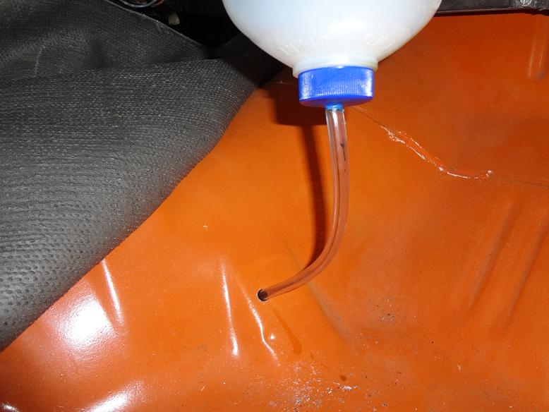

Drill a hole in floor pan so I could refill the gearbox , will rubber bung the hole.

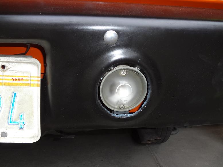

Does the rear bumper reverse lights have a insert to fill in the gap between the light and the bumper ?

OK, here we go:
1) Rear license plate bracket: It won't fit because it is wrong for your car. I will try to get a picture of the correct unit.
2) Circled item: That is your horn relay. It should not get hot, so something is not right with your horn or horn circuit. I would unplug it until you get the horn sorted out.

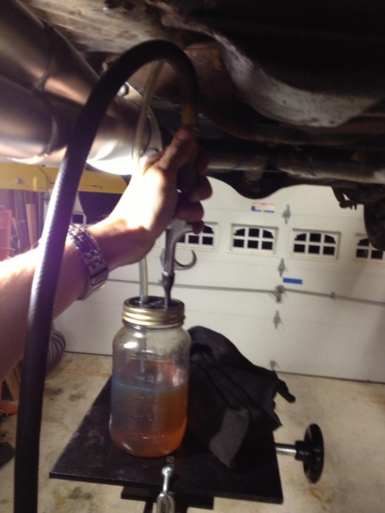

3) Gearbox: LOL. OK you're done, and that's one way to solve the problem! Other way is to get a jar with two holes in it, fill it with fluid, and put a hose in one hole to the plug, and compressed air on the other hole. The compressed air will force the gear oil up into the transmission.
4) Do the reverse lights have a filler? Answer: No. The tabs in your bumper should be bent so the lights are centered in the opening. That's it!

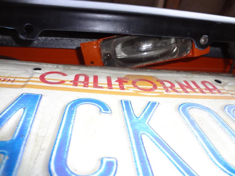

I thought I had a spare, but couldn't find it. I took a picture of the one on my car, but it is a bit hard to see and it is -11 C (12 F) in my garage - too cold to take anything apart.
Here is a picture of the light assembly:
Here is the reverse light:
None of these are great pictures, but hopefully they help...
Good Luck!
Hawk
Bugger. After seeing your pic Hawk, I only just realised that I'm missing my licence plate light. Didn't even think to check for it. :eusa_doh:
Cheers Hawk,
Pictures are great. Am sure that was the bumper light that came off the car. My bumper was very rusty so the area around the reverse light must have rusted away.
The light looks completely wrong. The light fixture should be a round, clear dome. On my picture, it looks a bit silver, but it is clear plastic. I am sure you can adapt that light or something else until you can get a correct one.

Will make an adaption plate for light.
Reason horn relay was hot was that the horn was constantly on, have fixed this.

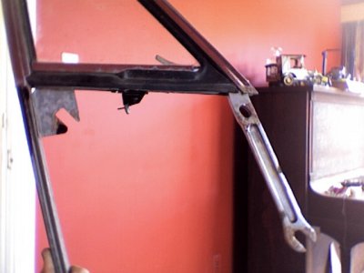

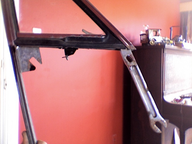

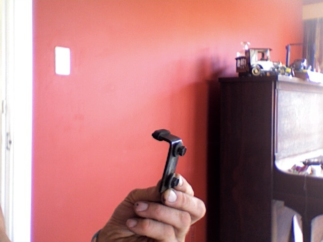

door vent glass frame
Am stuck / can't remember and have no photo of, how is the vent glass frame secured. Have a bolt in front top corner but what about top back ? (nut and bolt? ), and bottom front ?
Bracket in 2nd photo I assume is a glass stopped to limit how far window goes up and down but where does it go ?
Help,
Thanks Tony
