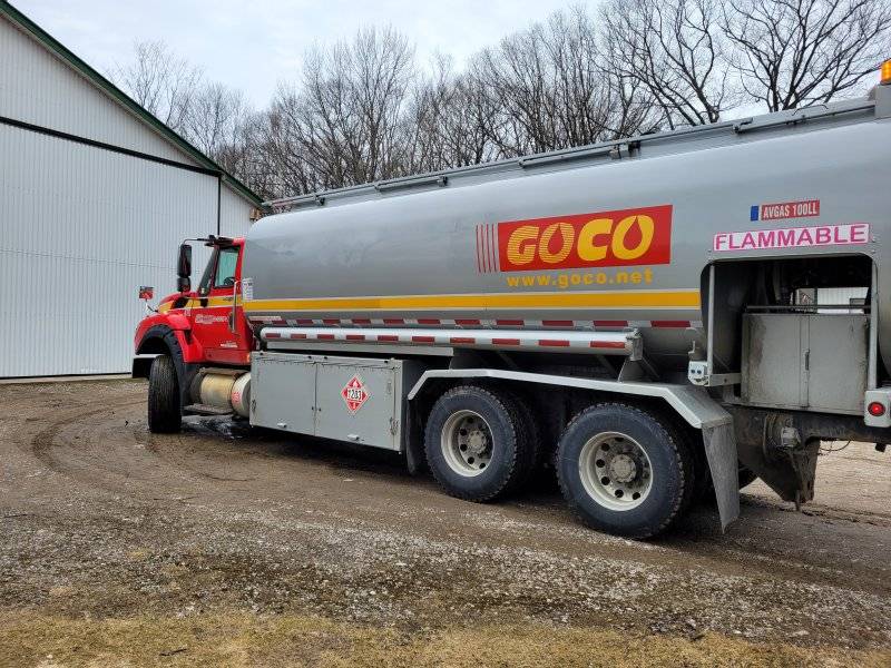

When combusted, the manganese salts melt and coat the plug insulator and electrodes, inhibiting the flame front and incomplete combustion resulting in low output. Since you probably do not have catalytic converters, run a high octane unleaded or low lead ave gas. Just my opinion of course.
