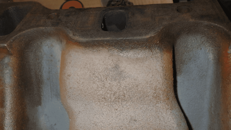

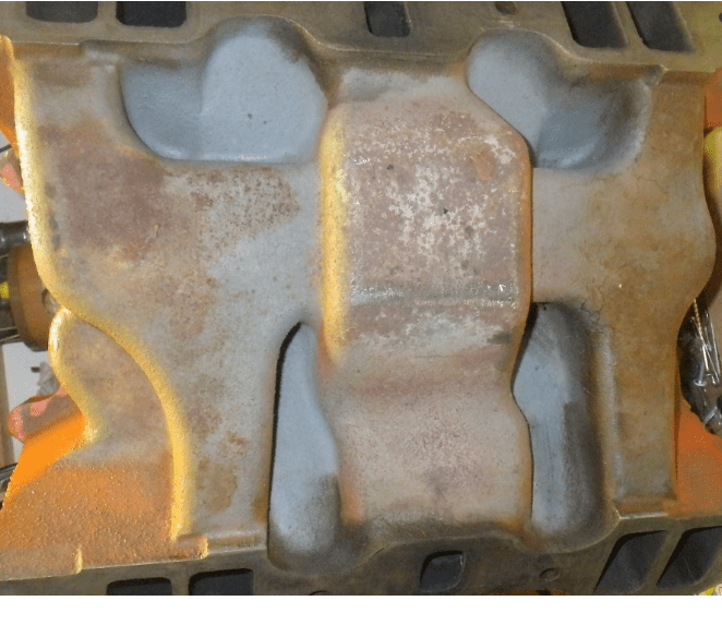

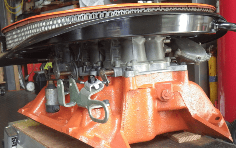

A few weeks ago I pulled my cast six pack off. Had a small puddle on the pan. Port areas were dry but the crossovers had some oil. Sorry, I wiped it dry before these pictures were taken, but I do believe that's where my puddle came from. I'm thinking head gasket design, the part that hangs off the block below the crossover, tends to hold oil and can contribute.
FWIW, I did not seal the bolt holes.
Lol, a little clean up and fresh paint for the 50 yo.
