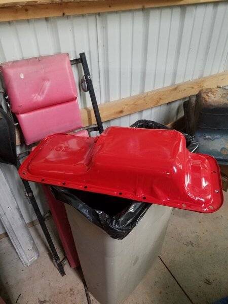

Up date on the oil pan I got. When putting the motor in today. The pan was hitting the center link. Got about and inch of clearance between the pan and center link. Hope when I get the trans. in and setting on cross member it will be a little higher. Will let you know.
got some progress on mine, went with 402 pan ,Chrysler red couldn't put an orange engine in a red car nope
What motor mount biscuits did you use? Some of the new ones aren't as thick as the originals which will lower the motor a bit.
