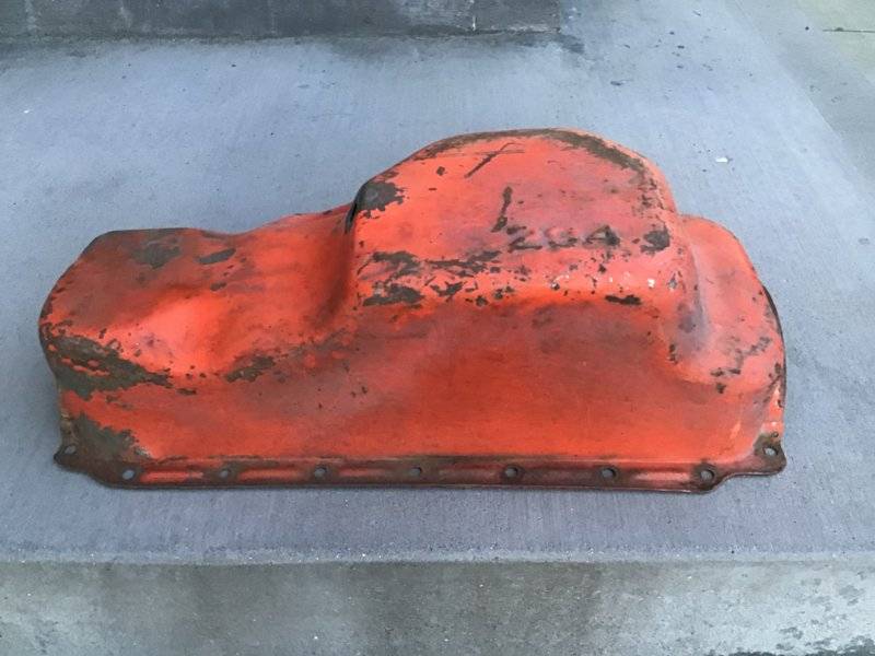

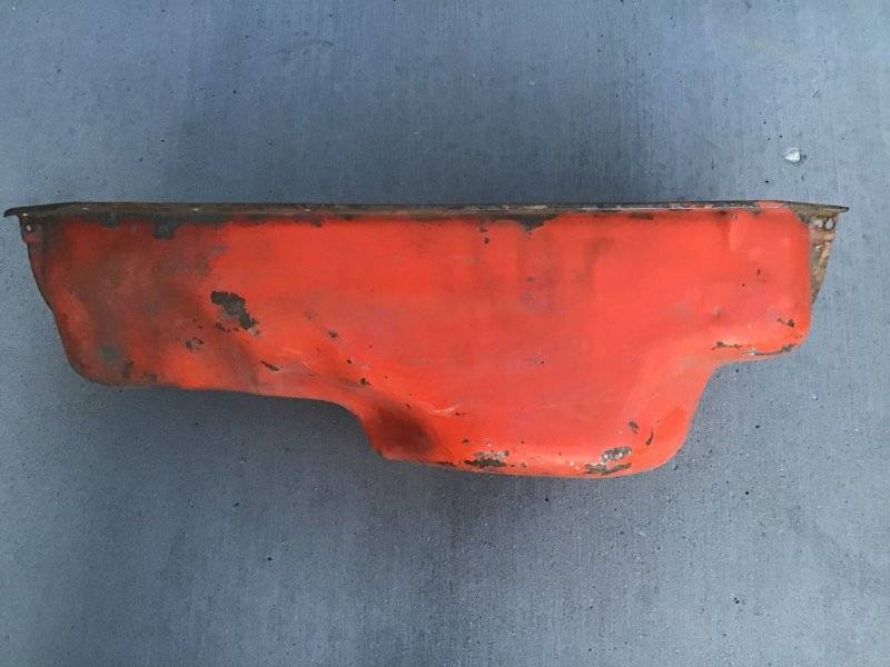

This is a SB mopar car oil pan, front is on the right side. This is what will clear everything on your frame suspension and steering. Compare this to your truck pan. Anything else and you will be cutting and modifying.

You will also need the matching pickup pipe to go with the appropriate pan, and the correct dip stick.
And it has to be a 360 pan, 273,318, and 340s have different shape, front and rear at timing chain cover and rear main.
This is totally correct from 33 IMP.... I personally would try to get an original pan from a 360 in a late model B body, like Cordoba, Mirada, etc. The number is a 392 and will be stamped in the bottom of the pan. I have found a few in the salvage yards. Good luck on your search!

I put a 360 from a 75 Coronet into my 78 pickup. Had to change the pan and pickup. The truck pan will hit the K member in your B body. I dont have the 75 pan anymore. It is probably exactly why you would need.
