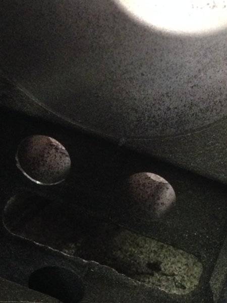

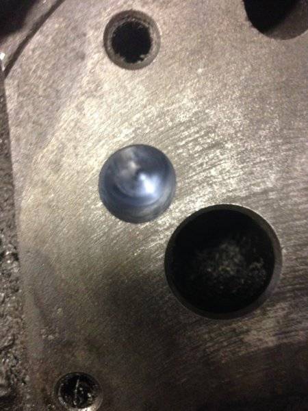

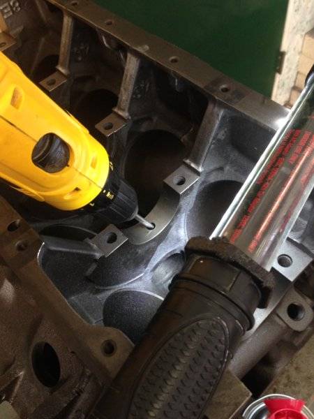

Some of this stuff may be overkill for a basic 383. for some of us it’s standard fare on any build. He’s a few pics of some of the stuff the guys are talking about. This is some of the prep I normally do. Attention to detail makes all the difference in the world. I rarely bolt anything together out of the box, everything can use some massaging.
Flat tappet cam, espically pay extra attention to the lifter bores.

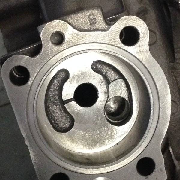

I spend some time on the oil passages with a grinder, 1/2 pickup is usually a given for myself. Pumps need work too.
Main oil feeds
Cylinder bore chamfer on bottom

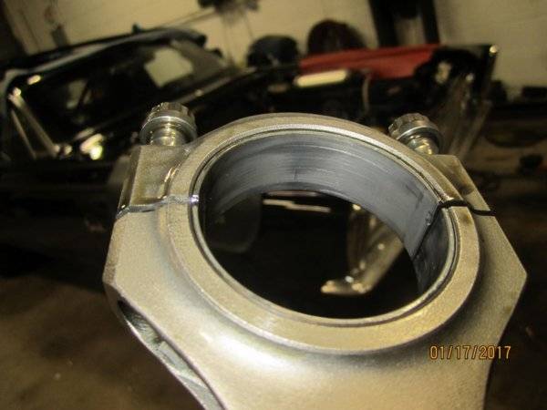

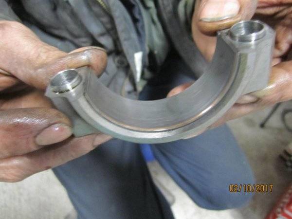

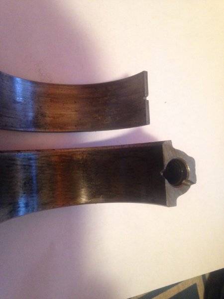

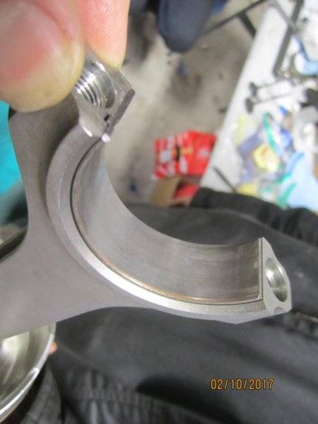

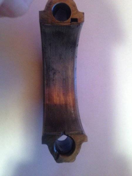

Thanks for all the reply's this is a lot of information to work with. I have another question related to
rod bearing oiling ,the rod caps have a groove cut in them and it looks like it was done by hand with a cutoff wheel or something like that. The bearings had a small notch cut in them too. I bought the same
bearings (CB-527P-10) that were originally in there and they do not have a notch in them. Do I need to cut a notch in the new bearings to match the groove? What is the purpose of the groove?
I also will be using a .528 purple shaft cam mechanical lift. I have read a few different things to depending on what type of cam and lifters you are running. Is there anything specific that needs to be done to run this cam? I am not new to building engines but, this is my first Mopar engine build and I don't want to miss anything.
I'm pretty sure that groove is for cylinder wall oiling. When the oil hole in the crank journal comes around and lines up with that groove, oil under pressure shoots out of there past the rod bolt and hits the cyl wall, or whatever it happens to be lined up with at that point of rotation. Not sure why that is needed, as oil is continuously being thrown off the rod journal as the motor spins.

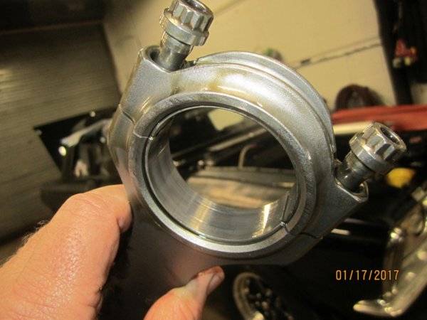

The notch in the cap locates the bearing that has a tang that fits in the notch.
How will you be measuring bearing clearance?
if you look opposite side of the bearing tang you can see groove in the cap and bearing.
I will mike and use plastigauge to determine bearing clearance.
