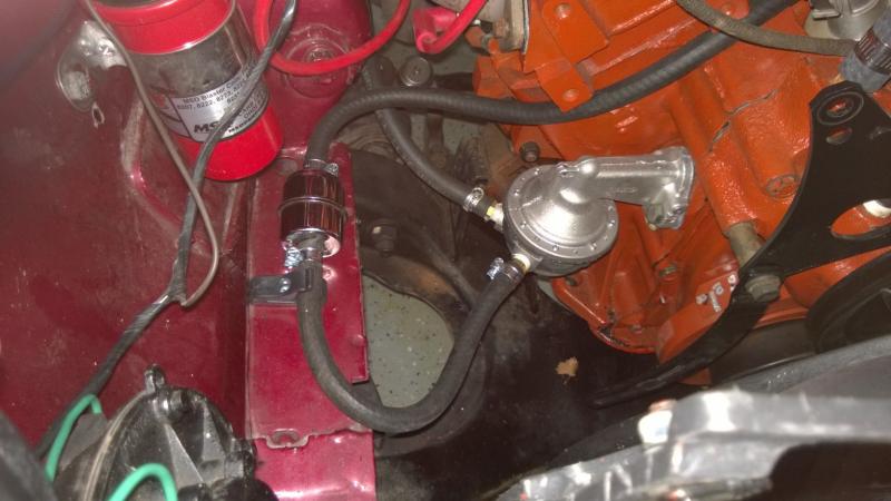

Update #4bazillion:
Got some nice clamps like JB showed/linked to and put the whole she-bang back together, locating the fuel filter for (supposedly) easier future servicing:
The local parts store refers to these as "fuel injection clamps". Eh, whatever, they're rounded over on the edges so they won't cut into the fuel line and the method of clamping is far superior to worm drive clamps we all are used to.
Got it fired up, checked for leaks and had the wife hold the speed at around 3400RPM once it got warmed up.
I again set the timing by ear for smoothest running at that speed, adjusted idle to around 800RPM and we set off for a test run...
I noticed right away it held an idle from cold, even with no choke, for the first time ever. Usually I got to stay with it for a couple minutes until it gets some heat in it. Not this time - it held idle almost from the get-go.
(Remember, at this point I'm looking for ANY progress, so maybe this is a bit silly to most folks, but...)

Progress yeah! Looks like a carb issue now floats adjusted to spec? Fuel level half way up site glass? I'll let the carb guys take it from here since I'm just the electrical dude:) glad to see progress though :)
Yep, when I had the carb off, I spit-shined everything, blew out all the orifices and checked float levels again (using drill bit method).
I don't know whether some garbage got up in there or if the new fuel pump simply overpowered the needle/seat? A good old-fashioned beating took care of whatever it was. Do I remember correctly that they make other needle/seat/floats for these that resist the urge to do this, though?

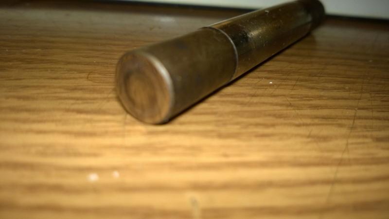

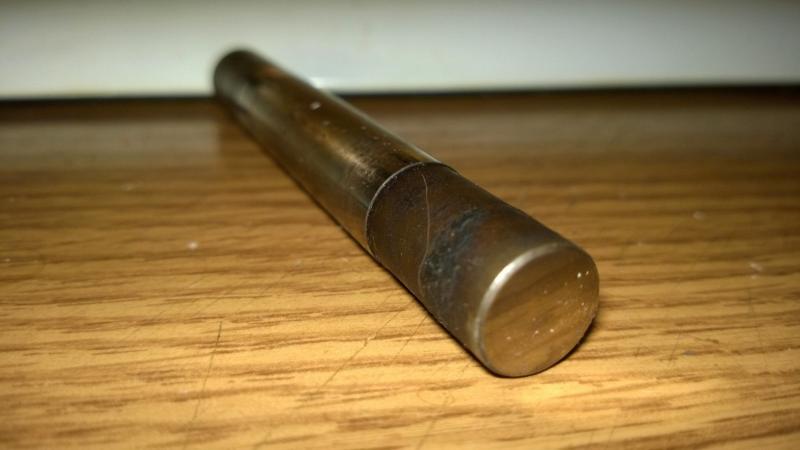

Oh, here's a couple pics of the fuel pump pushrod I replaced. You can clearly see why they recommend to do so:
Notice the hardened end metal has been worn off the one end and there's an actual wear groove dug into the other end? It does actually measure slightly shorter than spec, around .1 inch shorter. Not much, but enough to make a slight difference in pump stroke.
