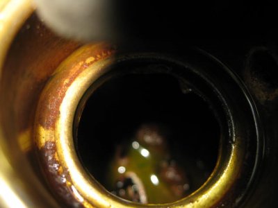

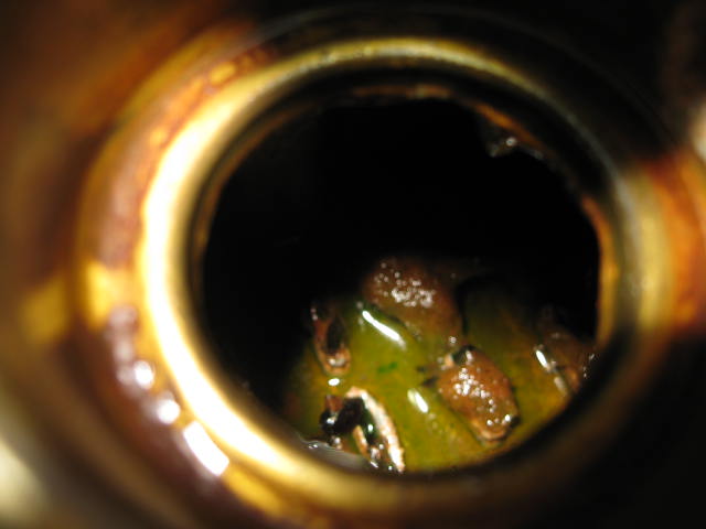

Yep! I believe I am going to do exactly that coloradodave this is what I found in my radiator along with no thermastat in the water pump. I would have thought the machine shop would have put one in but nope none in it I will install a 180 or 195 degree. franfs car 207.jpg

Looks like a chemistry lab experiment gone bad...anything growing in there?
I can't believe I did not see all that Insulation and seed crap mice stuck in there. I prpbably would have been surprized if I Initialy stuck a small mirror In before I Inastalled the radiator. Going to get it dipped,cleanedand pressurized today.
