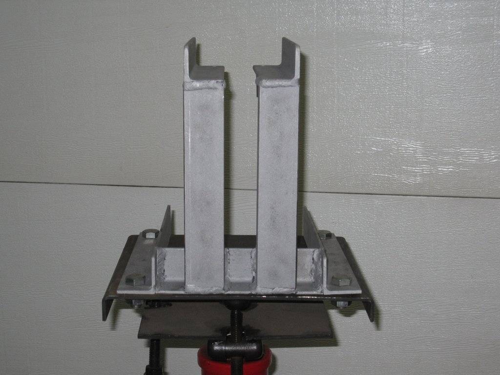

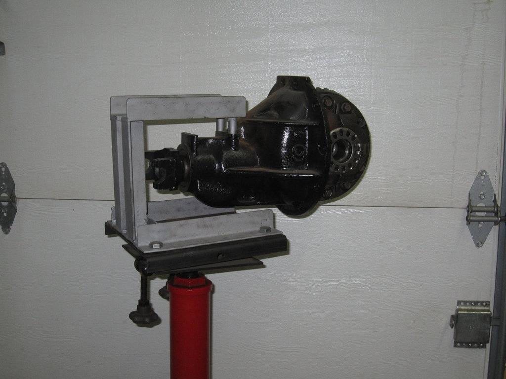

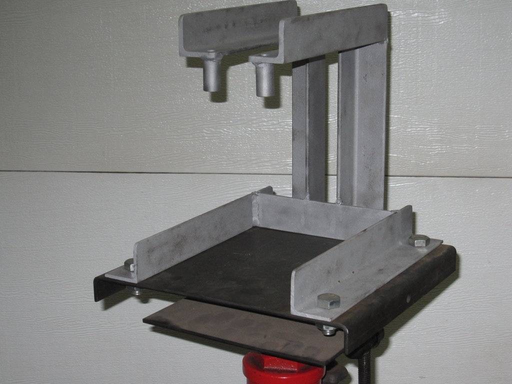

After losing both upper bicep muscle attachments and having both rotator cuffs repaired I'm not the man I used to be, so when I needed to pull my 8 3/4 pig I whipped this up:
60" of 1 1/2"X 3/16" angle iron and an afternoon.
Mike

20 years ago I started using a floor jack to remove and install those bastids! The saddle on the jack is important if you don't want it to fall off but your rig looks very nice.

After losing both upper bicep muscle attachments and having both rotator cuffs repaired I'm not the man I used to be, so when I needed to pull my 8 3/4 pig I whipped this up:View attachment 491215 View attachment 491216 View attachment 491217
Mike
