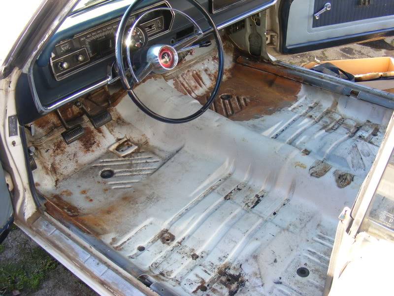

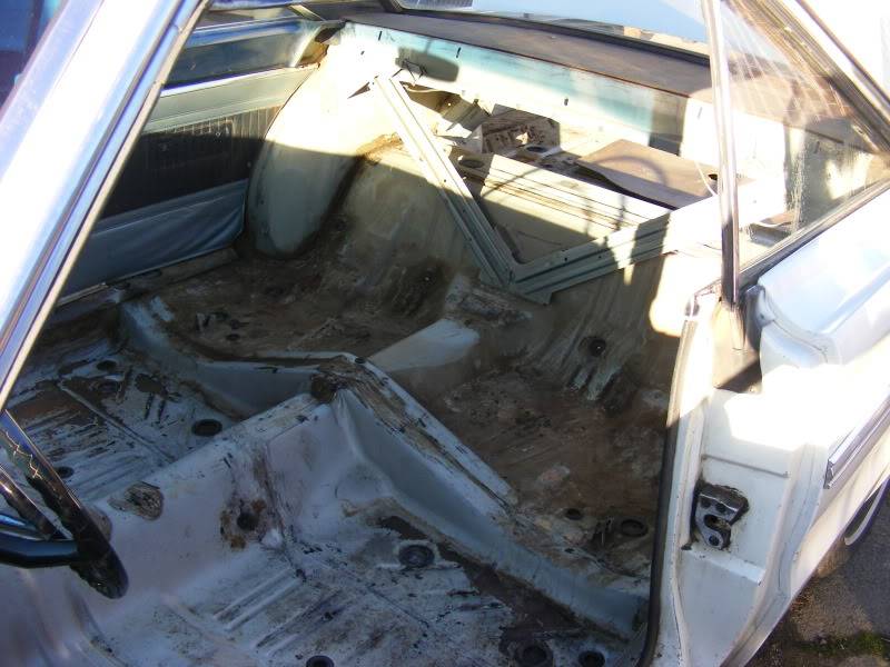

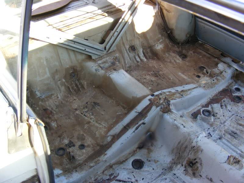

After i left it out in the rain for a month :eusa_naughty: i found the carpeting SOAKING with water, grass and mold was growing out of the carpet! I tore into the interior fearing the worse, but found 100% solid floor boards with only minor surface rust, there are no holes or thin spots at all.

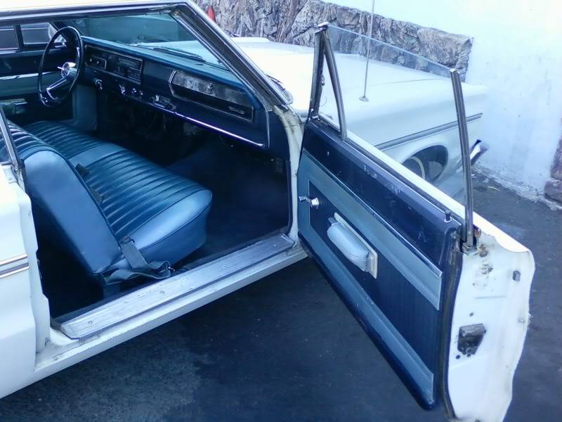

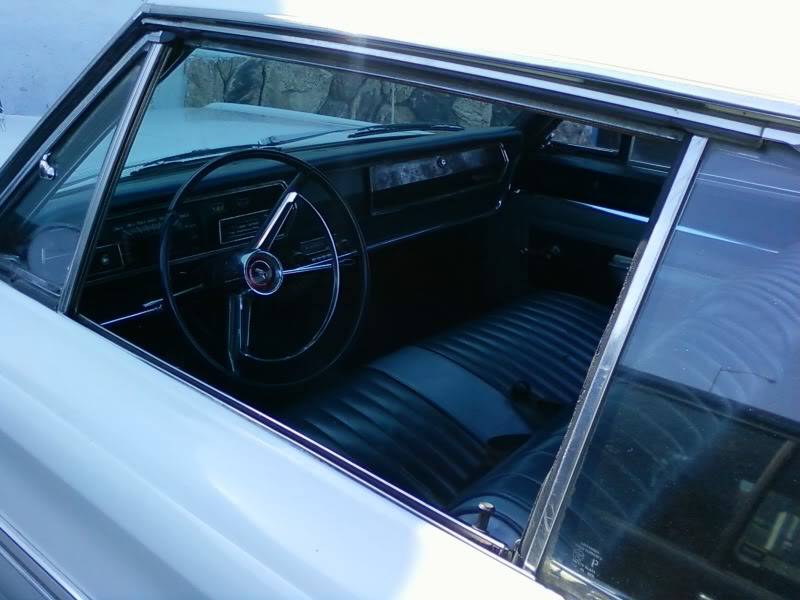

Heres how the interior was before

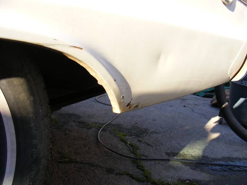

Little bit of rust in the rear right 1/4, only thru rust on the car.

Dude, that thing is cherry! Does it have the leaning tower of power? I see 3 on the tree. Here's what I would do if it were mine assuming the direction is to make a nice driver out of it with minimal $$
Check and clean all wiring connections, especially the bulkhead. All grounds, etc..
Reseal the front and rear glass and other known leak points.
Check/replace brakes and running gear. 11" drums and a dual MC conversion are an easy swap or you can go with late model discs. BJ's compatible with 11" drums will be required for the drum swap. My 66 Bel has 11" drums that I put on.
Probably needs lower BJ's or maybe a front end rebuild anyway.
Window regulators may need attention.
Cooling system.
For the rust spots you can just treat the area with rust converter and use an epoxy based filler or even glass reinforced bondo. It's not like you have major Swiss cheese going on. After the repair you MUST seal the other side with something or it will rust through again. I suggest the oily waxy goo from Eastwood. If you can see the back side of the repair then you can cover with undercoating but chances are you can't so you will have to blast the goo into the crevices. Throw some white paint over the repair to keep it protected or just paint the car. It looks straight enough.

Thanks so much, yes it is the slant 6 with a 3 on the tree.... i am going to be cutting the floor up for a 4 speed. heh, im getting a drivetrain out of a 70 challenger with the 340 in exchange for building a 512 ci big block stroker.
Front end is really tight, and i am going to dual circuit brakes. How tough is it to reseal the front and rear glass? The front window regulators are good, but the rear regulators are very stiff. I live in Orinda and my shop is in Vallejo.

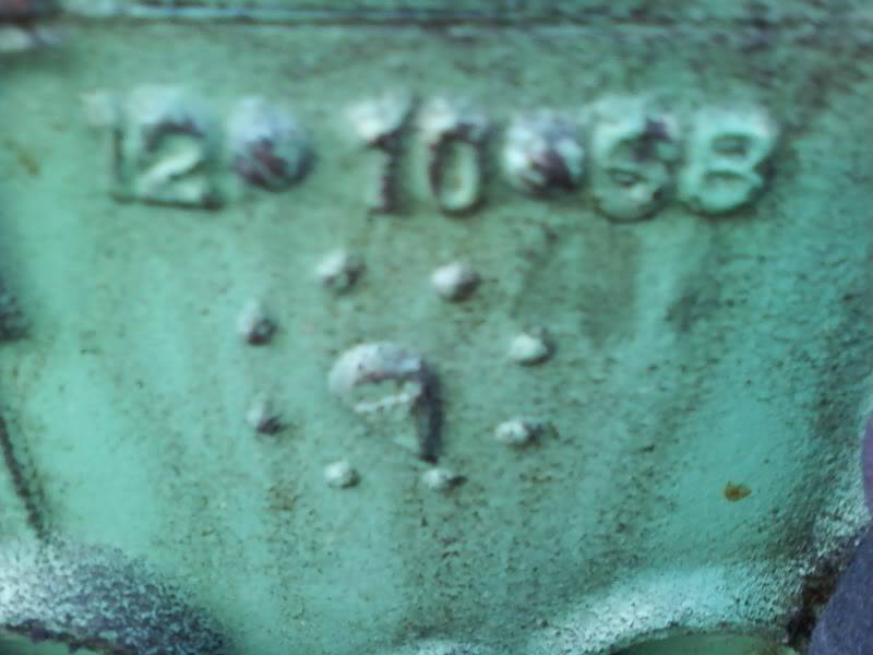

Well well well... looks like i have my engine.
Here's what i tore it out of
This is gonna be a fun engine in the belvy.

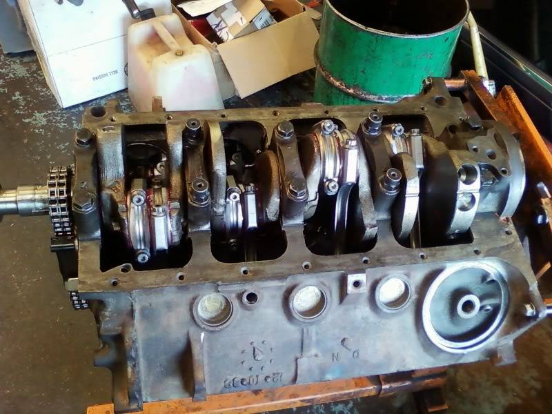

Maybe i should update this thread... I ended up completely rebuilding the 340, its now a 350ci solid roller, h beams, keith black hypers, about 10.5:1 compression, ported/polished j heads, harland sharp rockers... i could go on. Heres the engine in its various states.
