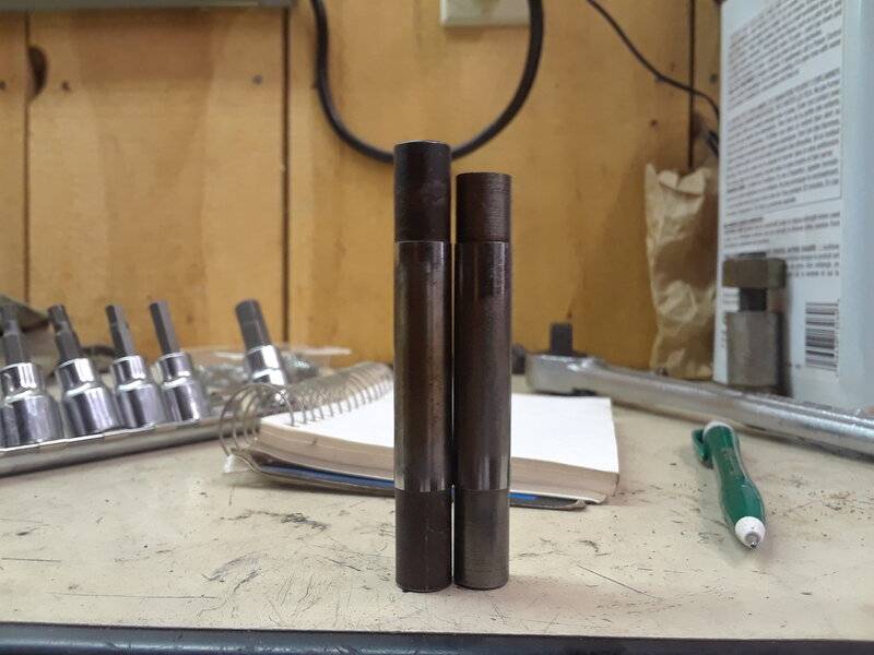

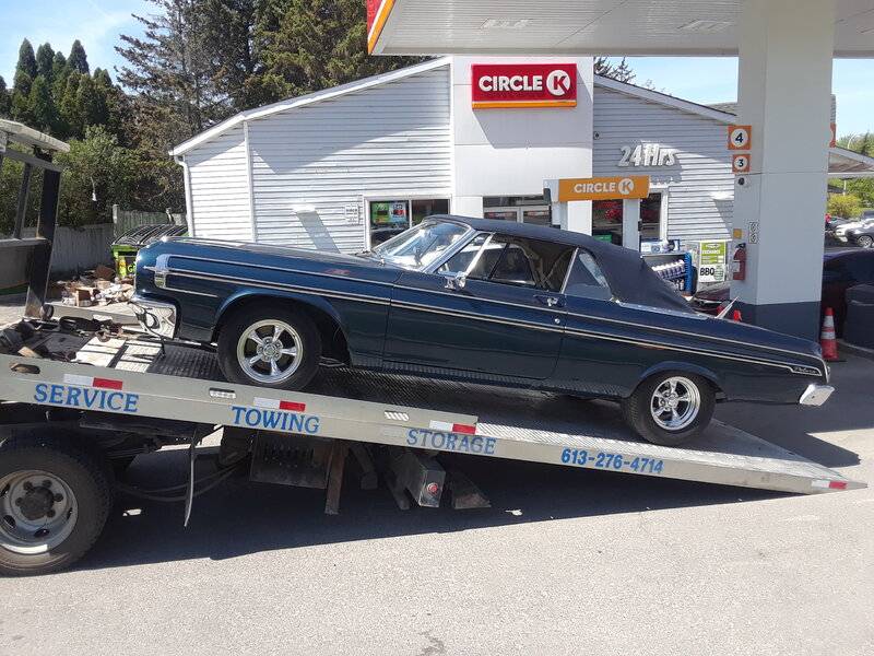

This is what happens when your fuel pump push rod goes south.

Dam that sucks but at least it wont be down long.

Holy **** Batman, that's some wear.
I assume it was original? Makes me wish I had measured mine when I changed the cam.
Speaking of cams, better the push rod than the cam.
A friend of mine runs a metal treating business. I'll ask him his thoughts. Maybe I can start a business making reliable fuel pump pushrods.
You sound surprised, this is very typical and many many post have been made about the hardened butter fuel pump push rods. The original rods are way better. Comp Cams rods suck ***. Not sure about others but they are basically junk. Also think about what they are doing to the cam lobe when they grind down like this. I will be pulling a cam out in the next week to replace the cam and lifters on another friends car. His car has ate through 3 fuel pump rods. I will post pictures of the damage to the cam if any.
Can we harden the new ones?
