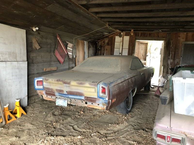

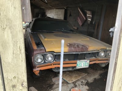

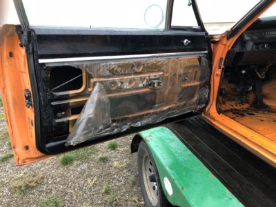

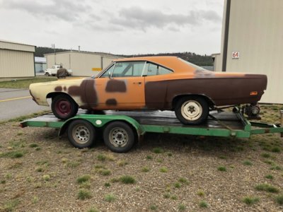

Starting on another 69 road runner build
Found this car sitting for 20 years in an old horse barn
Omaha orange 383 console automatic factory AC, disc brake, PS and tac option.

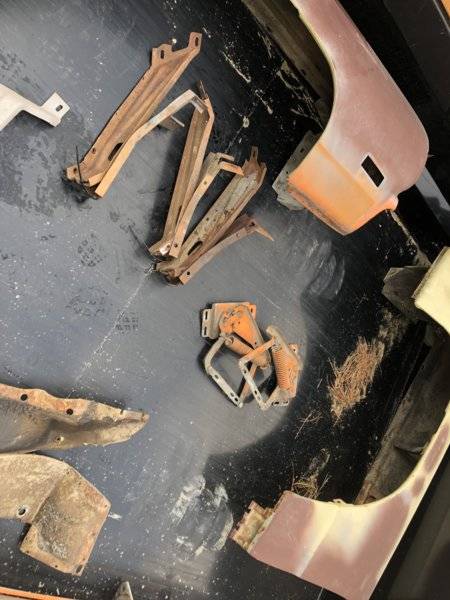

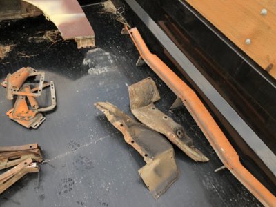

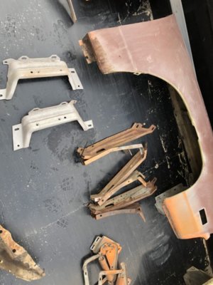

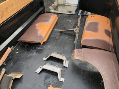

Disassembly has started first load of parts going to Blaster doors fenders brackets splash shields
3823652B-9E01-4151-A4B1-3D6D851EF742.jpeg 4437F4BF-0D34-42D3-BD11-4ADF6F87E6F4.jpeg 1F29D61D-A971-4816-A561-52482CF70E91.jpeg B67FB0E5-6AB0-47AC-8BF0-2048CF1653A1.jpeg

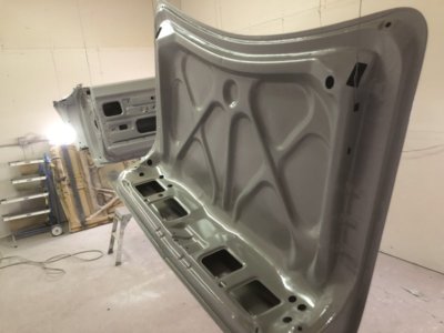

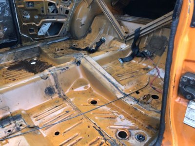

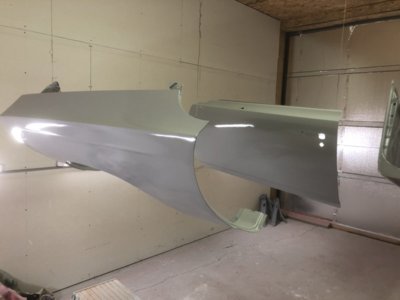

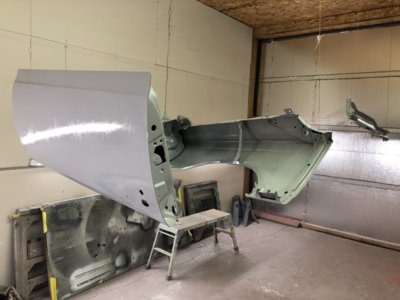

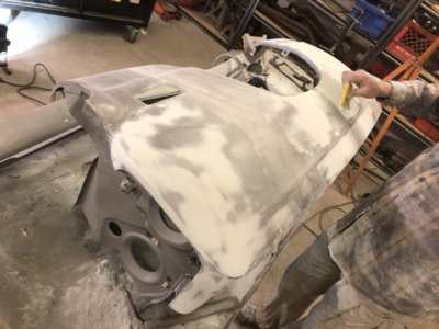

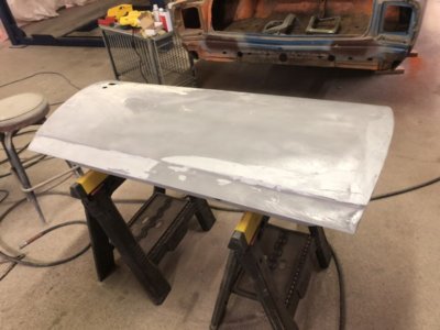

Doors and fenders and other items are back from Blaster bodywork has started. 50+ years of dings, dents and the like. Good news is there’s no rust repair required all the metal is good
4F5EF2C4-C534-4906-8368-1AFD98A88C73.jpeg 86C05940-8E8D-4E45-A3AA-2362DF41BE87.jpeg 633F0D20-486F-42D2-86B6-D8B5CDB068D2.jpeg FDFBE110-80BA-4C0F-9F3F-360753720A61.jpeg

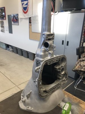

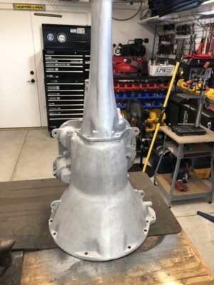

The following is some description and photos of the modifications.

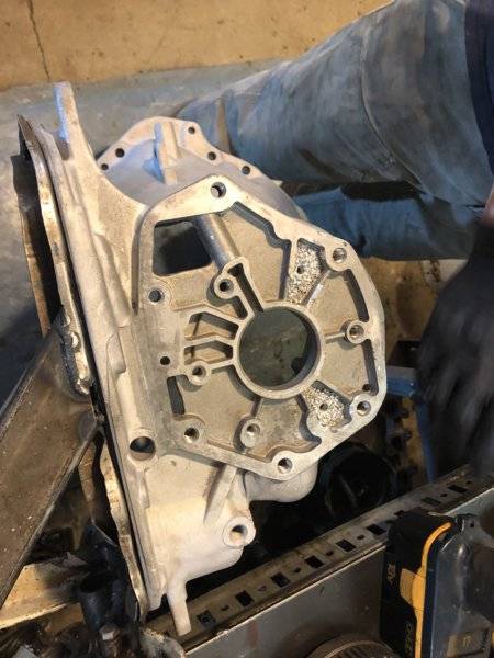

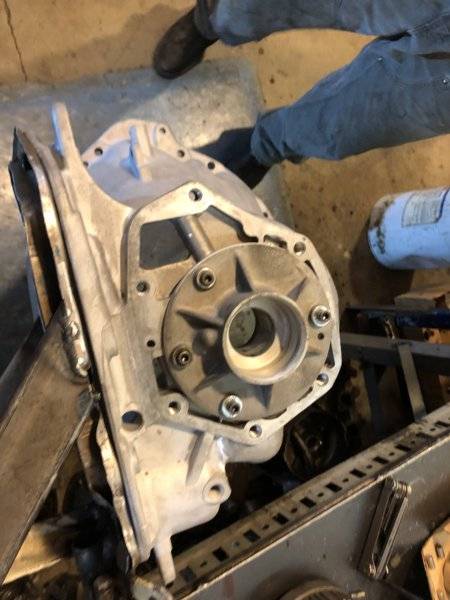

We first started by completely tearing the transmission down having the case ran through a parts washer and then glass beaded.
704D80B6-2EE5-4464-B123-0CD5E05E70CE.jpeg 81CFD17E-D11A-4C8B-972F-76ABA5FA55A7.jpeg FC925A06-3EE2-4FEE-8492-8E0ADB0D3F48.jpeg

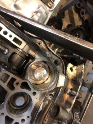

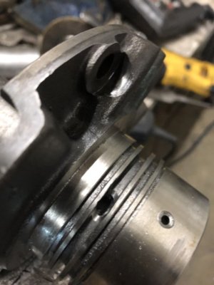

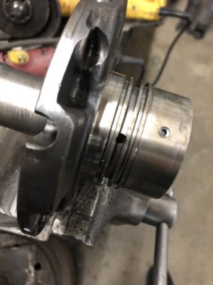

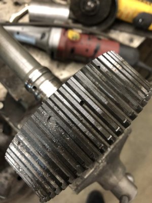

We opened up some of the fluid paths by drilling and or chamfering the holes as pictured. The chamfering process is a little touchy as you do not want to damage the land on either side. The chamfer should measure a proximately a quarter of an inch. The other holes in the spline are drilled out just to the edges of the spline itself. As I have come to understand these are minor modifications but every little bit helps.
F2E5AC9A-20C5-4E29-959F-099B76EDF66A.jpeg 0FF9A664-C368-46E2-8EB7-296020120B0C.jpeg 4508C0A8-8858-48ED-8825-85A194B79C5D.jpeg

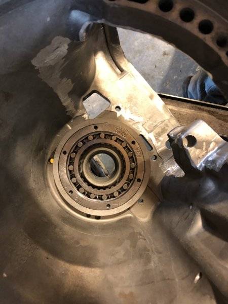

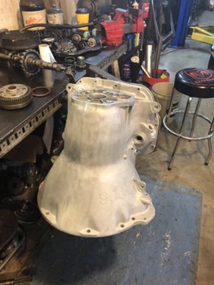

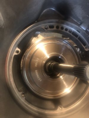

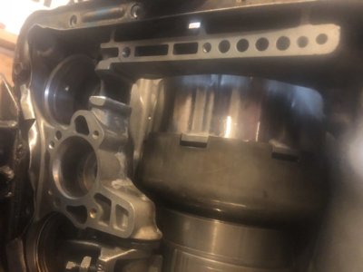

The transmission had a three pin planetary originally in it. We have swapped it out for a four pin planetary. This allows for more gear contact and engagement.
We cleaned and reused the original rear drum.
A72004C8-5713-42F5-9DC4-41B84BFE905D.jpeg C5E73D45-61F7-4C03-A561-47641ACC2B16.jpeg

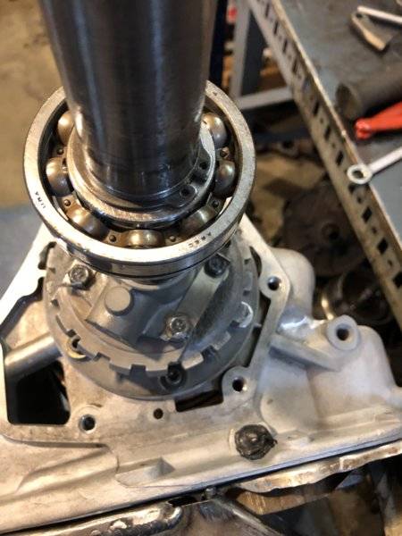

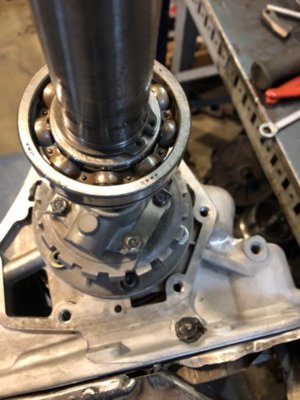

We disassembled and cleaned the tail shaft bearing and governor. We used a new governor kit supplied by Cope racing transmissions.
5FBEDCFB-1A27-4281-BDF4-F3A504164906.jpeg C5426F2A-AA63-489B-A8D5-C18D01681420.jpeg

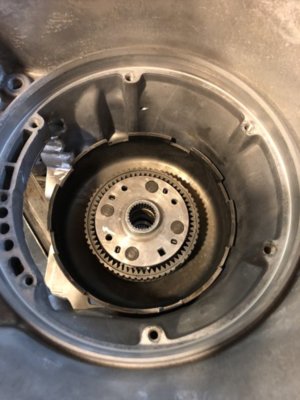

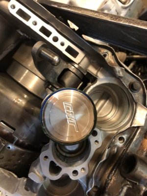

We’ve installed our billet steel front drum to replace the stock drum. This is a key safety feature also sourced from Cope racing transmissions. CRT
93D34784-F3CD-4011-953F-3D67ECD27A96.jpeg CD703B9C-2BC7-4307-B8C2-D027234270F6.jpeg B4E221DE-BAE4-4855-80B8-91AAA6FC8517.jpeg

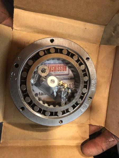

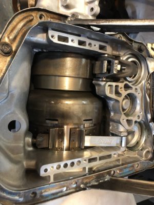

Installed a lighter servo piston. We then replaced the servo retainer and installed the band arm. You can purchase different arm ratios that allow for more band leverage depending on your needs or application. CRT supplied.
5EE4666F-302A-4530-9406-1DD90485925F.jpeg B2C7C99C-D6D0-4564-B55C-D2D54D6D042D.jpeg 05B26503-0F16-458D-B9A3-DE9CE53C7AD4.jpeg 825854F3-6284-4FCE-B275-B1F7E81B6C02.jpeg
