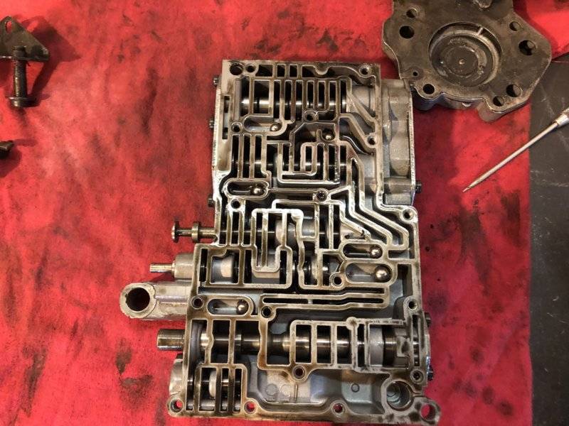

    This is where things get tricky Jed moved on to the valve body where there are several modifications needed.
    This does require very close attention to detail, as there are many fluid circuits, check balls, and orifices that need modified. The instructions provided cover these details very well. This kit was also provided to us from Cope Racing Transmissions. According to the instructions I’m going to spill my coffee

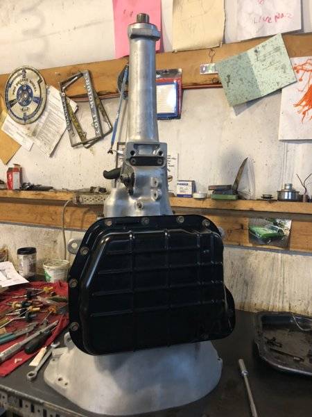

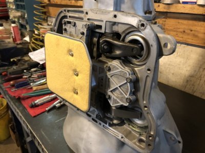

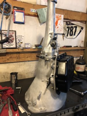

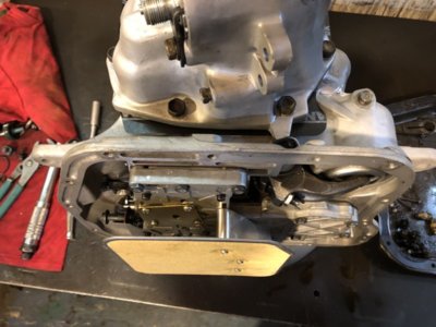

    Time to button things up
    Jed installed the valve body filter extension and filter with a new deep steel pan and molded gasket.
    The filter extension will allow the filter to remain deep in the pan where the fluid is less areation. The extra capacity will also offer some additional cooling.

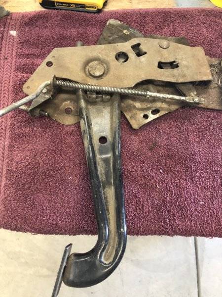

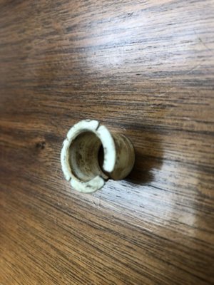

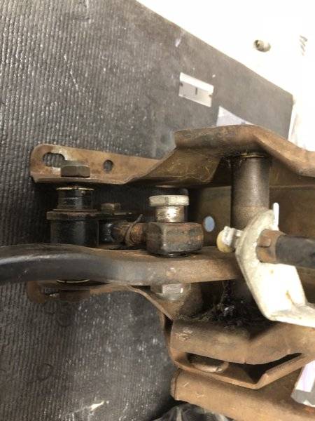

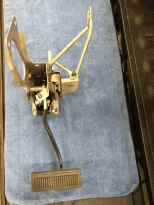

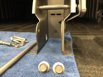

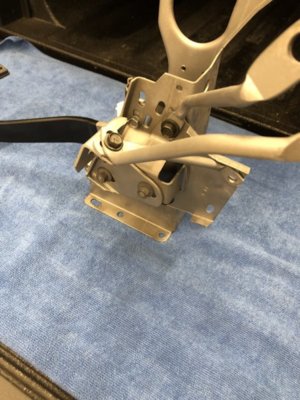

          Did some work on the brake pedal assembly. Replaced the nylon bushings cleaned and detailed brake light switch and bracket repainted brake pedal arm and replaced brake pedal pad
          EE421144-BD8B-46AA-AFF1-FEEE266D6D25.jpeg CD18297A-F0B8-4CC9-9AE1-167C6AAD5598.jpeg 0DBF0BAF-D9D1-4D13-B6C9-F0AB88564896.jpeg

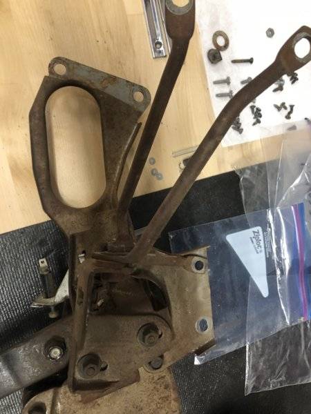

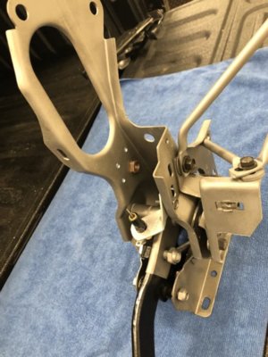

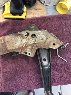

            Here are a few pictures as I completed the process. I disassembled everything and soaked it in the
            Evapo-rust. The final finish is glass beaded and clearcoated.
            8F137B9E-62D4-48A7-A310-831E8D202358.jpeg image.jpg image.jpg image.jpg image.jpg

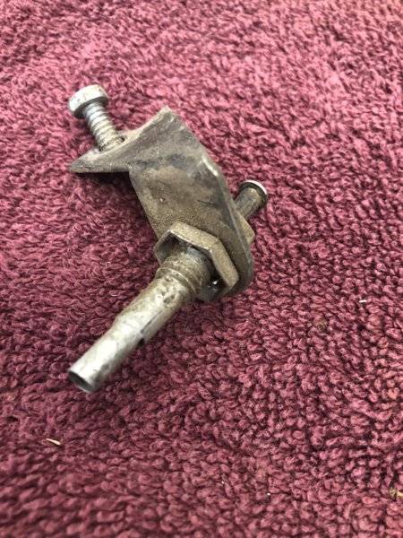

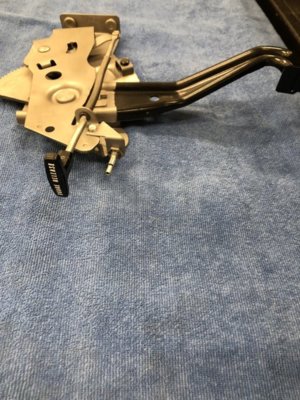

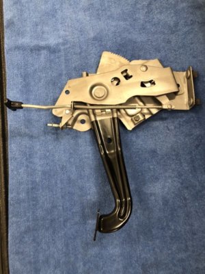

              Also similar process on the E brake.
              Soak everything in Evapo-rust. Cleaned the switch all the hardware repainted brake release
              I still need to purchase a new pedal pad and this will be complete.
              For 50-year-old plus parts the E brake and brake pedal assembly look pretty good with some elbow grease and a little detail
              0CE96FC7-F518-4765-84FF-38CB277AFF80.jpeg 1D28D399-EFFC-4E5B-9D2C-3B7650A96C2A.jpeg BAFDFC82-3314-4C2A-9DDB-70BB6C8B0781.jpeg image.jpg image.jpg

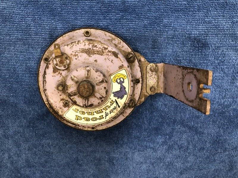

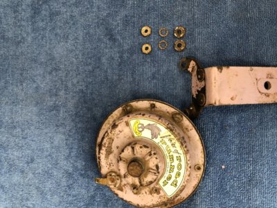

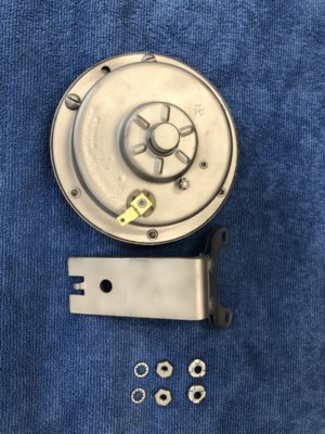

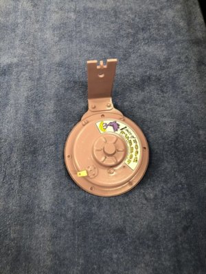

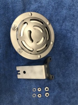

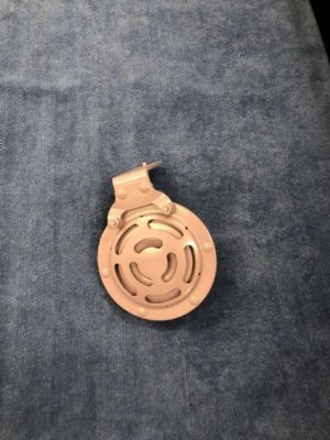

                Did some work on the horn
                It still works but sounds a little bit sick like the coyote might’ve taken a bite
                May have to replace it with an aftermarket one but for now I have a semi restored Spartan.
                I got the correct color from Totally Auto.
                407E9B0D-5879-4108-B297-7F33751F2B6A.jpeg 0F731C6D-4C38-4CAE-9D9B-E50E38C7509F.jpeg 8ADD5CA6-A609-4F66-A2C5-2DA1C69838E6.jpeg F0F4F582-6DE4-47A6-B323-E774A2DD4A30.jpeg image.jpg image.jpg

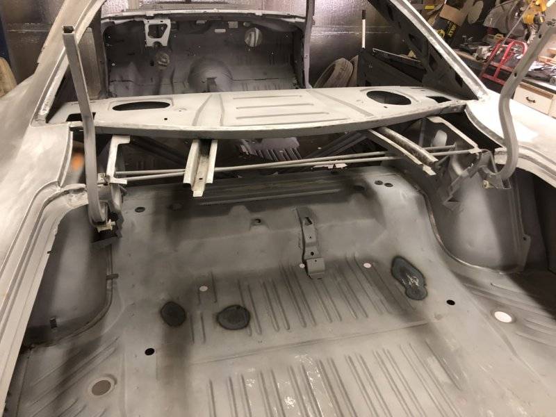

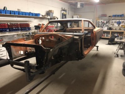

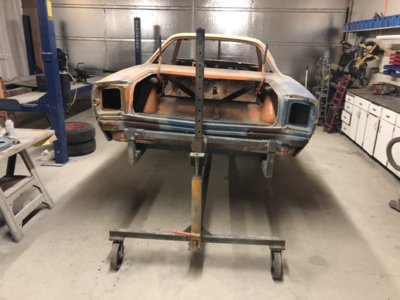

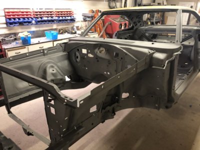

                    Got the main body on the rotisserie took it to sandblast did not have quarters or roof blasted and stripping those By hand
                    0C59F0E1-FD6F-45AC-8A8E-21599BF0354D.jpeg 19E9FD41-ADFF-49BB-895C-DCB6DD4BBBC3.jpeg EB2AF0D0-61DD-4074-90A3-813400FA7386.jpeg

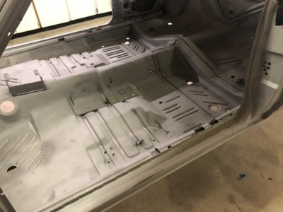

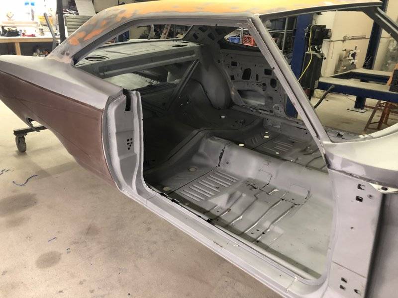

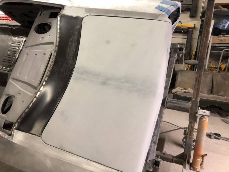

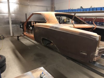

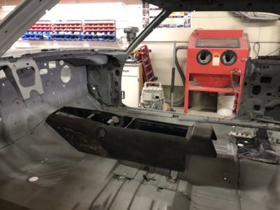

                      Back from sandblasting
                      0646E3CD-88CB-4F72-B910-EC56243552DC.jpeg 378A571C-9081-42A4-AB4E-C4BD18A3E168.jpeg FC04869D-C927-4806-921B-F4ABD70F32C4.jpeg CCBD6192-FF4A-41BE-8539-2CDEF7B20B5D.jpeg

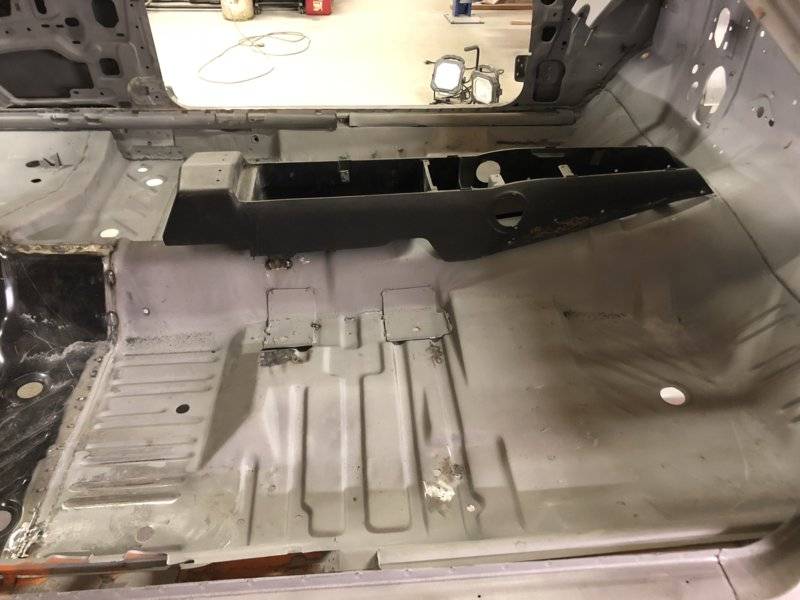

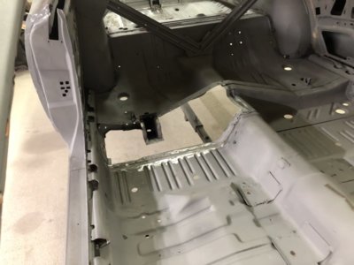

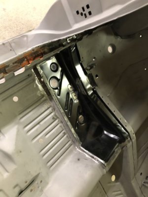

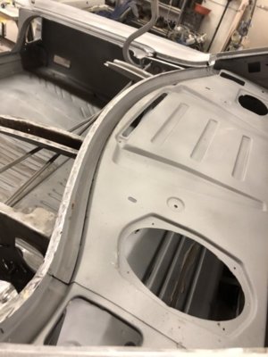

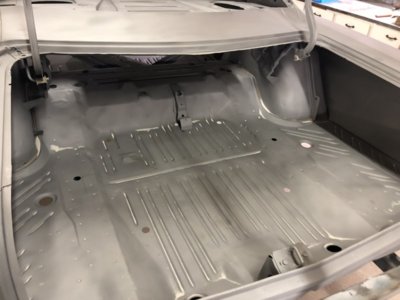

                        This car is almost rust free however as with most there are a couple areas that need replaced. Dutchman and passenger rear foot well have been removed. I have AMD replacements ordered.
                        FA4B0E17-E3F9-4964-8E92-656E925469E1.jpeg 2A8BD637-5AF6-401B-8DE8-73CC594E9734.jpeg 2B8F61B4-E8ED-4FEC-BE42-9BA555F8C325.jpeg

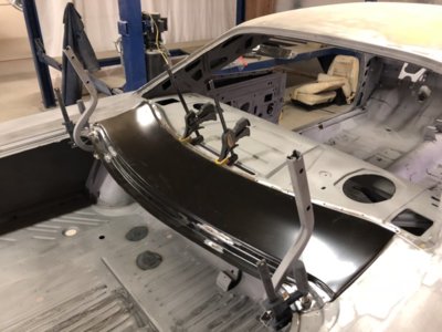

                          Starting to fit the AMD replacements

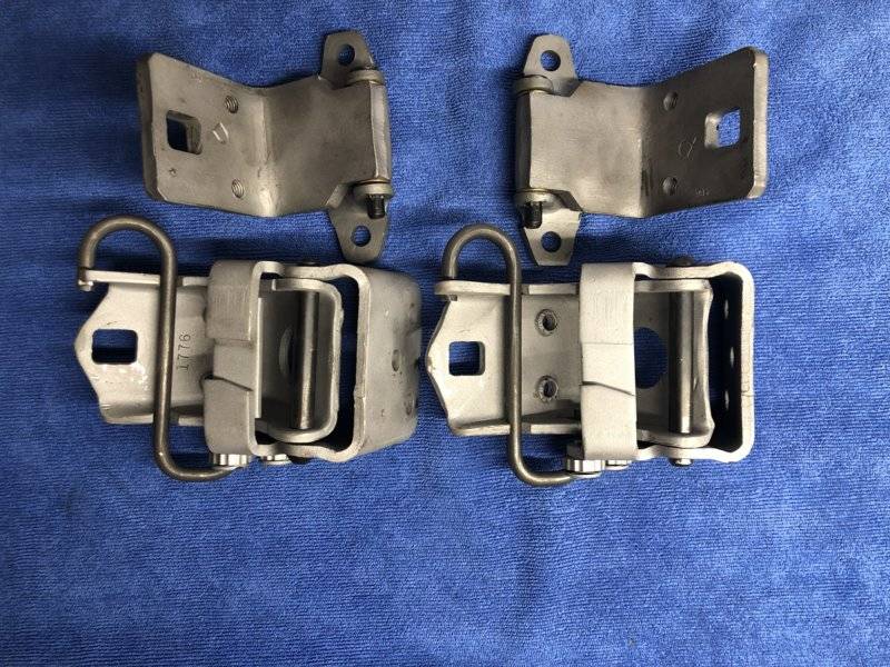

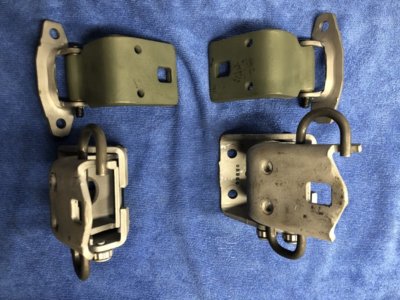

                            Rebuilding the door hinges. Ordered rebuild kits from Ricks Restorations link attached
                            Disassembled blasted reemed lower hinges for new oversized pin. Replaced spring

                              Completed installation of Dutchman and fitted trunk lid very happy with gaps and fit
