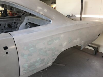

One more 69 road runner build

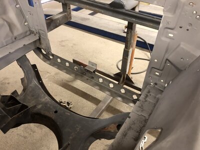

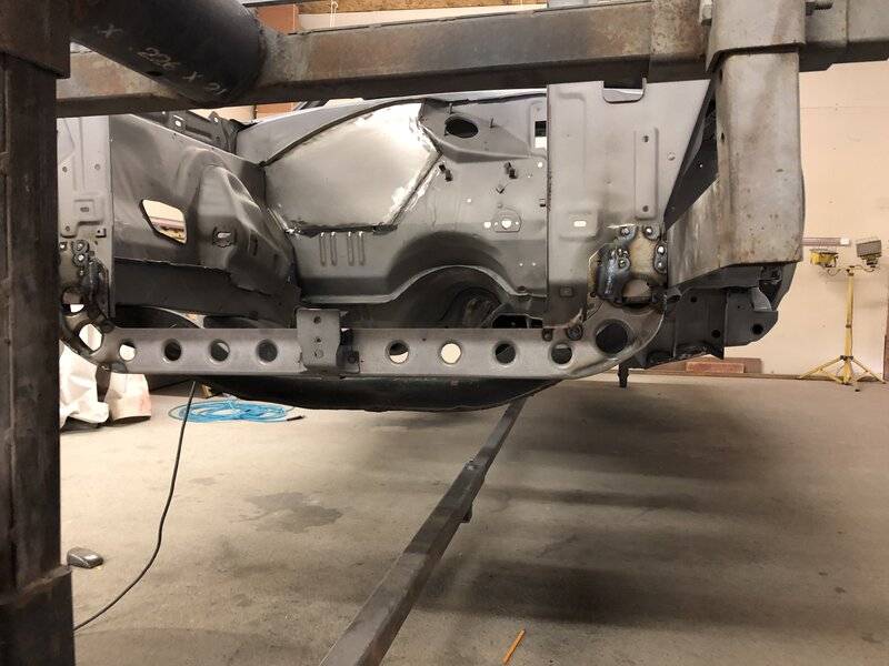

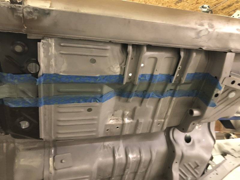

Because this car will have a stroker motor I am using US Car Tool frame ties and torque boxes. This way it will look stock appearing to the untrained eyes.

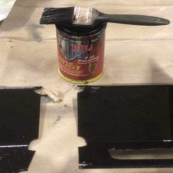

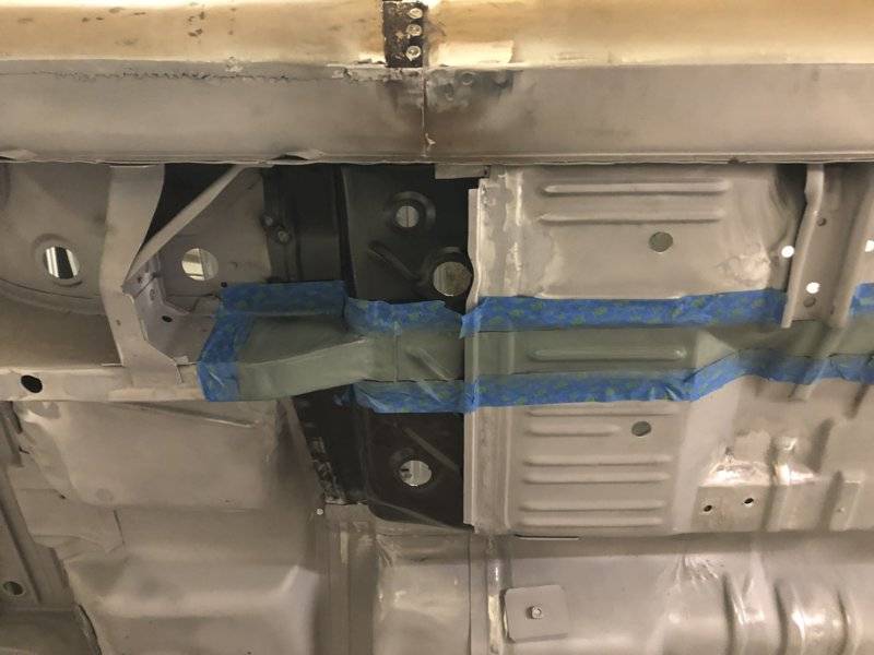

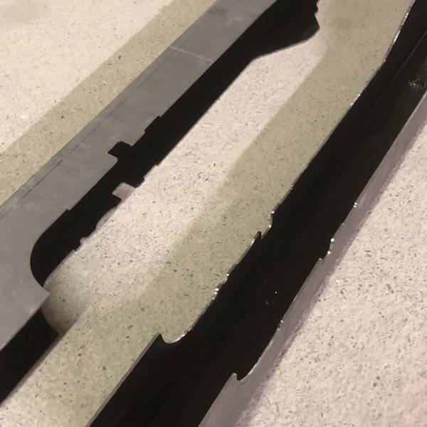

Here is some of the prep work coating the inside with POR15
1A6B8A0B-601F-4EB3-861A-A9C03B921349.jpeg 1E805613-27FF-4489-BABA-651144A4D1F3.jpeg 78B75A3C-F3D9-41A7-AF2E-C8683D261F9C.jpeg

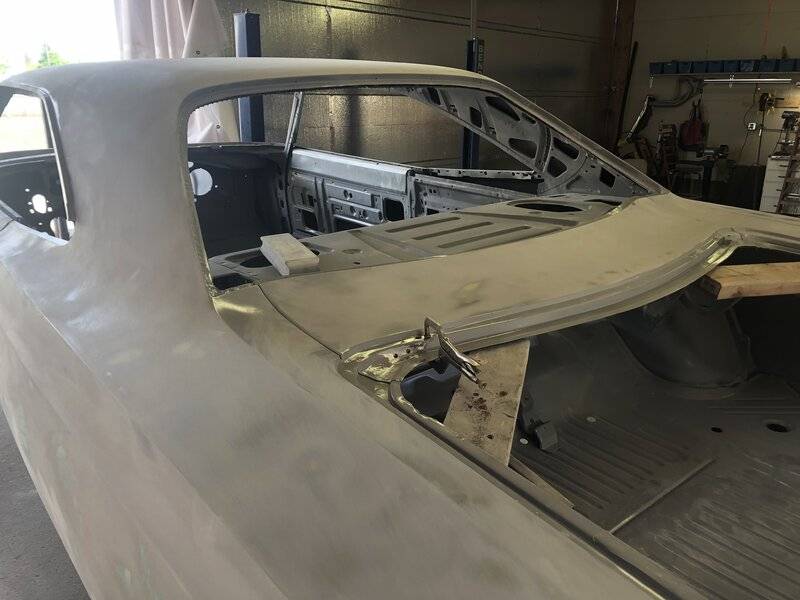

Also etch primed the area under the rails before putting them in place. Taking steps to preserve the car a bit better then the factory did.
D875E9FB-6FA1-4429-832C-1889A86A4A45.jpeg 5B08B1A6-AB32-4ED5-8A02-9FE169ED9D8D.jpeg

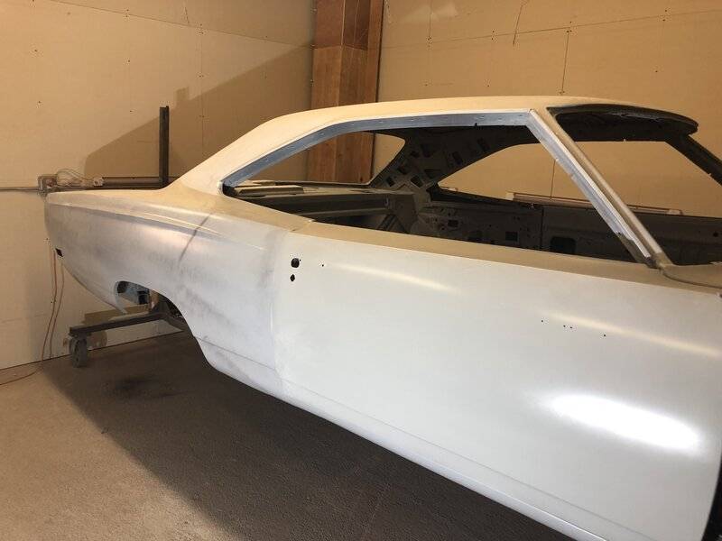

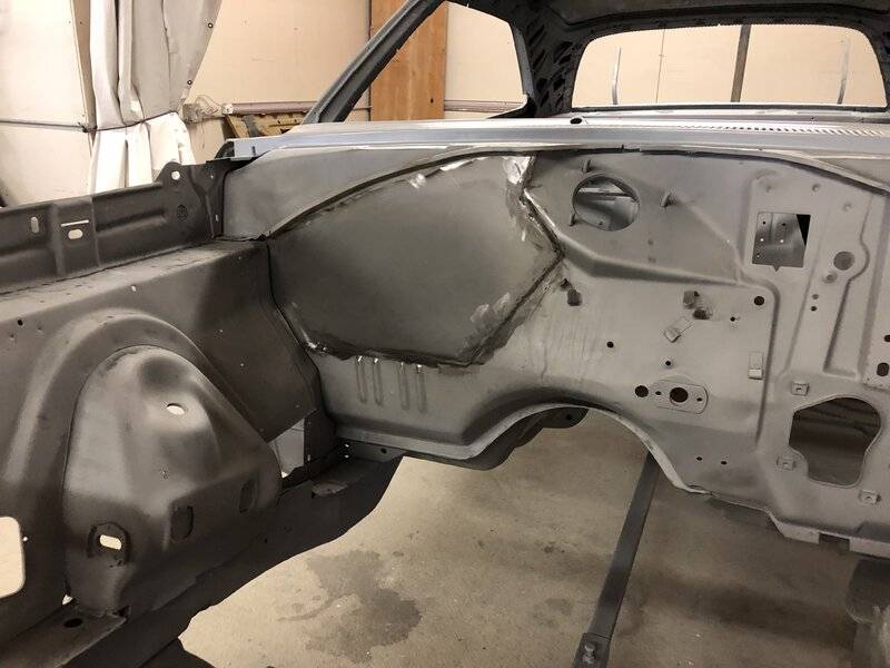

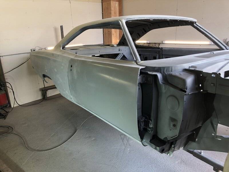

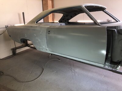

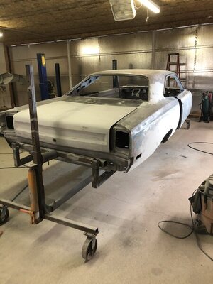

With the extra time staying in I am making the best of it. All welded in. Still need to fit the torque boxes another day.
D33EA8A1-9F9D-464A-B98B-613C06F60371.jpeg E3A4C5F9-D457-4134-92F3-E9FDDBD22914.jpeg

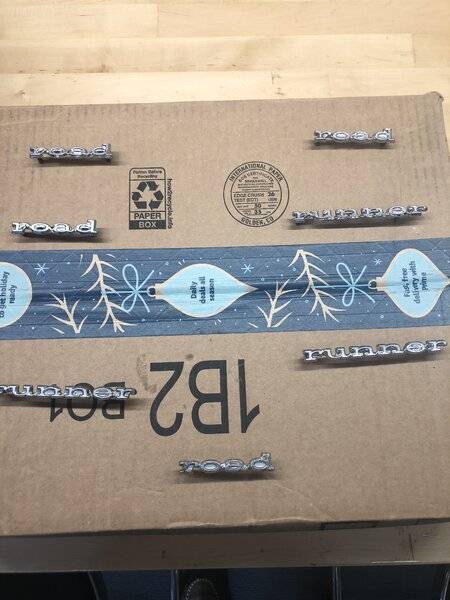

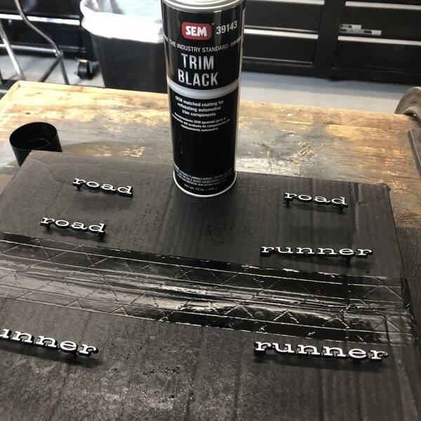

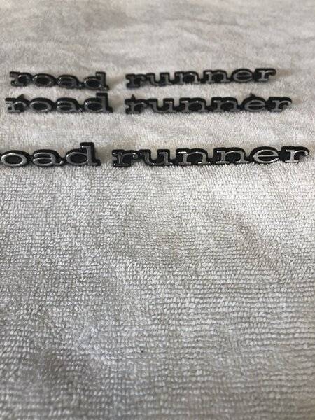

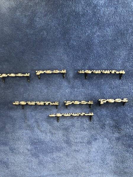

Took a break from bodywork and did a little emblem detail pretty good for 51-year-old emblems
Started by soaking them in the lacquer thinner to remove all the old black paint. Had to use a brass brush to clean in all the cracks and grooves.
1DE88FC4-67E8-4280-B819-EC321C13309B.jpeg A23D3F2D-C1C7-4352-AF58-5D8EF38B6B61.jpeg 895EEC85-4810-475B-8DF5-6319F6C3CE92.jpeg D75EE997-5117-4756-A104-23B591355C0A.jpeg 802808F2-2899-4429-8C79-D144E3BD270A.jpeg

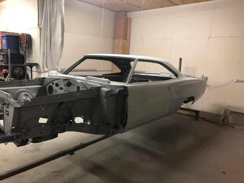

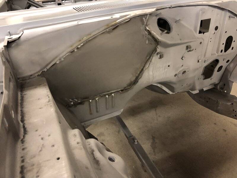

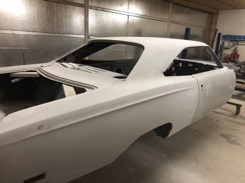

A little more progress. I will be using Vintage Air rather than the bulky stock system. Cleaning the fire wall up as the new Vintage Air routes the hoses in the upper part of the fender.
FD25493D-1081-463B-AD4E-222AFA7FB78A.jpeg E6CFC7FA-543D-4A52-A3A9-CD9D75C5FC9B.jpeg
Lower core support was all mangled Typical of a 50+ Year old car.
Used a US car tool replacement. Nice part and much stiffer.
2F02B538-EB4C-4CC2-A7E4-2A2FAC46E228.jpeg 77BCB95E-2042-4ECD-94EF-54DCA10D2C1B.jpeg

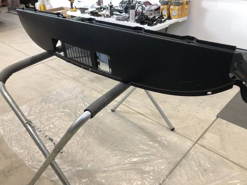

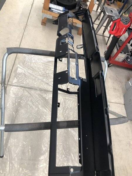

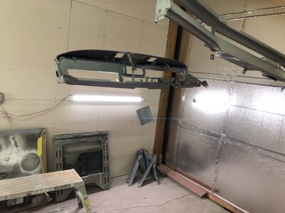

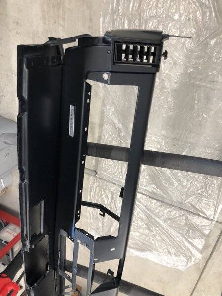

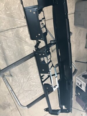

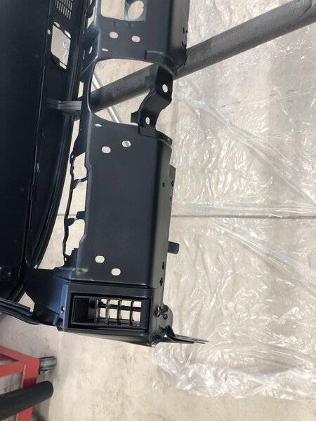

Here are some photos of the dash restoration
Starting with stripping it down to blast and paint
BE6EA2F8-5093-42CD-9B12-59B54B83F741.jpeg BE0D33B8-786F-4E64-BA11-D0936BDF8B44.jpeg

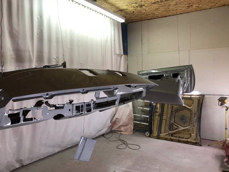

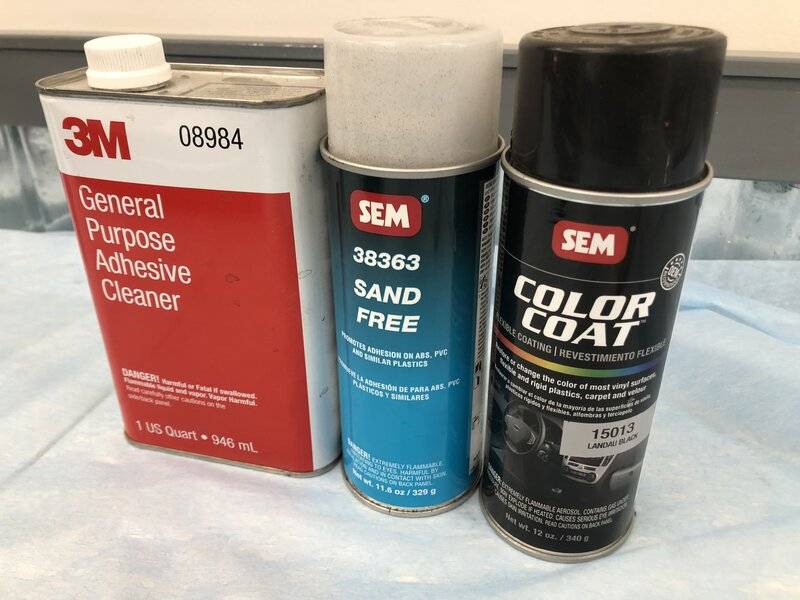

Spraying it with a non-glare semi gloss black from Sems. It replicates the original finish very well
75A0CCE4-1D5F-4A43-B9DF-E00C3DE797F5.jpeg 5F504C49-6590-439F-B867-ED1A07F985F2.jpeg 625830D8-F443-4A38-A539-0A2F4BC501F9.jpeg

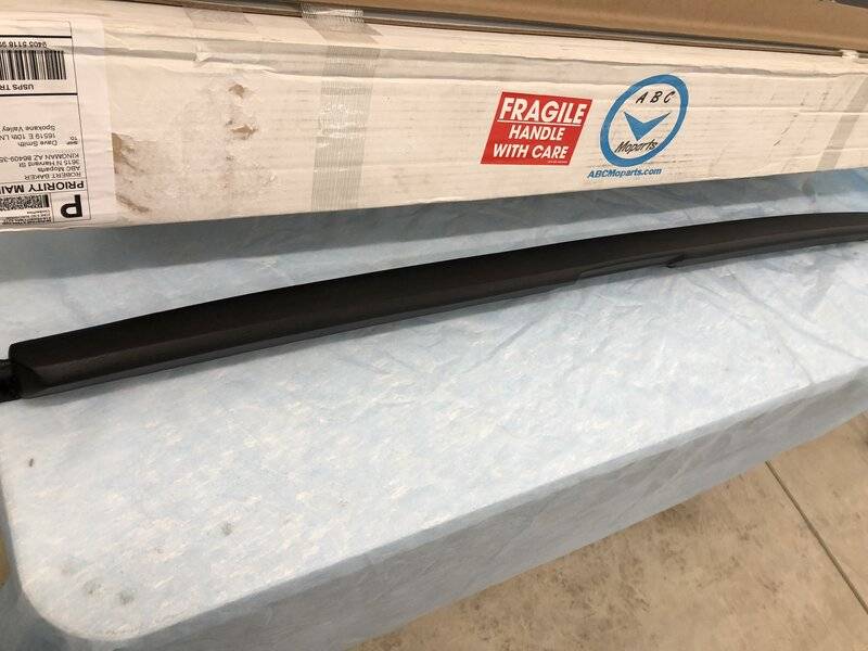

Ordered new steel core dash pad very nice product grain is very similar but not exact. Highly recommend ABC
AE253BC4-AC22-4CDF-9985-02A735EA6DC7.jpeg 96052AC3-AFA9-4D18-91B5-DD08A0FECA7D.jpeg E7D72265-8906-4A17-92A8-45585DDDFC12.jpeg

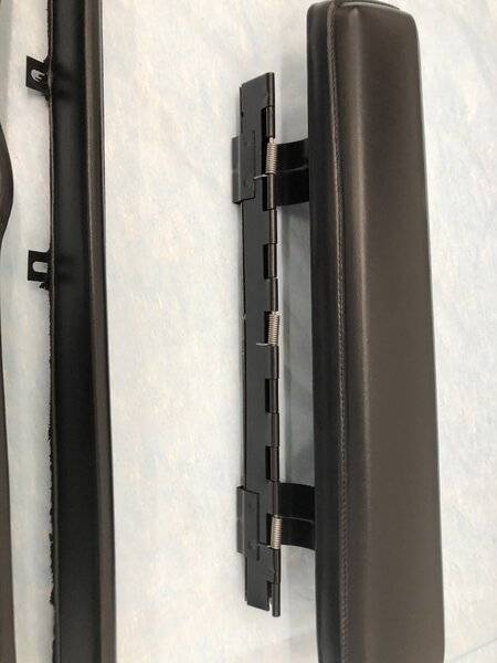

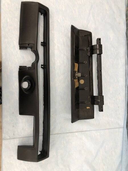

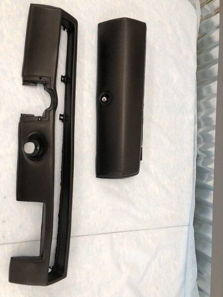

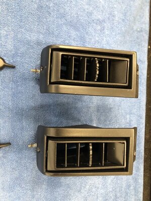

Cleaned and detailed lower dash pad and glove box lid
Used SEMS product. I highly recommend it
699724F5-23FA-4768-ACDE-8771A650A2A7.jpeg EDB9BFC1-6C97-49AC-B28F-8AFF810B0FC9.jpeg CA0ED3E6-BACC-4860-89D8-ABEF85CC234D.jpeg D8AF1977-D5C0-40DA-A88F-EE94BF5EA6C0.jpeg
