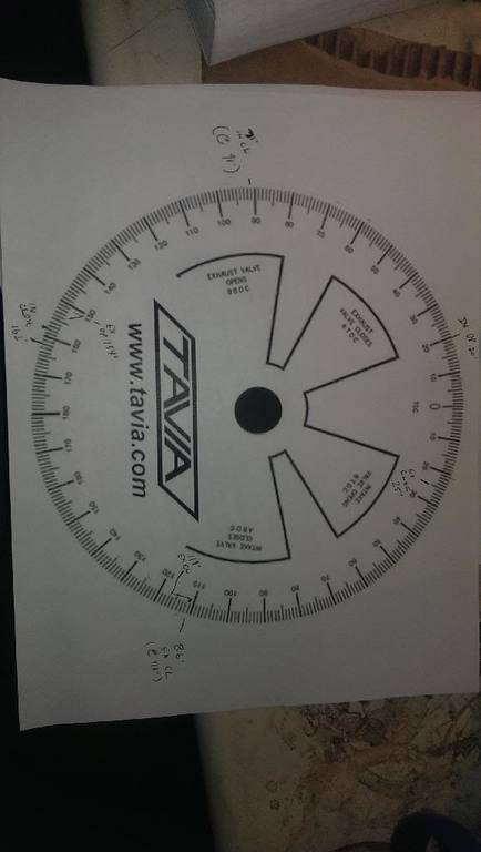

Ok, took me a while because I had to fab up all the equipment to Get this done but here are the numbers. Bear with me, this is my first time degreeing a cam. But I made sure to triple check all numbers. Tdc was measured via piston stop.
Intake opens 20* atdc closes 162* bbdc
Exhaust opens 154* bbdc and closes 25* btdc
Intake duration 142*, exhaust 173*
Intake centerline at 91* atdc, exhaust 111* btdc
Lsa is 158* with 8* overlap
I'm not sure what the factory shaft mounts ratio is but I measured lift at .213 intake and .215 exhaust.
So here's a sketch of my valves. Sorry for the chicken scratch, maybe you guys can help me decipher this. It's OBVIOUS that the cam is off, if the stocker opened up intake 21* btdc and I'm 41* behind that power curve. Stock cam has 38-46* of overlap compared to ny 8?
