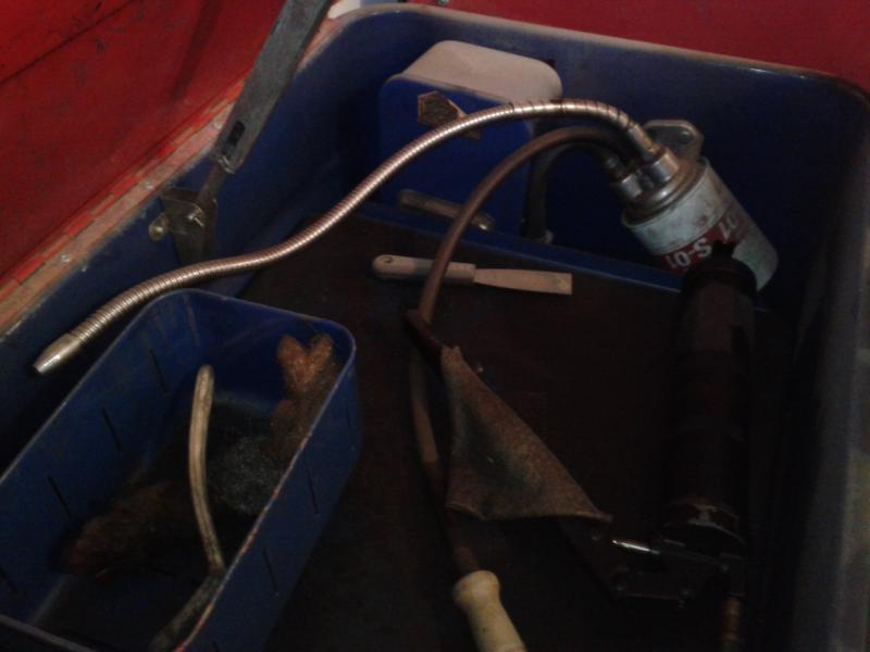

I also plumbed mine with an oil filter after the pump. Works like a champ.
That's what I need to do;nice setup.
X2-or more-on the mineral spirits. Satman,a bit of advice: if you don't already have a drain installed,DO IT! I need to clean my tank and get fresh fluid;wish my dumb *** had installed a drain PRIOR to dumping in the fluid. Live and learn...
