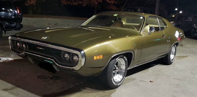

Posting here for the first time because I may have an opportunity to buy a 71 Satellite next spring. I’ve known the car since 1977. The original owner was my neighbor, a real little old lady car. Driven rarely with only 30k miles. She became ill and gave the car to her mechanic a couple years ago. He died soon after and the widow may be ready to sell. My question to all of you is what’s the market like for this? I’m not a mopar guy. I own a 71 Mach 1 and my dads 64 corvette. What’s a good offer?
1971 Satellite. 318. Auto. Tawny Gold. 30k ish miles. Pretty much 1 owner. The mechanic added a 4 barrel carb, new wheels, duel exhaust and I think he put on front disk brakes.
That looks like it is a Satellite Sebring (Sebring Plus?), not just a Satellite.
I have no educated cost guesses for such a low mileage example.
Do you have a picture of the fender tag? It will be on the driver's fender under the hood. It contains the options/sales codes, as well as the VIN.
Members here can help decipher the codes.

Might have rust. I did see her drive in the winter. Maybe a mile to the store. Not often. The picture is from last year.

Probably bucket seats with column shift and rallye dash. If the whole body and paint is as nice as that photo makes it appear you could not restore to that condition for $20-30k...
Imo $15-20k is a buy immediately if it is that nice

Condition of the body and paint will be huge factors for value
If its as nice overall as the one picture shows, I could see it pull $30k to the right buyer
