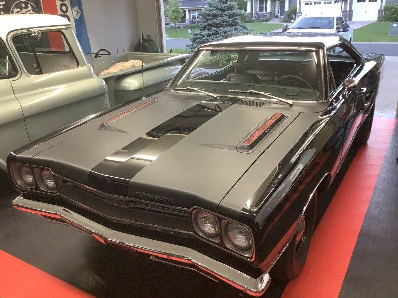

The '69 Road Runner stripes were done with Organisol. I couldn't tell you if or where it was used on other years or models. The A12 cars got a semi-gloss or satin finish - most likely the hoods came from the supplier that way. As much as I like the organisol, its a bitch to keep clean.

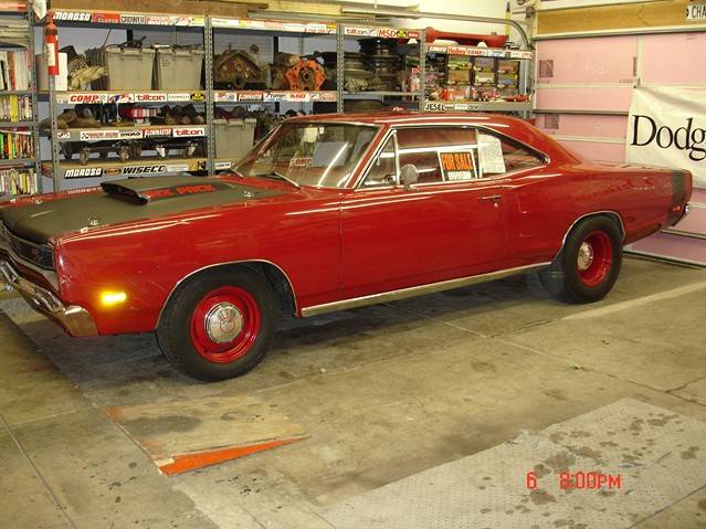

I had read somewhere it even varied from plant to plant. I think I read that the St. Louis switch to flat black for RR/GTX stripes. Wish I knew where I read that.
When I bought my '69 RR in '73 the stripes looked to be more "flat" than anything else. And I knew nothing about "organisol" back then. At some point I made a 'glass mold from that hood and it took very little effort to prep the surface so that pretty much confirms that my stripes were flat or very close to it.

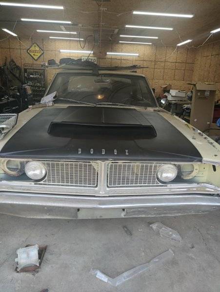

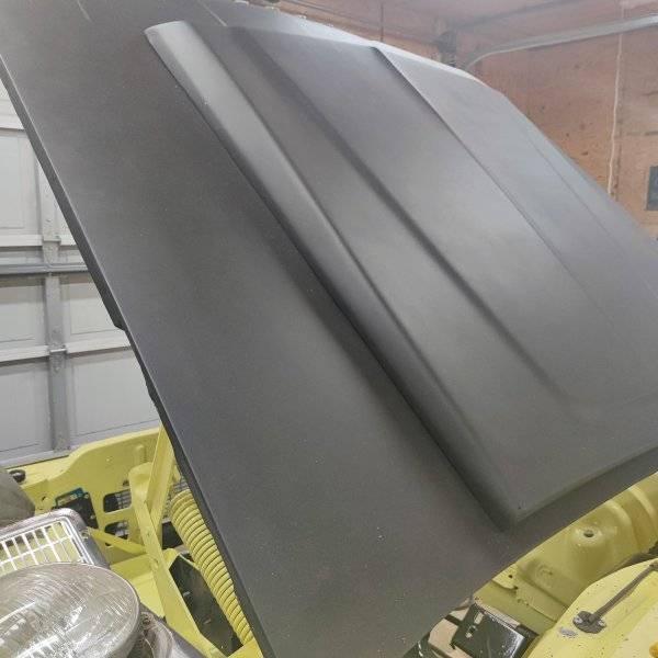

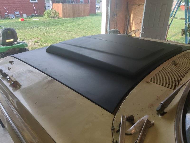

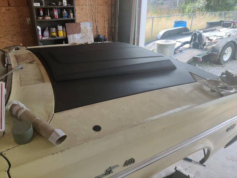

I was wondering if someone could help out. I ordered some paint from 8774paint1.com
I ordered 1/2 gallon of the Organisol SEM 61993 and painted the hood and scoop on my 1966 Coronet.
I mixed the paint exactly like I was told and the paint laid down and covered quite well but the texture is a little rough.
It feels like 1000-grit sandpaper. It was supposed to be a single-stage paint no clear needed but I don't like the texture.
Is this paint supposed to be a little rough or is it supposed to be smooth? It's almost like it dry sprayed. I have painted several cars , motorcycles, and boats and never had a problem like this before. The entire hood is uniform in texture. What recommendations do you have and is there a way to salvage this paint?
Any suggestions is greatly appreciated.
Thanks, JKent
