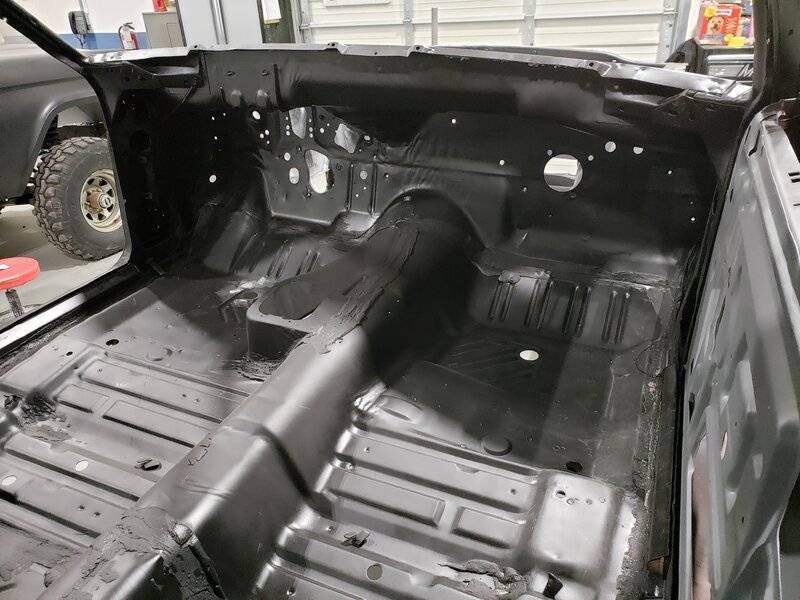

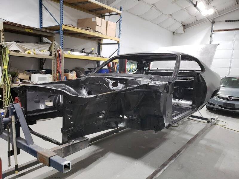

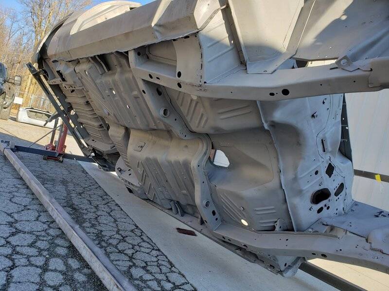

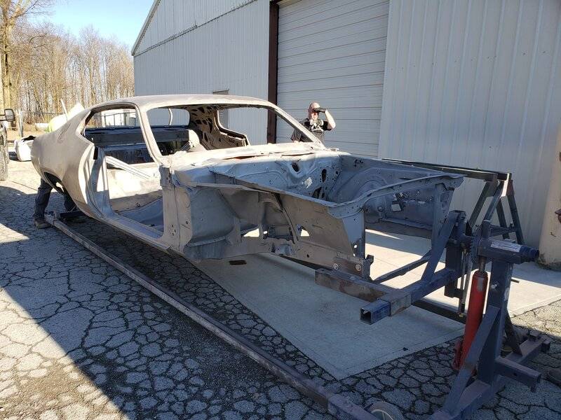

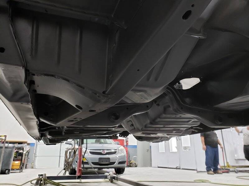

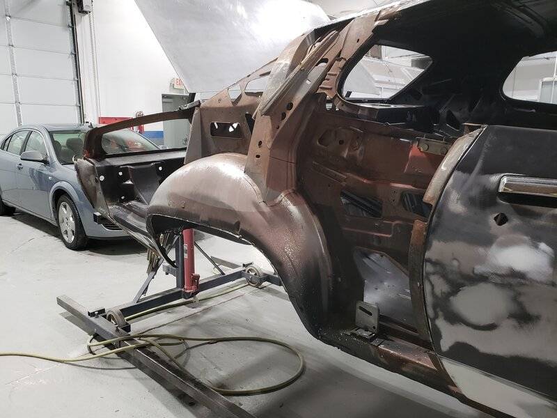

My 72 RR GTX is fully disassembled to deal with all it's rust and multiple paint and body work touch ups. I had it fully media blasted.
I'd like to change the color but I think the value is going back to original hemi orange as it is a # matching track pack car.
The question is about covering the floor and underside. The shop I'm working with has some skilled people but not Mopar guys. I personally own a Jeep CJ business and my Jeeps from the factory all look right with everything body color....wheel wells, floors, firewall, underside.
Mopar seems the same way....body color everywhere. I am not about spraying undercoating for the ultimate original resto. I want it to hold up and look sort of original...ish.
My floors are original but slight pitting underneath. My painter has concerns the pitting will stand out too much with orange paint underneath. I have gone through so much work and money to get here that I feel black for the chassis is a cop out and it will look like a used car dealer touch up job and not a full rotisserie build.
I have pics attached. I was thinking single stage orange for the inside floor and color match pro sprayed bed liner (like Linex or Rhino) for the underside, aprons and rear wheel wells.

I epoxy primed mine then skim coated it with glaze to fill in the pits and sanded smooth then final coat of epoxy and then paint. It does not take a lot of time since you are not looking for a mirror finish. A DA with 220 gets most of it smooth.
Thanks...I was thinking that. It isn't terrible underneath. Some areas slick new-like metal. Other areas...ehhh.
A high end restoration/show car will use filler in the trunk and on the underside to make it as smooth and flat as the exterior so it is nothing out of the ordinary.
I added a gray toner to my Raptor bedliner to blend with the silver paint. I shot the bedliner and had very little overspray. Of course I will not be selling my 65 any time soon.
Mike
seal it all up with epoxy primer and let the overspray fly from painting the exterior......after dents and pits are repaired of course

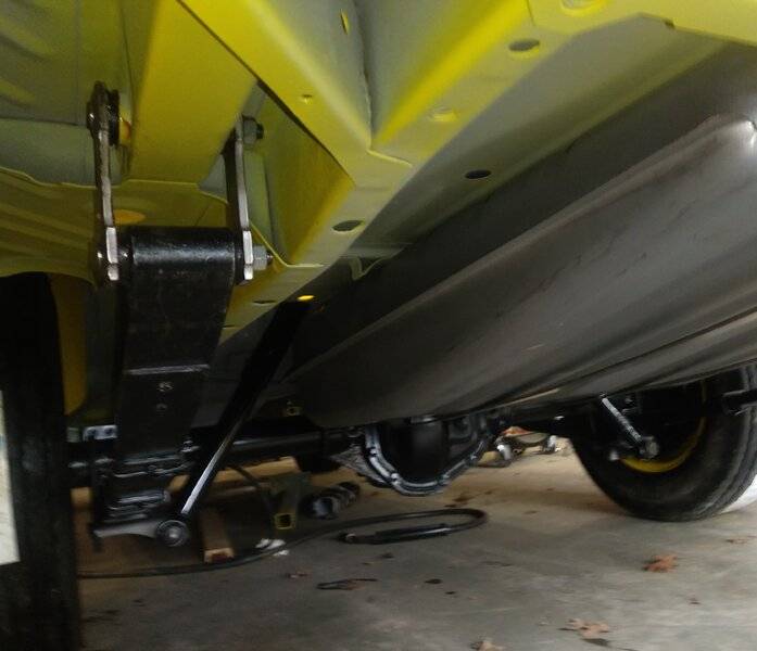

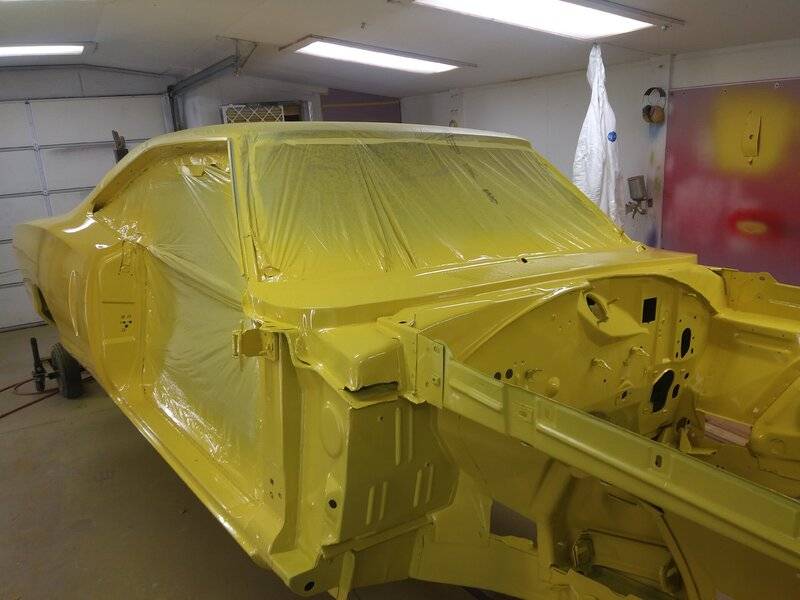

I actually made an effort to get a little more coverage on the rear wheel wells behind the tires, but not much
up front where the suspension bolts, I also got better coverage but not 100% (i was already painting the hood compartment and hinge pillars) this yellow is very transparent; if you look closely, you can see where it is darker as the primer shows through a bit
back sides of fenders and front bumper filler got the epoxy/overspray to mimic the bottom
the car is covered for the next few days, but i will post up some extra pics for you....... as a whole, I think the underside view is pretty sharp
to take it a step further, I suppose 2 coats of a semi/matt clear would go very far in protecting the look....... I may do that to the next one..... everything is already over budget on this one and it was not my call

you can add some paintable gravel guard it those areas...... i would sandwich it between 2 layers of epoxy before paint........ as for the muffler heat, you can probably come up with some sort of protection in those areas........ that being said, the paint may burn a little, but the epoxy wont........ we are always faced with the "where to draw the line" question
once you undercoat, you are stuck with it......personally, I would hold off on that
they also make clear aerosol chip guard...... yet another option for the vulnerable areas
here ya go....... I'm thinking with a little clear chip guard in strategic areas, and a couple coats of matt clear; you'd be able to maintain it and wipe it clean whenever you want
