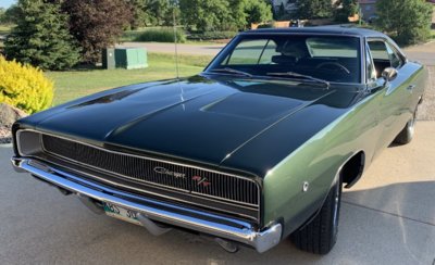

You are in Canada I see...go to Canadian tire...get the Meaguirs clay bar. Use their fast wax product as a lubricant. Comes with the bar in the package. Clay bar the areas. Clear coat i am assuming...Then use the Meaguirs polish compound. Just by hand. Dont let the polish dry. Very very small sections. Like no bigger than 2’ x 2’ at most to keep the polish wet. When the polish begins to wipe off easy and the surface is smooth like glass it should be gone. It took up to 5 applications of polish in each area. I had the exact issue on a 68 charger I bought. Then wax. Paint is now gleaming.
A photo after all the overspray removed. A lot of work but worth it.
