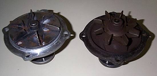

Also the 8 small impeller water pump is for the small pulley AC cars and the 6 large impeller water pump is for large pulley non-AC cars. Here is a pic of the two.
Non-AC on the left AC on the right
The AC pump caused crazy temperature readings from the water cavitation in the pump housing.

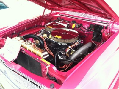

For a little extra bling...
Do what this guy did....
Exposed the brass of the factory rad and chromed the brackets..
The pic is a little over exposed, but you get the idea.

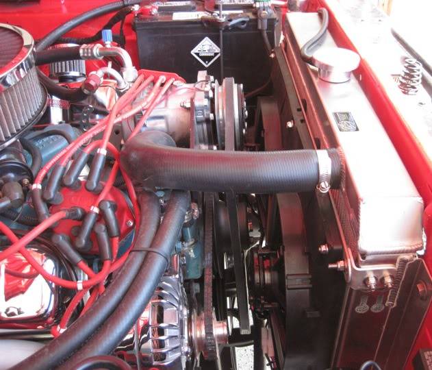

I know its hard to see in the pictures but the shroud that hold the electric fans in my setup have rubber flaps that stay closed when you are driving slow or at a stand still pulling air from the shroud through the fans for max air flow. When the car is at speed the rubber flaps open up allowing air through the radiator and past the shroud so the shroud and fans to not block or restrict air flow.
This radiator and fan configuration is 3500 cfm is rated for a motor up to 700hp
Another note: My car has a radiator shield that sits between the bumper and the radiator support and serves two functions.
1. Keeps road debris from bouncing up and hitting the radiator
2. Controls the flow of air through the grill to the radiator preventing air flow from escaping out the bottom. Of course this will not be a issue if your using electric pullers.
Last note:Since my car has AC it has two radiators to draw air through instead of just one which adds to the amount of air that must be drawn to keep the engine cool.
