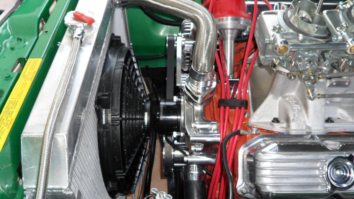

I read in a recent post that your mopars are running in the 180 to 200 degree range. My car is running hotter than that and I don't like it. :mad: :mad: :mad:
I have recently installed a three core radiator, a 2100 cfm electric fan and a Mezeire 100 series electric water pump. It is now running close to the boiling point! A lot hotter than I want. What have I done wrong, what do I need to do or change.
Please help any advice will be greatly appreciated!!!

Thanks for the input, but as you can see, I have only an inch or so between the fan and the water pump. I purchased a shroud to go with the fan, but it moved the fan back too far. i even looked into a low profile fan, but still not enough room. The fan is a puller style. The theroswitch for the fan is on at 185 and off at 170 and I have a manual over ride switch to turn the fan on early if needed. Still overheats. I had a Milidon high volume 160 degree thermostat in, but took it out as it heats up quickly.
The radiator is a Champion Radiator that good decent reviews. Any thoughts on this or other suggestions??? Should I start searching for an ultra low profile fan/shroud combo???

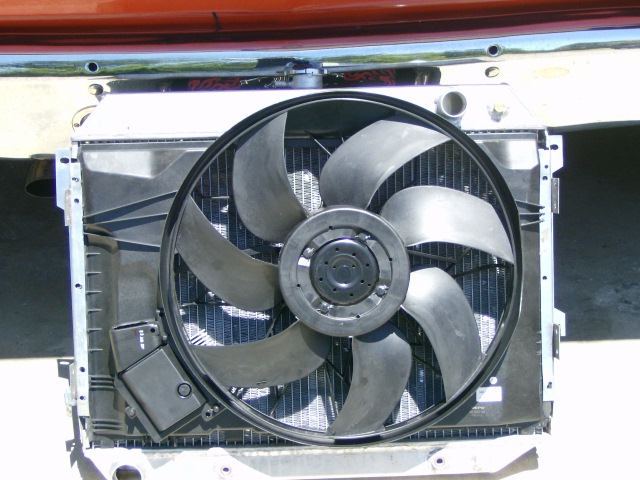

I see at Summit Racing they have dual fan/shroud combo kits that would decrease the depth directly in front of the water pump. Any thoughts on this working???
How many cfm is that set up? That looks like a very good set up,it will give you the extra clearance for your water pump and pull air through the entire rad surface

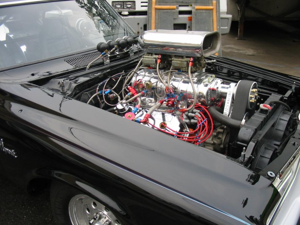

Your photo is basically a "poster child" for overheating culprits. In no particular order I will address them.
1. Aluminum does not conduct heat as well as Brass, so your Aluminum radiator will not be as efficient as a stock 3 row. --- This would not be a problem if everything else was designed to work with it, but it's not.
2. Without a factory (any brands factory) designed shroud, you will almost certainly overheat, as the manufacturers spent Millions to design an efficient fan/shroud/pump volume-speed setup. --- The mid thread photo of a "suggested" dual fan/ flat aftermarket shroud will only contribute to your problems, as they act as an air dam as speed increases.
3. You have an electric water pump. They will flow about what a stocker will at low RPM; but can't flow enough to keep a performance big block cool at anything but idle (that’s if you had an effective fan/shroud set-up), They are generally sold as race set-ups, and really aren't any good for even that.
4. You have a non-vacuum advance distributor. These can work fine if the engine/car is designed for them, but if I remember correctly, you said it was set up for 12 degrees initial. That would work for idle (if everything else was set up for that), but will be extremely retarded at anything over completely stopped with no throttle opening. --- Retarded timing will contribute substantially to overheating (as well as poor performance) even with a workable fan/radiator/shroud/water pump situation.
5+. Even if you had a workable system, the radiator is not sealed to the support, Your "rated" fan CFM is marginal at best, and probably only half that, It appears as though you are using either a chromed, or polished stock alternator, which simply can't produce enough power to run a good fan, Those "lever-vent" radiator caps are not a good choice due to there variances in "actual" pressure, and basic inability to retrieve coolant from the overflow tank.
6. Unless you are running a coolant that has a high silicone content, and you have made certain that you have no residual voltage grounding through the aluminum radiator, your cooling will very quickly degrade in as little as a matter of months, and your aluminum radiator will be useful only as a paperweight.
I can't offer you any solutions unless you are willing to start from scratch, and sell off 90% of the stuff pictured in your photo.
You can change to the stock system, which will be an improvement, but you can produce stellar improvements over stock (just like changing to disk brakes from drums), if you are willing to change over your alternator in order to run it.
Lastly, I only point all this out as a guy that was born, raised, and (for decades) live in the desert, so I had to learn what makes a cooling system work, with A/C, in as high as 126 degree temperatures, while maintaining as much performance as possible.
Your environment is infinitely more forgiving than mine, so you can solve all your cooling problems by simply going back to basics, and improve upon them if you want, but like I said in the beginning of this post, your current system is not functional as it stands.
