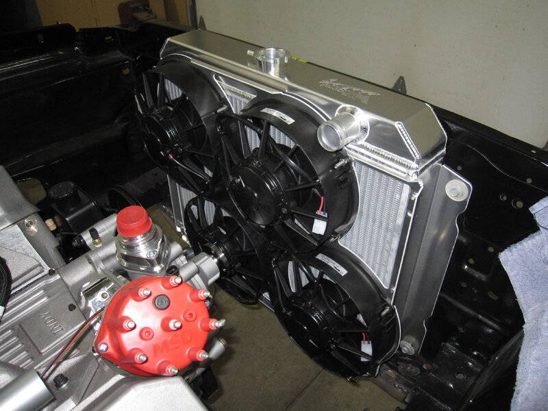

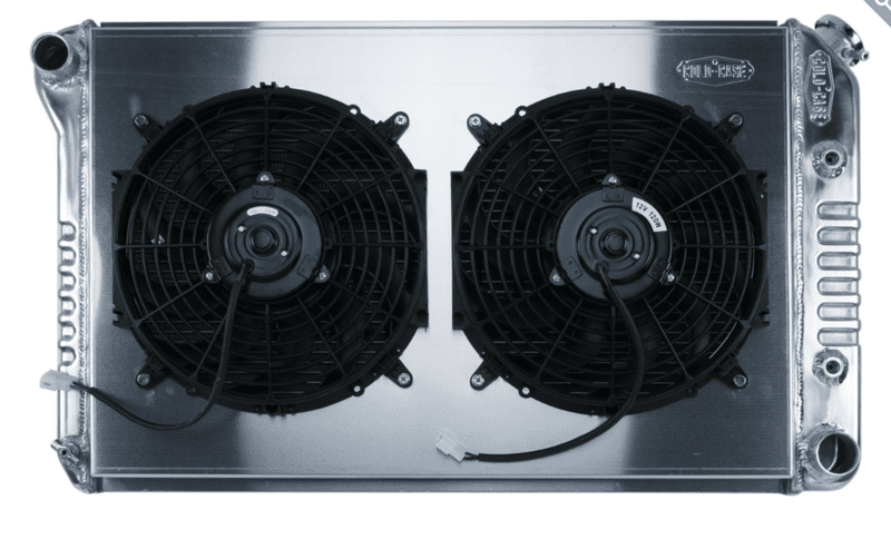

Does your setup look comparable to this one?

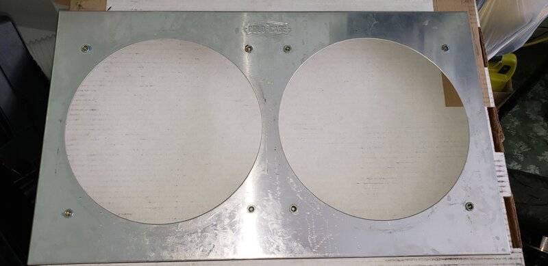

The 1st fan setup I got from Cold Case, the radiator manufacturer, was a dual 12" fans and aluminum shroud assembly, but the cutout openings for the fans made up a much larger area that the one pictured.
Here is the dual 12" shroud:

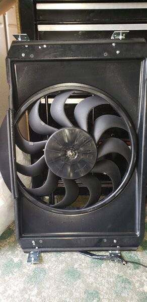

Here's the 16" two speed single fan shroud, 4.9 out of 5 stars, 70+ reviews, and my vendor SWEARS by them:
The reason why they are off the car is because the dual fans are going back regardless, I already have a RMA for the return and I have my doubts as to the quality of the fans themselves. (I still can't believe they'd sell a product that doesn't work though). The 16" fan is off because I just put the factory mechanical clutch fan back on, the factory shroud will NOT fit because the CVF Wraptor serpentine belt and accessories system pushed everything too far forward making the shroud enclose too much of the fan for effective cooling. I'm about to refill the cooling system again, drive it on the highway, and if it doesn't overheat, I'm going to carve up the factory shroud to make it work with the mechanical clutch fan, and tear my vendor a new *** if I can't get a full refund on the 16" fan.

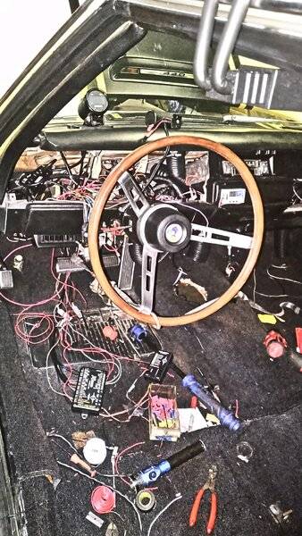

The assho...I mean mechanic who did this work is coming by tomorrow to address some other issues, like the Dakota Digital dash light dimming or going out (it's bright daylight so I can't tell which is happening, but neither should) and explain to me how the AC levers are supposed to work. Right now, with both levers to the left (temp and choice of vents) I turn the fan on and the AC comes on. I need a refresher on what the damn horizontal levers do. I assume one changes the temperature, but I'd like to know if the other one makes the defroster work. Also, the AC compressor stays on with the temperature set to warm, and if the other lever is moved to "Heater" or whatever (my brain is mush) the damn AC compressor should NOT engage.
I hate having someone work on our cars, but at least the guy doing my Roadrunner is knowledgeable and trustworthy, and he is labeling the wires he's connecting to the Dakota Digital block and other stuff in my car so if I have to do something I know what is what. It's a good thing too, because OMG:

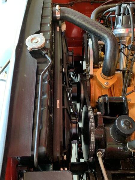

I bought this 22" for my 65 Belvedere from Wizard. I told them the horse power and they designed a system to cool. I hope it works! Might have the car assembled next summer.
Mike
Vs the picture I posted earlier - your box shroud, even for the 2 larger fans, is still blocking a lot of air, and the single 16" is even worse.
If the shrouds were deeper and funnel-shaped toward the fans it would help, but as-is there's gonna be a lot of trapped air in those corners.
The hub on that 16" fan is pretty huge, too.
All that will start to back up airflow out front of the radiator, esp if you are missing any factory seals that help cover gaps and force air thru teh radiator core.
Those will surely get high-star ratings from lower-HP guys that are running hot at idle, but IMO those shrouds are part of your problem. The one 493Mike showed is a better idea - each fan is shrouded individually to improve its performance, without blocking core airflow. A fan array actually needs to be shrouded like that, individually, to keep stress and noise down as the neighboring fan tips head toward each other. Each fan must be 'fenced in' and isolated from its neighbors.

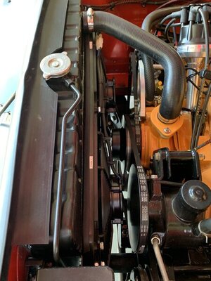

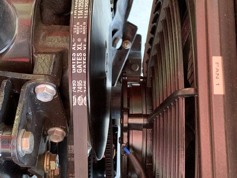

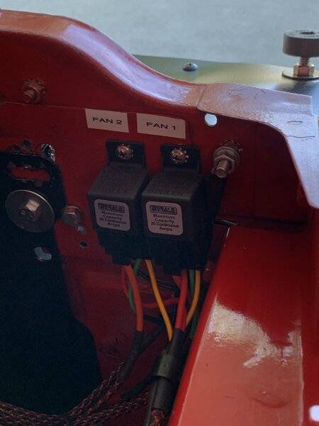

Bio, I recently replaced my Mopar 18" 7 blade fan and matching factory shroud with a dual electric fan/shroud set-up from Summit; https://www.summitracing.com/parts/sum-g4850. I have a Flow Kooler pump, a 190* Stant thermostat and a Griffin 26" radiator with 2 - 1.25" rows of tubes. I use 2 - 30 amp relays. 1 fan is wired to a 190* sender and the other fan is started by my Fitech EFI control, which is set at 200*.
Our temperatures here in Northern California have been hotter than normal this year; we have had 3 week stretches over 100* (up to 112*) and I drive my car a lot. I've found that both the mechanical fan and the electric fan set-ups work equally well for me. The car runs at 190-195* while driving. At idle, such as a long signal, it will increase to 205-210*.
I am very happy with the electric fans. I tried the Derale set-up, but, like your car, there wasn't enough room for the depth of the unit. Hope you get your car figured out so you can attend your event...
