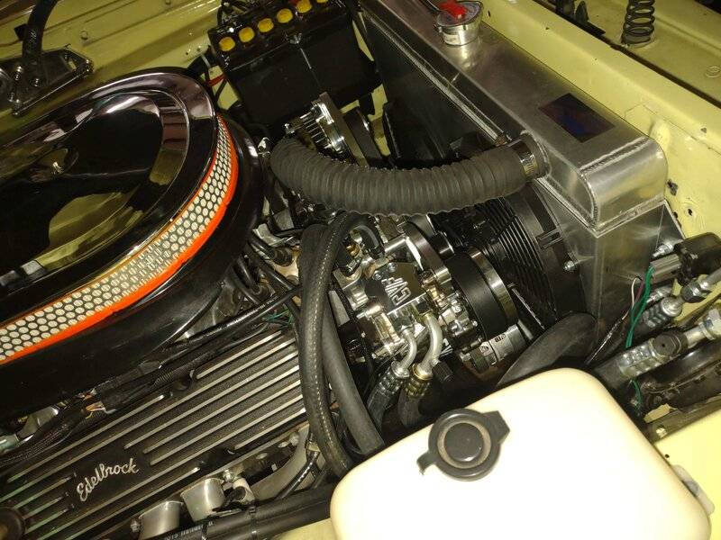

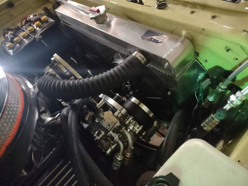

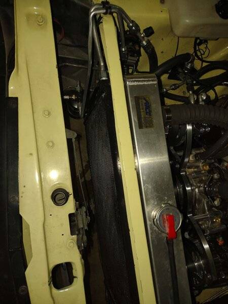

Here are pictures of radiator, a/c and fans.

Can't tell them the pictures but are the fans mounted directly to the radiator or to a shroud coving the whole back of the radiator? If so, is there holes with rubber covers cut into the shroud to allow air to go through at highway speeds, if not the air flow can dead-head and the shroud could work against you. If your shroud doesn't have the cut-out it would be easy enough to modify. Looks like a mechanical fan is a no- go due to the Wraptor serpentine set ( nice,btw). The Wraptor set up comes with a good pump so i would doubt that is the problem. The shroud cut-outs only come into play if it's getting hot while at speed.
Good point, Dan. One thing I’ve learned over the years is that most electric fans block more air than a mechanical at highway speed and most actually move about half the air they’re rated for. Also, check voltage at the fan and make sure the electrical circuits supplying them will carry the amperage needed to run them. I run the same serpentine setup you do and made sure to include a mechanical clutch fan just to avoid the headaches of electric fans.
