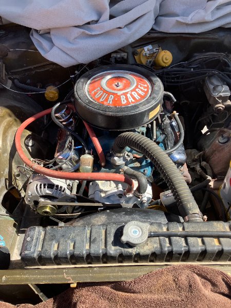

The new water pump on the recently rebuilt 340 does not leak while running. However, when I turn the motor over by hand with a breaker bar (clockwise mostly but at times a few degrees counter-clockwise) it leaks a significant amount. Weird.

Update: Added a pint or so coolant and took the vehicle out for its first real "road trip". A 90 mile romp from La Paz, Mexico to the outskirts of Todos Santos, Mexico (La Garita Restaurante). I ate a bowl of menudo (tripe) for brunch. The rebuilt 340 ran great on the freeway (2.71 ratio sure-grip), cruising at 2,500 rpm @ about 15.1 A/F ratio according to the AEM meter (closer to 14.0 A/F at idle). Did not notice any pinging along the way and the water pump did not leak any (like i stated in post #1, only leaks when motor off and turn the crankshaft by hand).
