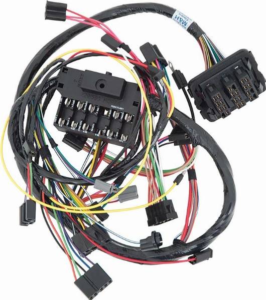

This is an example of the M&H. Looks OE correct. I guess this depends on how you want your car to look. In all 5 harnesses. One under dash, one head light, one engine the wiper harness and one tail light harness.

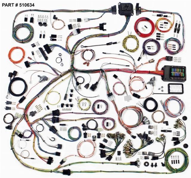

Yes the Painless does look different. The good thing about it is the Coronet will be totally all apart ..Just painted:)
Well the 71 example has a different bulkhead all together. 71 they are weird. So probably not the best painless example to use.
Here is a M&H harness with the correct bulkehead for 70 back. In 71 they changed.

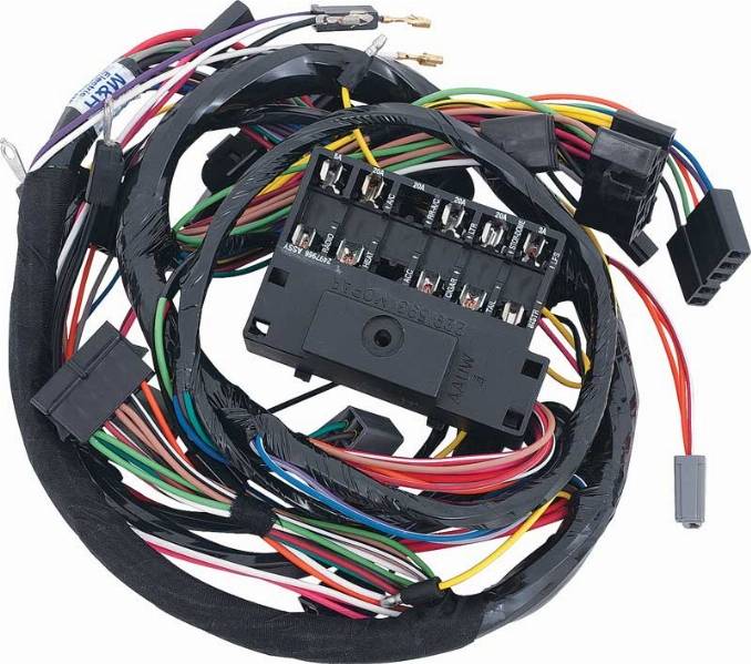

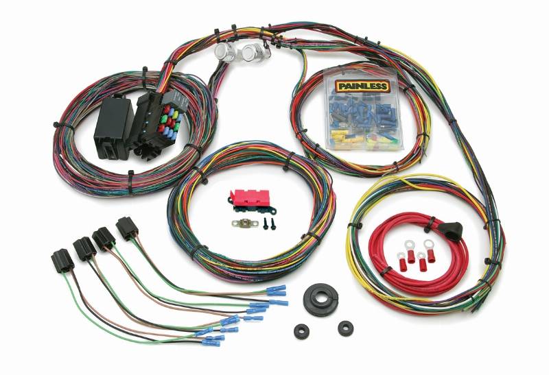

This is what painless has for a 1968 Coronet. No bulkhead and looks like the cheap ones you can buy from speedway for 100.00
I installed a speedway harness on my friends 1971 satellite. He ended up buying all of the M&H harness's because everything in the car worked. It took me 2 weeks to make the speedway harness work on that car. Just to turn around and rip it all out and go with M&H stuff took a day to install all of it.

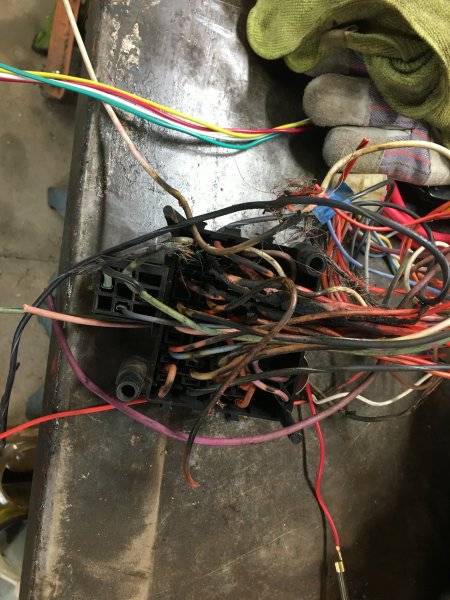

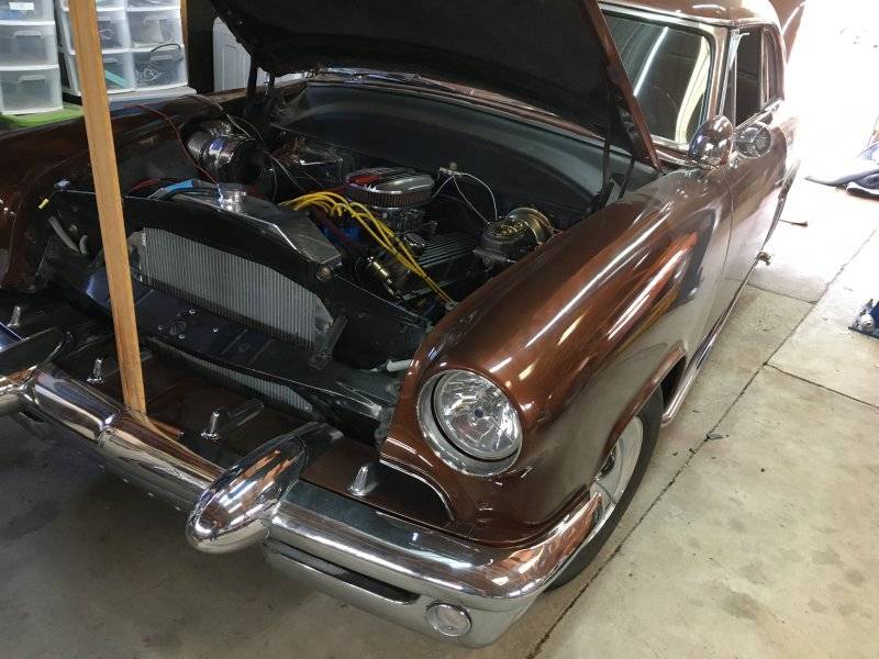

Doing a painintheass harness now on my buddy's 52 Merc after he hooked up an Amp gauge the wrong way. At least the instruction book has come a long way. Did one on a 67 GTO a while back with Vintage air, Big Stereo ect. Go M&H

I used a painless on my 66 Belvedere. There are no bulkhead connectors. They provide a bulkhead plate with a grommet. The original bulkhead connectors are notorious for corrosion. On the other hand, the M&H harness is plug and play and will be truly painless.
