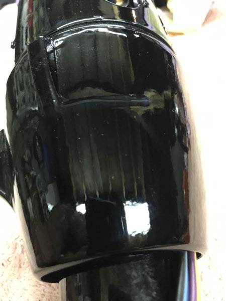

How Do I Go About Removing This Paint Run From My Steering Column. Not sure The Type Of Paint...
Thank You
On a concave or curved surface you have to be extra careful. take a inch or so of a paint stick and wrap with some 2000 wet or dry, use water, go slow, follow the sag backwards.
then rub out with some 3000 compound.
If that little warning light in your brain starts flashing while your sanding. Stop
That's exactly what I did for a run I got on my fender.
Worked great.
Don't go around the curve- sand straight until that part of the run is even with the rest of the surface.
Good lighting and viewing angle helps.
